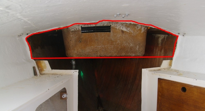

Michael, does the half bulkhead cover the area like this?
Approx area I think Michael's half bulkhead covers.

Troppo, yep, that's about what I was trying to describe.
I also put the iPad up ther to watch movies when we go to bed.
Love the cardboard. I doubt this was standard equipment though........
