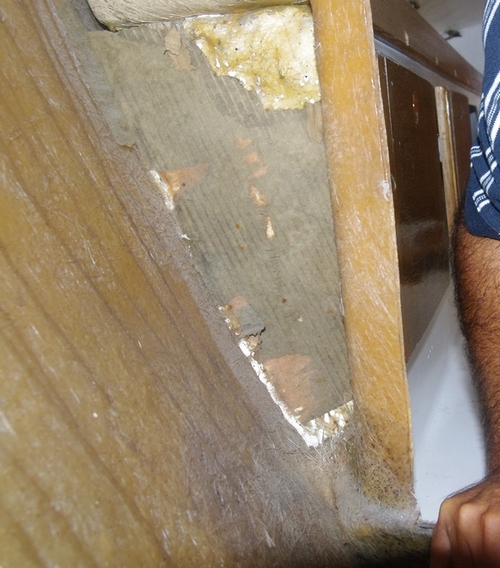

Postby Troppo » Mon May 28, 2012 12:57 pm
See the cardboard? This pic is behind the old bulkhead showing how the end of the storage cupboard was finished off. Is that original TH construction cardboard or what?
Re: V-berth makeover Part I
Postby Miker » Mon May 28, 2012 2:19 pm
Troppo, yep, that's about what I was trying to describe.
I also put the iPad up ther to watch movies when we go to bed.
Love the cardboard. I doubt this was standard equipment though........
