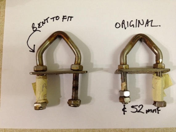

Postby rob.lovelace » Thu May 10, 2012 5:40 pm
the U bolt to the chain plate that the rigging attaches to.
Are they a production part? if so who makes them?
or are they a custom fabrication?
I have some that have been replaced and they were the wrong size and seem to be bent in so they fit. All a bit shabby and I want to replace them.
Rob

Postby Tales » Thu May 10, 2012 8:47 pm
Hi Rob,
Just had a look at your pictures for the Flemming installation and your 'U' bolts look like the standard MkII/III issue to me.
They do have an industrial look I must admit but they really are good things.
They have rolled threads (which is good) and the one I removed last year from Tales showed no sign of corrosion at all.
Can you post a pic?
Re: ubolt

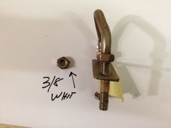

Postby rob.lovelace » Thu May 10, 2012 9:27 pm
you can see the bent one on the left in the second picture, it is a M10 (metric) the original ones are 3/8 whitworth. about 52mm centre to centre. The Uppers are about 102mm centre to centre. All of them are made on the same angle to suit the rig.

Postby Tales » Thu May 10, 2012 9:46 pm
Yeah, you're right mate, it's a ring-in.
There is another thread about 'U'bolts on this site (see below) and Mark had some spares available.
