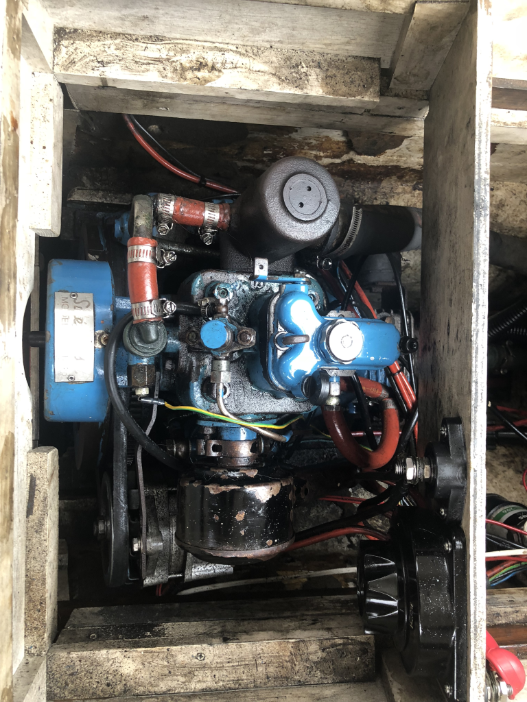

On the way back we came across an issue with the little Sole Diesel, it seems she has a lot of blow by and sprays vaporised oil throughout the engine bay when hot. This resulted in the motor getting low on oil, stalling and not starting again on approach to the mooring. Luckily enough I still had sails and after a couple of circles successfully sailed onto the mooring which was nerve racking but got us out of a pickle.
502
Another sail with some friends a couple of weeks later confirmed that the engine was OK as long as the engine oil levels were kept up, the film of oil persisted and was a proper pain in the arse though and after talking with an engine builder friend it was agreed a overhaul was the only way to solve it. The engine needed to come out.

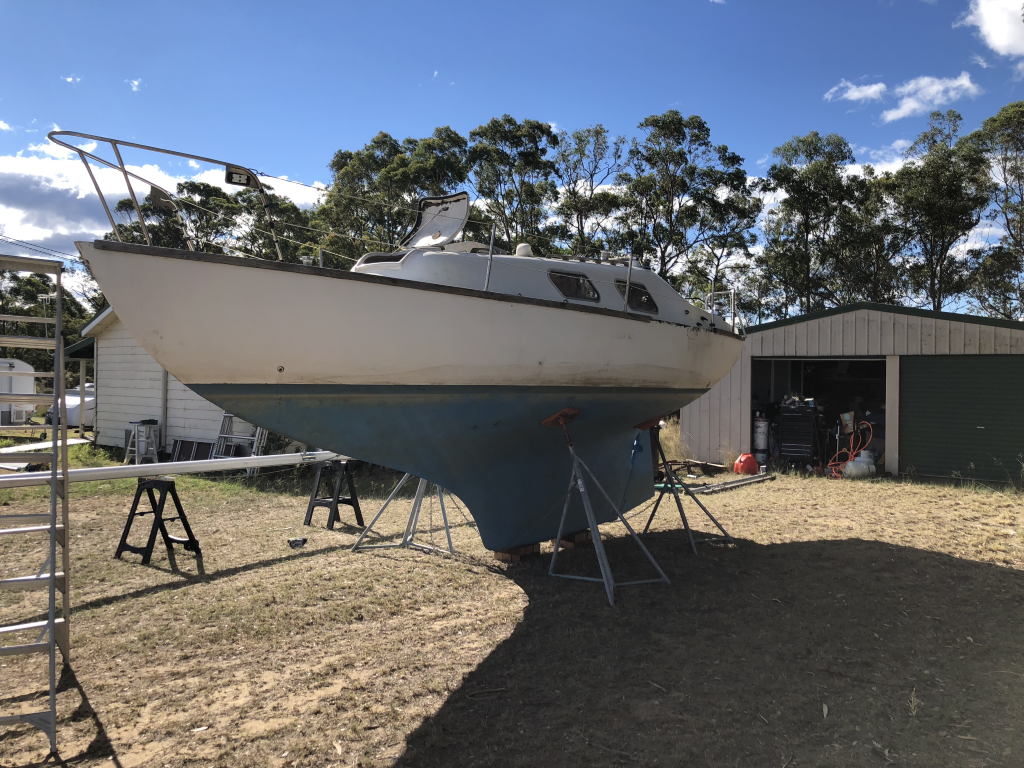

Up next for Ripple Too was a ride in the slings, a ride on a truck and then a ride on a 200t slew crane (franna broke down on the way to the job) and we were finally on the hard.
504
505
506
So there she is high and dry ready for a refit.
For those that are interested, moving Ripple Too both ways works out equivalent to about 12 days on the hard at Woolwich, With her at home, I can take my time, have an extra set of hands and my Fathers opinions and workshop to help me along.

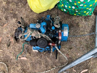

After getting Ripple 2 home the first job was to get the old Sole Mini 3 out, after a lot of boat yoga, some creative use of the block and tackle, some strategic use of the reciprocal saw she was on the ground.
521
522
The original plan was to recondition the old motor and put it back, after a good look at the auxiliaries it looked like along with internal bits I would need a starter motor, maybe a alternator rewind (full of oil), probably a fuel pump and injector, plus who knows what else. So this is the old diesels final resting place, unless she can get a gig as a pump motor on one of the farms around the place.

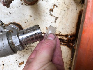

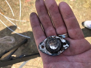

We thought this was an anode that had been antifouled at first, but no, it is a bung installed through the hull into the bilge about 100mm above the bottom of the keel, screws were completely rusted out and all that was stopping it becoming a self sinking device was a scrap of silicon. Fitting sent to the bin, hole to be glassed up.

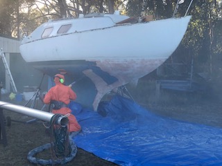

After a false start I final found a stripper, Kris from DK Soda Blasting came and stripped the antifouling in about 2 hrs setup to pack up, saved me weeks of sanding and did a top job.
523
524
525
526
All stripped a small amount of new osmosis was ground out along with a bunch of questionable existing repairs. The good thing about having Ripple Too at Dads is that she can have a good dry out before glassing up again
