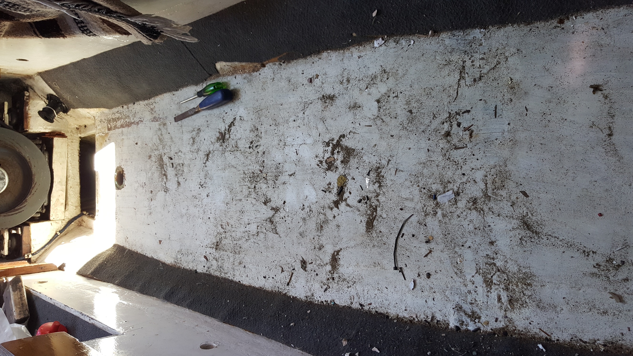

There's an old inspection hatch that's impossible to access on the aft end of the tank facing the engine and a small fill point in the cabin floor.
The tank runs the entire length of the cabin up to the v-berth i'm pretty sure.. is that the same as everyone elses? it's a Mk1

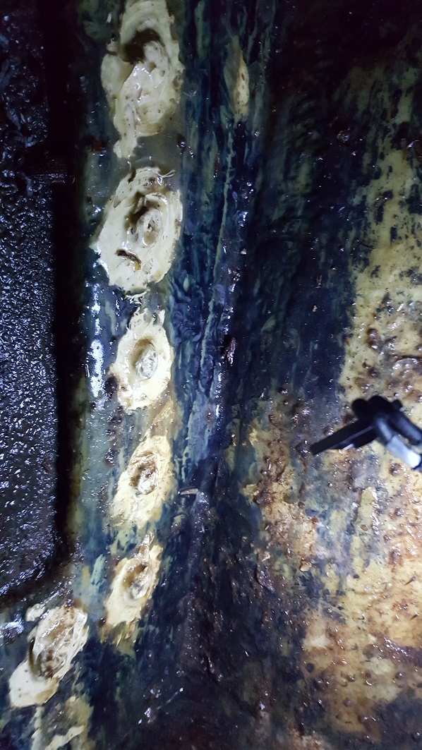

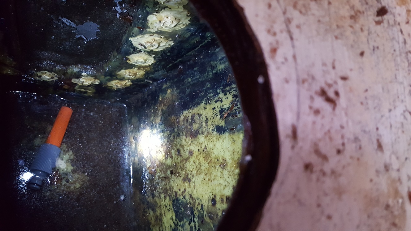

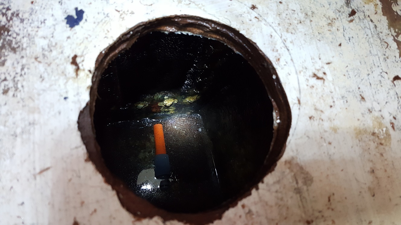

so i cracked it open with a bigger hole
and there was all sorts of crazy gunk in there.. including the garden hose..
here's the view from inside looking forward. .you can see the baffle, seems like a big tank

the aft inspection hatch has some rubber stuff on the inside that is flaking off
aft hatch.jpg (308.58 KiB) Viewed 9420 times
Anyway so i'm gonna put in a flexible water tank plastimo or something, the tank looks a bit too gnarly to refill with drinking water although the water tasted great before i looked inside..
At some point I'd like to open it up and recoat it with some epoxy paint like this guy but that'll be a future thing

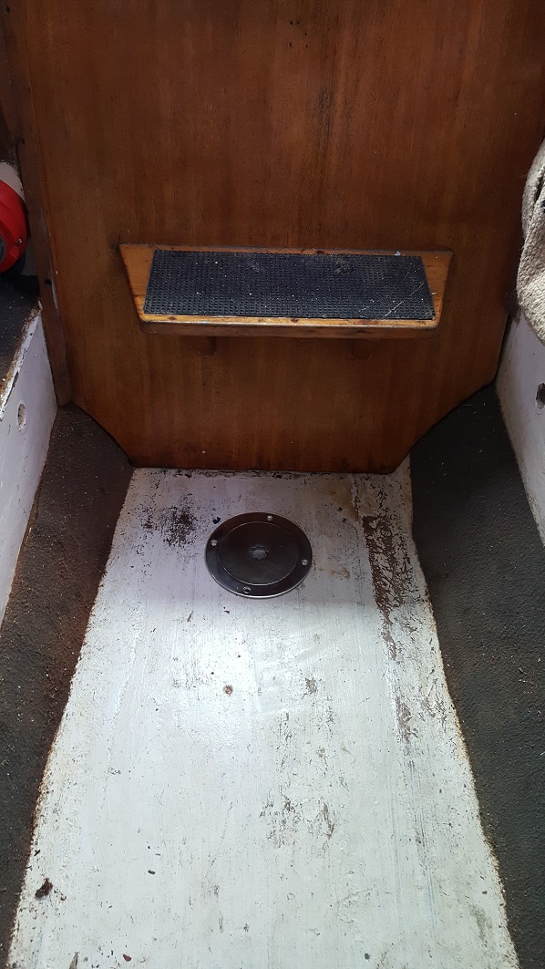

new inspection port
i'll set it down flush next visit
