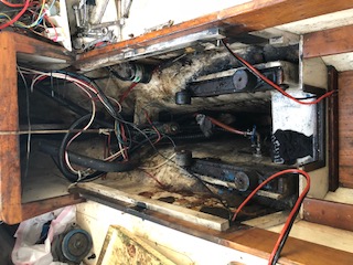

The first job was to clean out the bilge which contained approx 30 liters of water (mixed with oily muck) which had come from the (now removed) water bladder thanks to a hose which rubbed through on the engine fly wheel. The water was too dirty to pump out into the harbour with the manual pump so I headed over to Withworths to pick up some oil absorbers to separate the oil form the water and headed over to the boat.

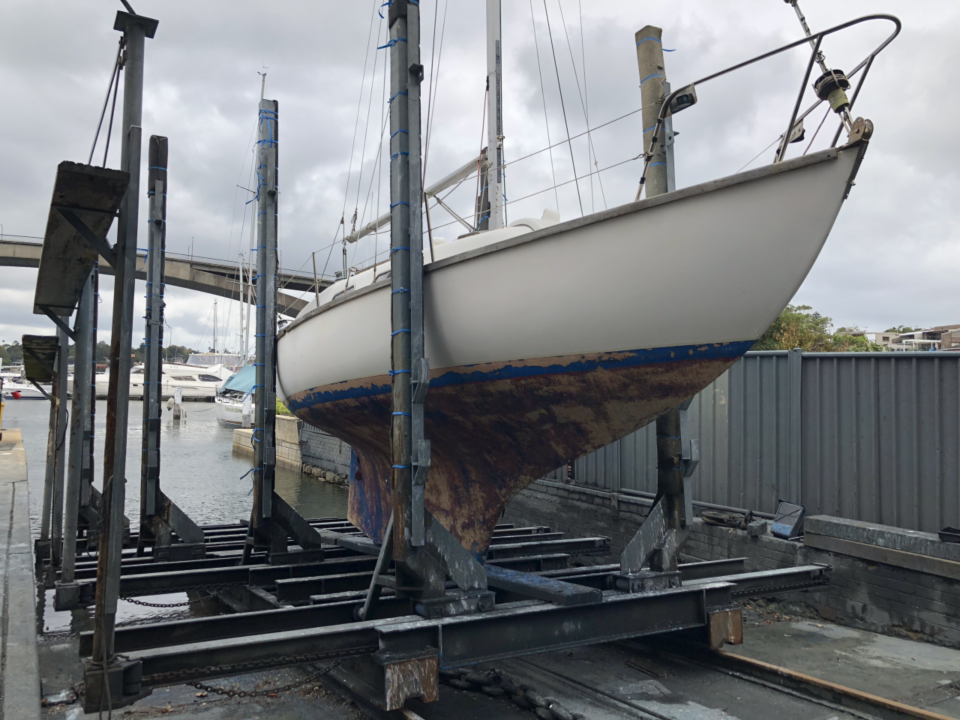

Survey day came and the guys from Gladesville marina picked her up and took her to the slip while I was at work (just across the river). A phone call at midday suggesting I should come for a look before the antifoul went back on revealed this
499
The old antifoul had washed completely off with the water jet leaving a messy looking hull, advice was that she would need a full strip next time as the paint may not stay on. Also found a dozen or so osmosis blisters which would need some treatment.

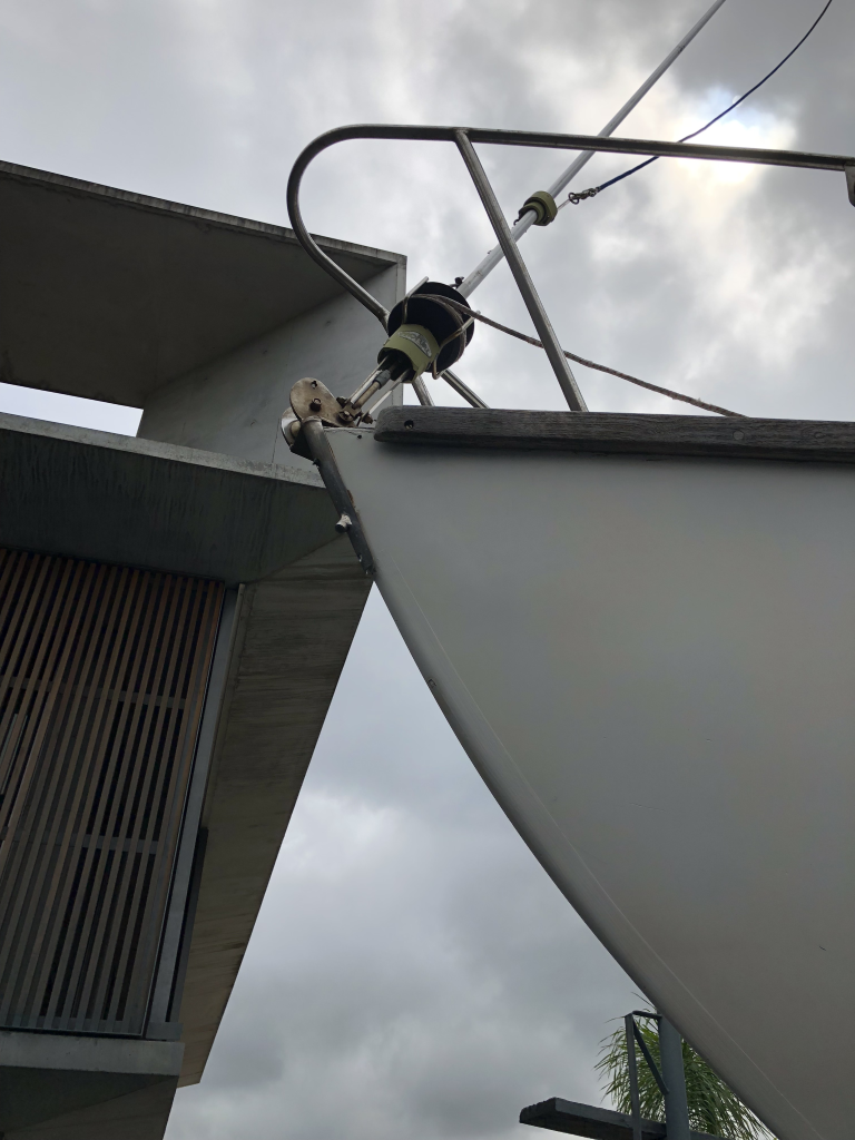

The other surprise was the bow fitting had lifted, after reading a lot of forum posts I worked out that this was becoming common and I would need to remove the fitting, the wet wood and sort out some better support

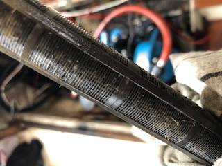

On the way back we came across an issue with the little Sole Diesel, it seems she has a lot of blow by and sprays vaporised oil throughout the engine bay when hot. This resulted in the motor getting low on oil, stalling and not starting again on approach to the mooring. Luckily enough I still had sails and after a couple of circles successfully sailed onto the mooring which was nerve racking but got us out of a pickle.
502
Another sail with some friends a couple of weeks later confirmed that the engine was OK as long as the engine oil levels were kept up, the film of oil persisted and was a proper pain in the arse though and after talking with an engine builder friend it was agreed a overhaul was the only way to solve it. The engine needed to come out.

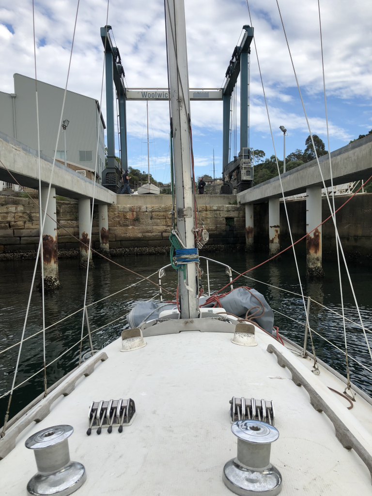

So with everything booked I headed down to Ripple Too after work one evening, stripped all the sails for a second time, removed the running rigging, the boom and loosened the standing rigging a little ready to be hauled out the next morning. I slept on the boat and got up nice and early to run around to Woolwich Dock. On the way I got a call from the transport company letting me know I wasn't booked in for a lift that morning (something went wrong on their end). I turned up and after some discussion I was given the first lift as luckily they had a spare spot.
All good I had a lift and a truck, I didn't need to go back to the mooring and plan this all again, until the question "so you have the mast down already don't you", no was the answer, I had booked the crane to lift it out, "well that wont happen today, the crane is broken". Awesome!. After a bunch of discussions a new plan was devised, I was tied up in the travel lift dock and with a group of dock hands recruited the mast was lifted straight out of the boat by hand and disappeared over my head onto the hard.
503

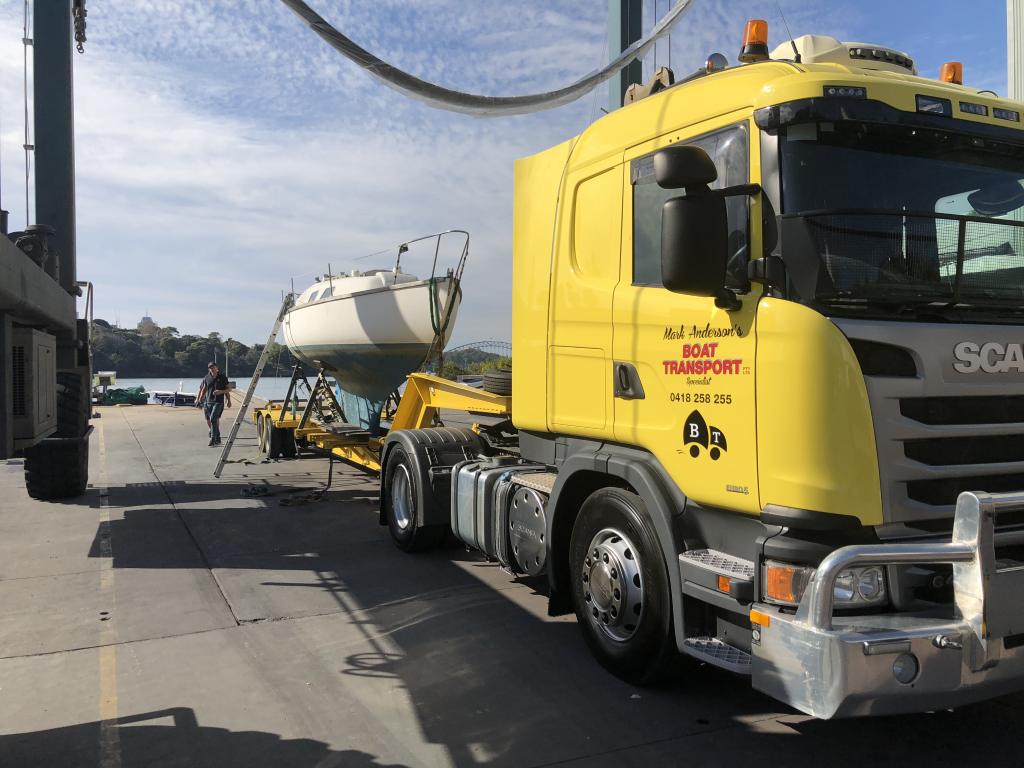

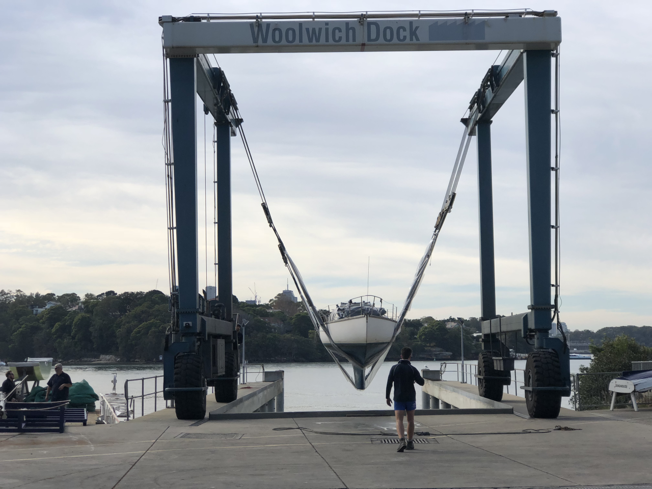

Up next for Ripple Too was a ride in the slings, a ride on a truck and then a ride on a 200t slew crane (franna broke down on the way to the job) and we were finally on the hard.

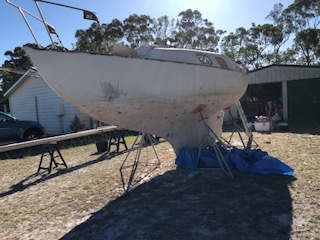

So there she is high and dry ready for a refit.
For those that are interested, moving Ripple Too both ways works out equivalent to about 12 days on the hard at Woolwich, With her at home, I can take my time, have an extra set of hands and my Fathers opinions and workshop to help me along.

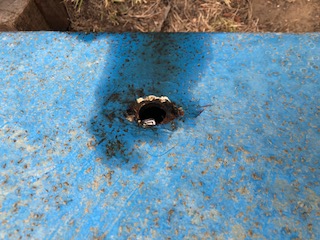

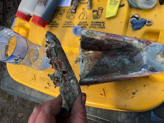

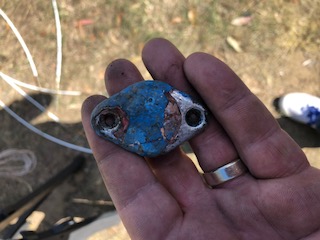

We thought this was an anode that had been antifouled at first, but no, it is a bung installed through the hull into the bilge about 100mm above the bottom of the keel, screws were completely rusted out and all that was stopping it becoming a self sinking device was a scrap of silicon. Fitting sent to the bin, hole to be glassed up.

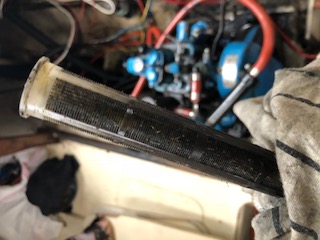

Drinking water filter used as a raw water filter, was very blocked, also in the bin

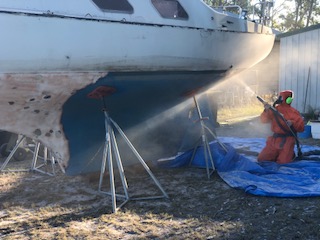

After a false start I final found a stripper, Kris from DK Soda Blasting came and stripped the antifouling in about 2 hrs setup to pack up, saved me weeks of sanding and did a top job.

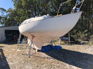

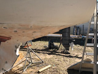

All stripped a small amount of new osmosis was ground out along with a bunch of questionable existing repairs. The good thing about having Ripple Too at Dads is that she can have a good dry out before glassing up again

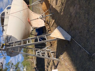

Next job was digging a hole and pulling the rudder out.
527
Dumb thing 5, shoe bedded in a huge chunk of silicon and only 2 bolts actually through the hull

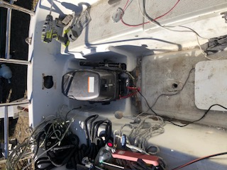

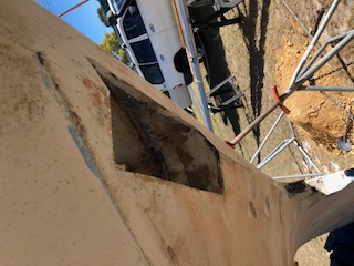

After thinking far too much about how to provide engine power to Ripple Too Dad offered me his old long shaft 8hp Tohatsu that had been in the shed for the past 20 years. So we cut a big hole in the boat and had a test fit, mostly good, may need to move the bilge pump outlet. Motor is now at the mechanic to try and get it up and running again, watch this space.

For the last month we have really just been sanding, stripping fittings and filling holes to try and stop the leaks
520
Photo of the mast girder and the heap of silicon that used to be under it
