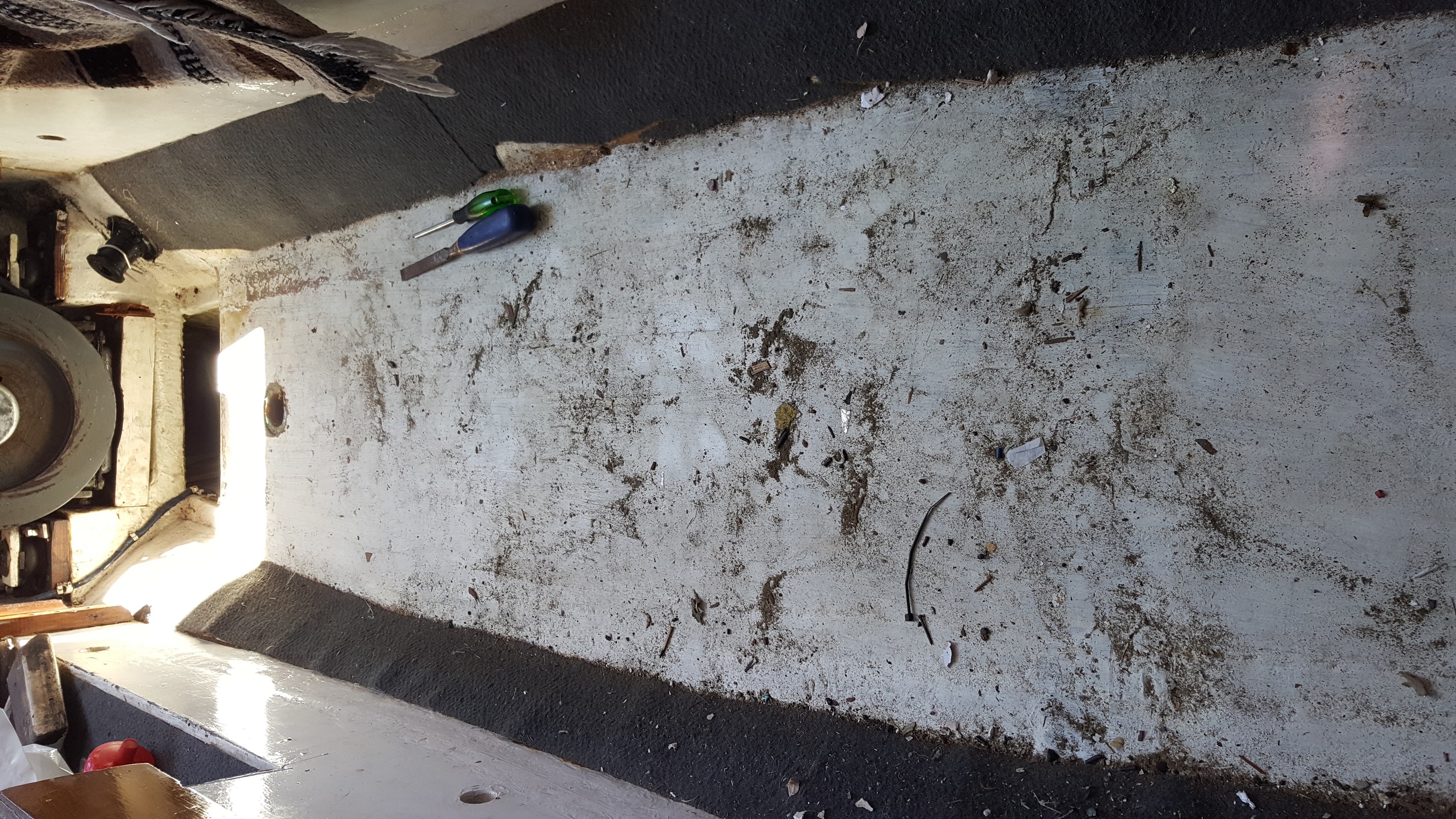

There's an old inspection hatch that's impossible to access on the aft end of the tank facing the engine and a small fill point in the cabin floor.
The tank runs the entire length of the cabin up to the v-berth i'm pretty sure.. is that the same as everyone elses? it's a Mk1

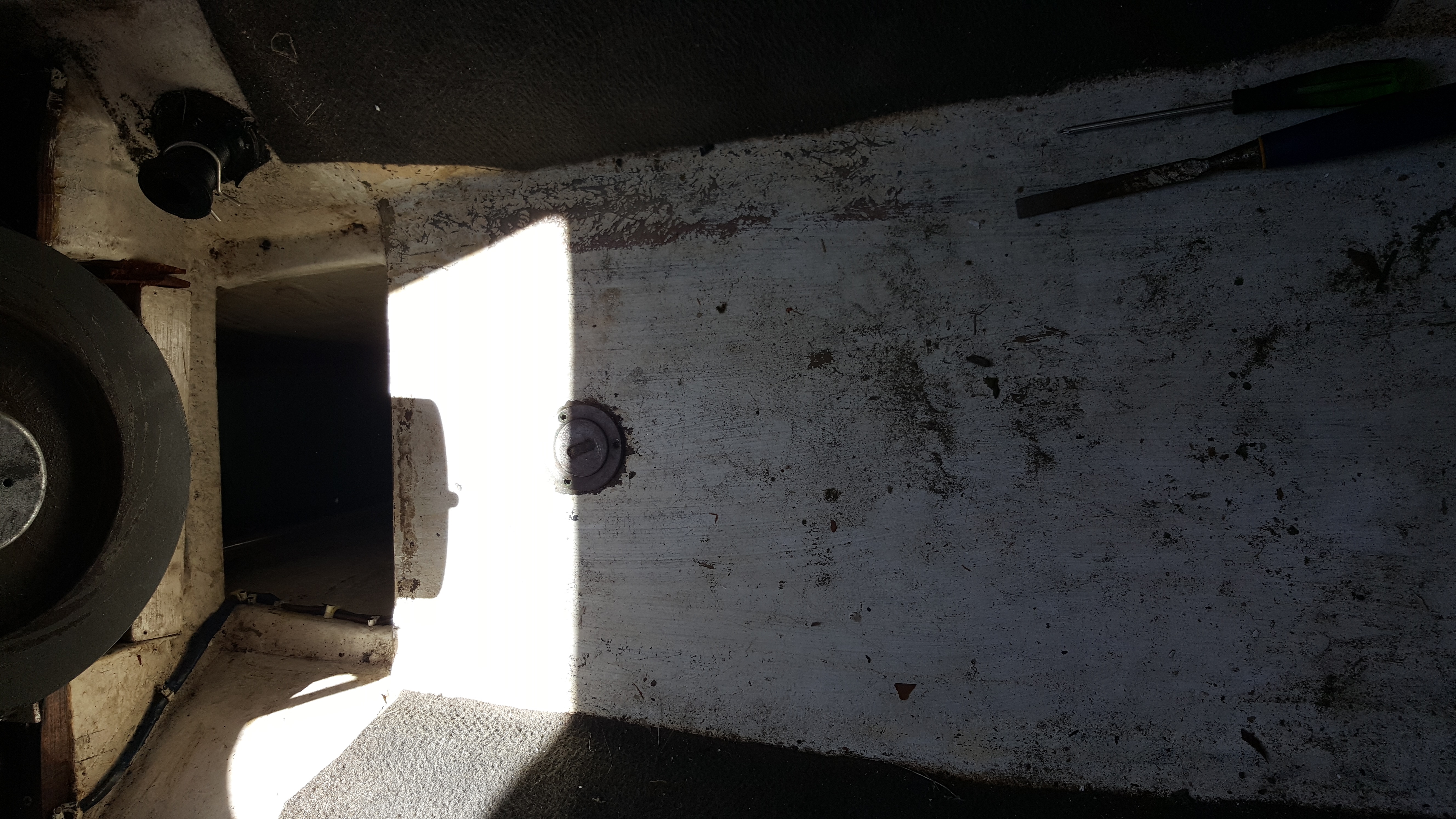

Postby Sailtime » Tue Nov 15, 2016 8:12 am

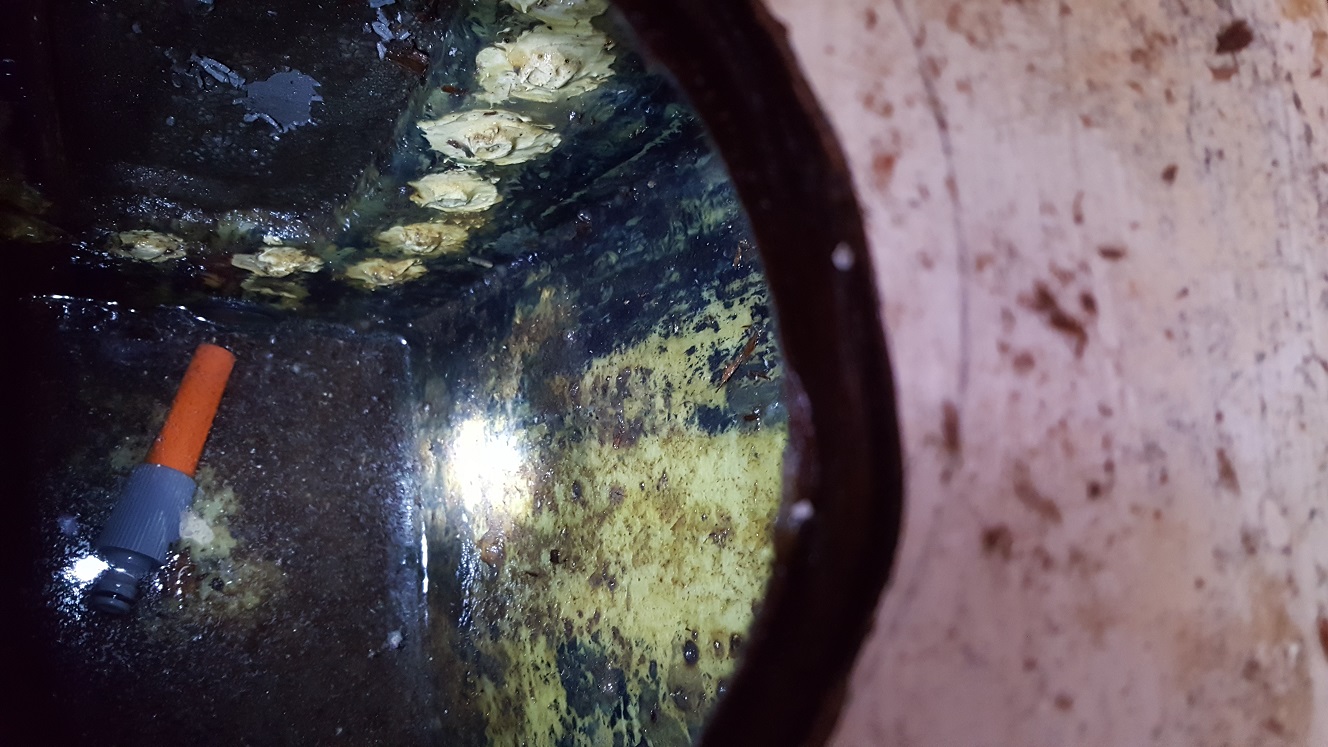

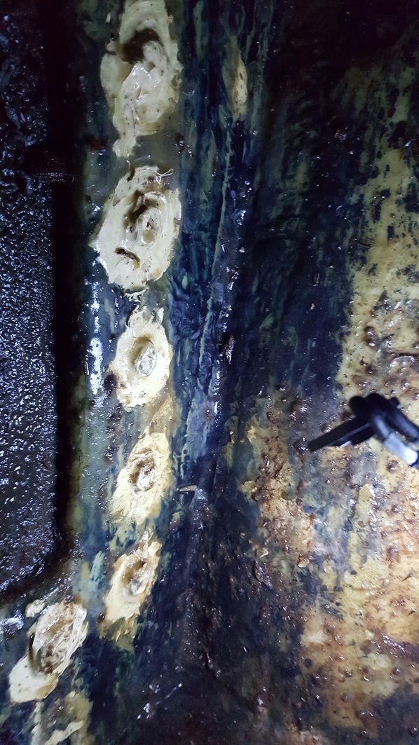

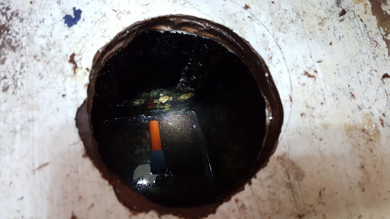

so i cracked it open with a bigger hole
and there was all sorts of crazy gunk in there.. including the garden hose..
here's the view from inside looking forward. .you can see the baffle, seems like a big tank

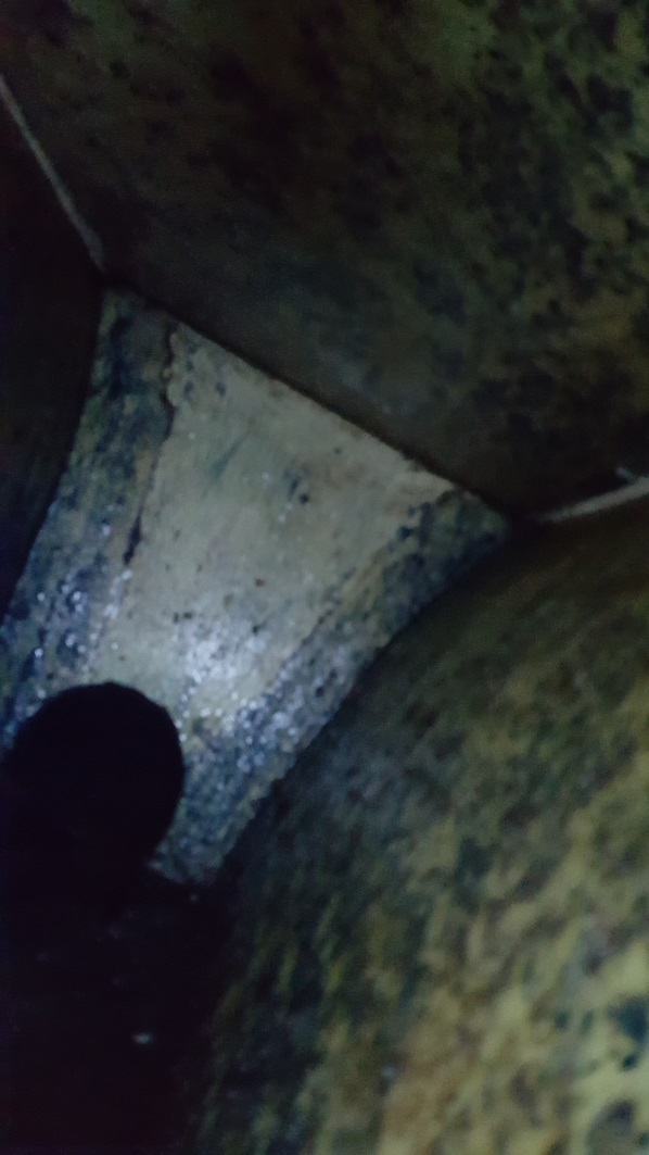

the aft inspection hatch has some rubber stuff on the inside that is flaking off
aft hatch.jpg (308.58 KiB) Viewed 9414 times
Anyway so i'm gonna put in a flexible water tank plastimo or something, the tank looks a bit too gnarly to refill with drinking water although the water tasted great before i looked inside..
At some point I'd like to open it up and recoat it with some epoxy paint like this guy but that'll be a future thing

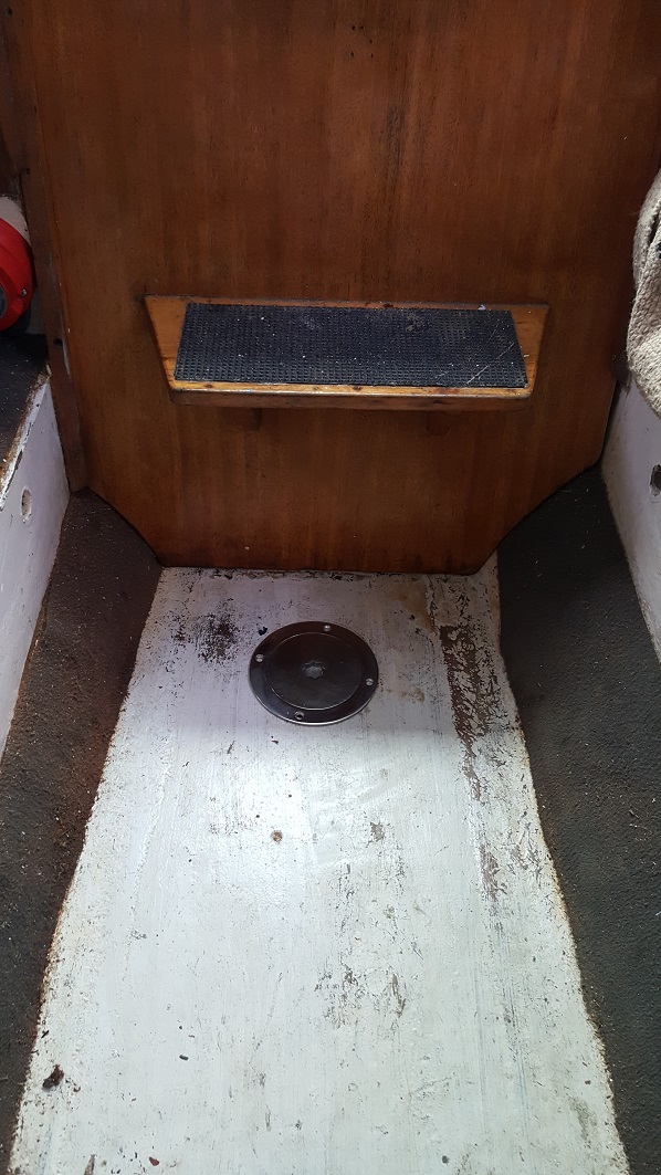

new inspection port
i'll set it down flush next visit

That is certainly a big tank, Sailtime. Haha, now you have a new hose nozzle. Certainly interesting what you find in those hidden away spaces.

That's a Mark 1, 169 litre water tank!
As Formit lowered the cabin roof in the Mk2 and then again in the Mk3 they also lowered the floor each time so as to maintain the ceiling height.
Subsequently, this reduced the water in the sub floor tank for the Mk 2 & 3.
