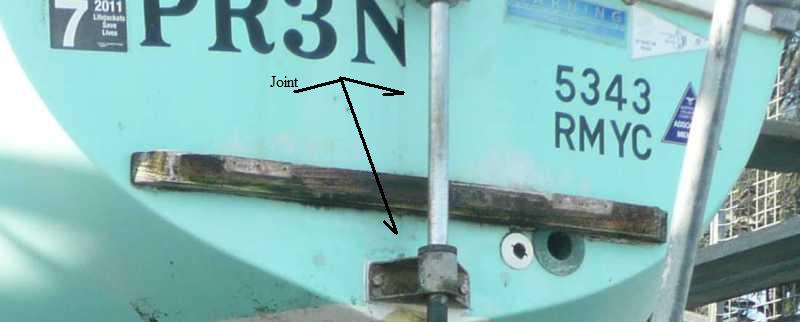

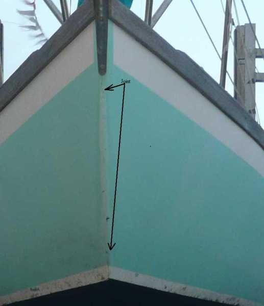

Postby Dolphin » Thu Jul 05, 2012 9:14 pm
Oh Bear I don't think so!
I can definitely see a joint in the stem and transom. They're definitely 3 part hull.

Oh Mr Greg ? that line you see is the joint line where the halves of the mould are joined and poorly prepared by the builder ! I guess it is a Mk 3 !!!!! :lol:

Perhaps that join comes from using a chopper gun instead of hand laying the glass? I do not know where the two part hull thing came from either. The joint is between the deck and the hull and that is the one that can leak if glassed poorly.

Of course Bear is totally correct. The join line you might see is what is called "flash"in plastic moulding, where a little bit has leaked out between the molds. You could make a hull in two pieces, but then you would have a weaker structure unless you went to a lot of trouble to reinforce the join. Why would you bother?
