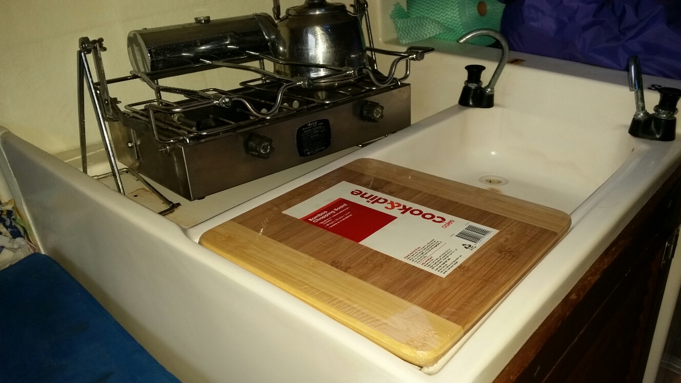

Picked up a $6 cutting board from Coles the other day, its a perfect snug fit on the draining board of a MkIII
Postby Troppo » Sat Mar 28, 2015 6:11 pm
Looks like it was made for it.

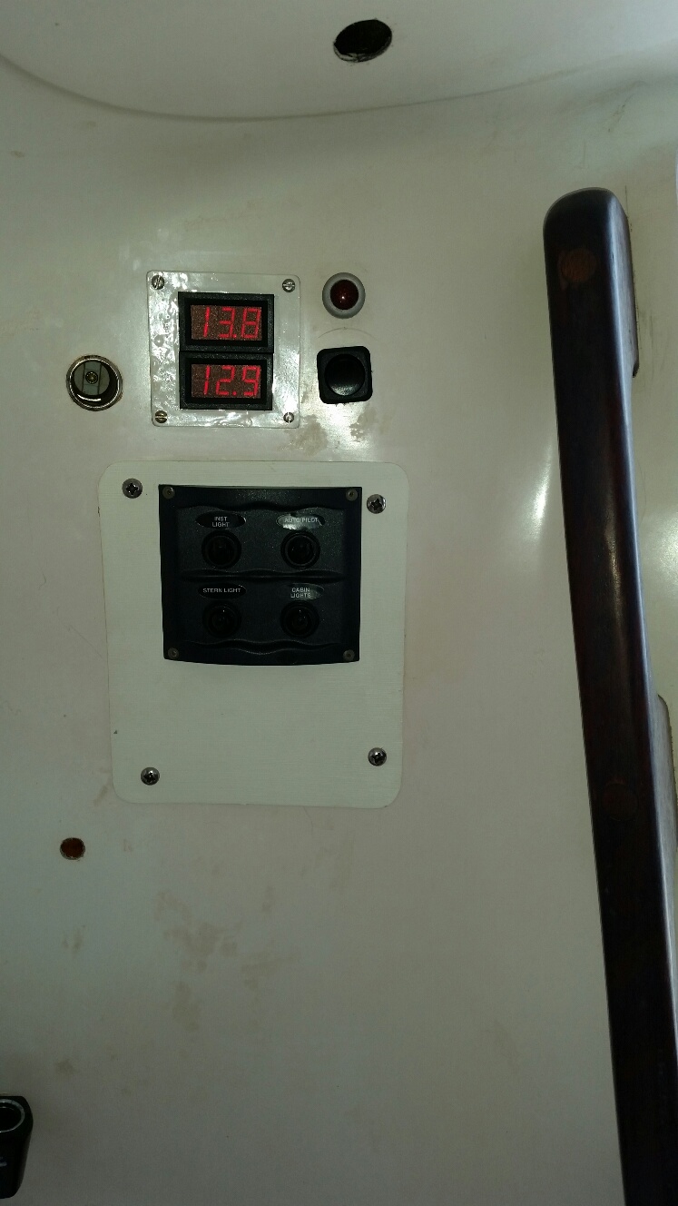

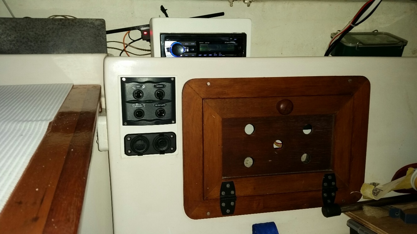

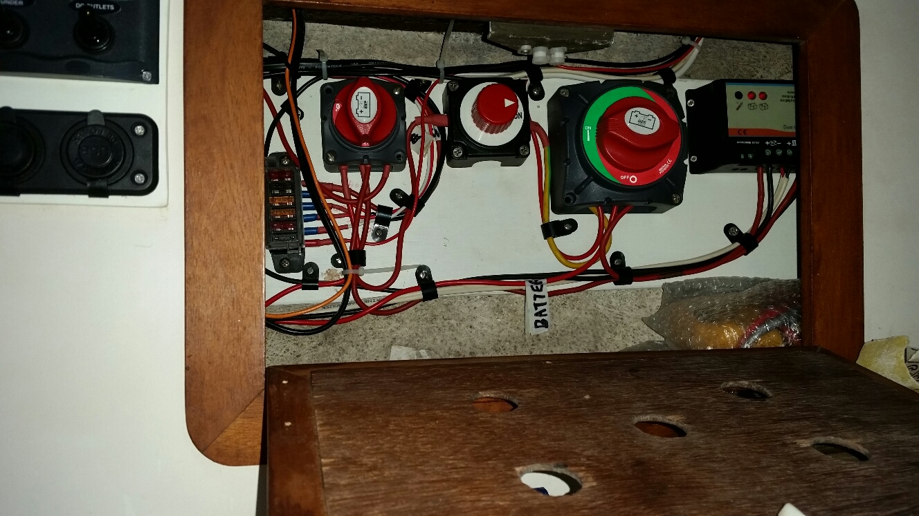

Finished a couple of projects today.
One, re-wiring and new switch panels, with a simple volt meter for each battery. I tucked the master switches inside a locker (yes i know one of the switches is massive over kill, but it was what i had on hand) . Put appropriate fuses on each circuit.
The re-wiring took a lot longer than i thought it would. The new wires started being quite neat, but gota little messy towards the end, but much better than it was.

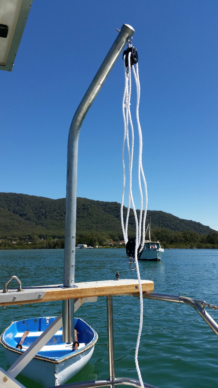

I'm hoping the second one will solve one of the problems of an outboard on the transom. ...lifting the outboard froma dinghy or onboard to the bracket, so fabricated this hoist .

I like your outboard raiser Shaun!

Shaun: Your wiring looks great! Having the two volt meters would be useful. I am interested to find out how your crane goes in practice. I'm thinking it will make it much easier handling an outboard over the back.

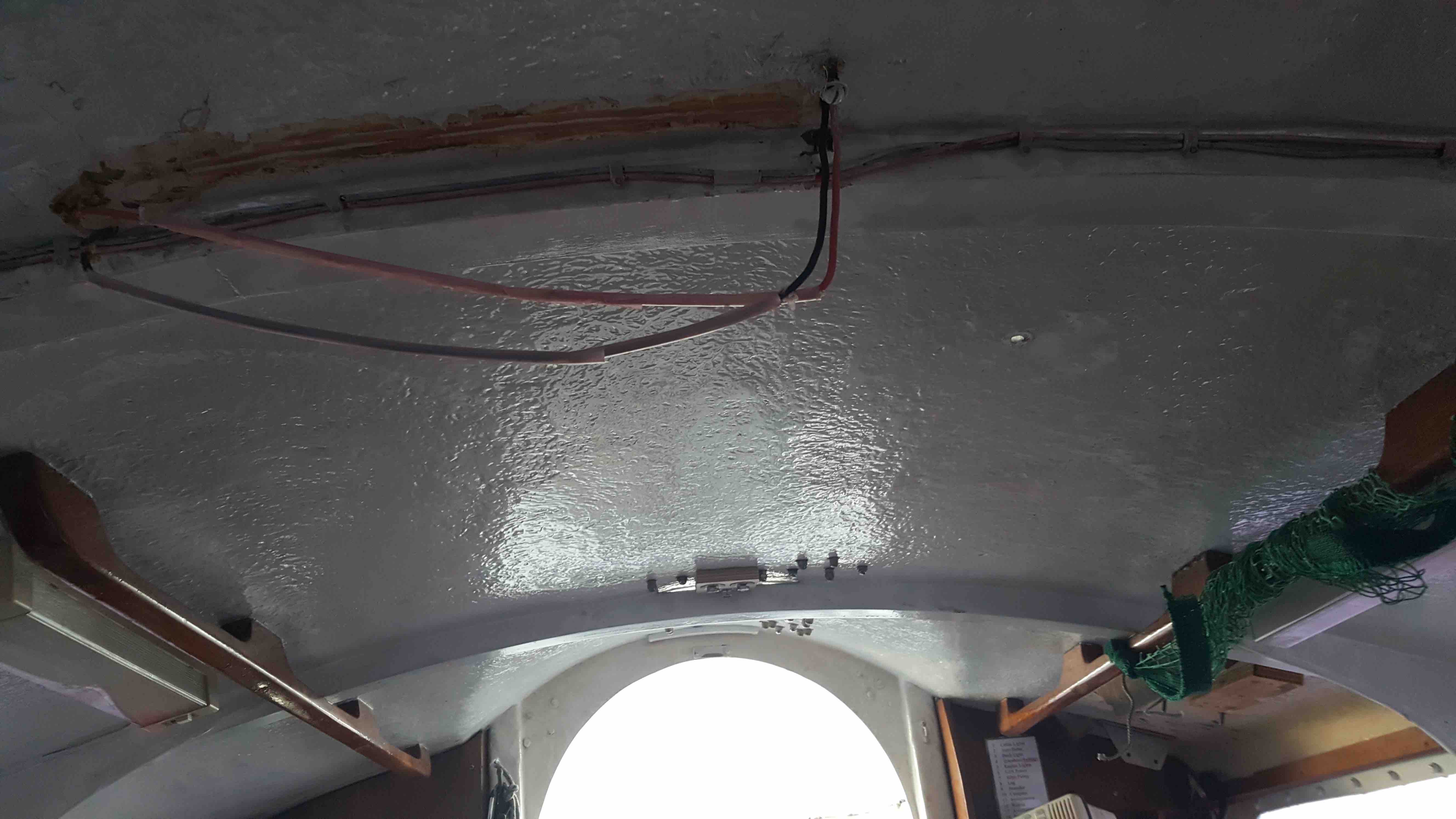

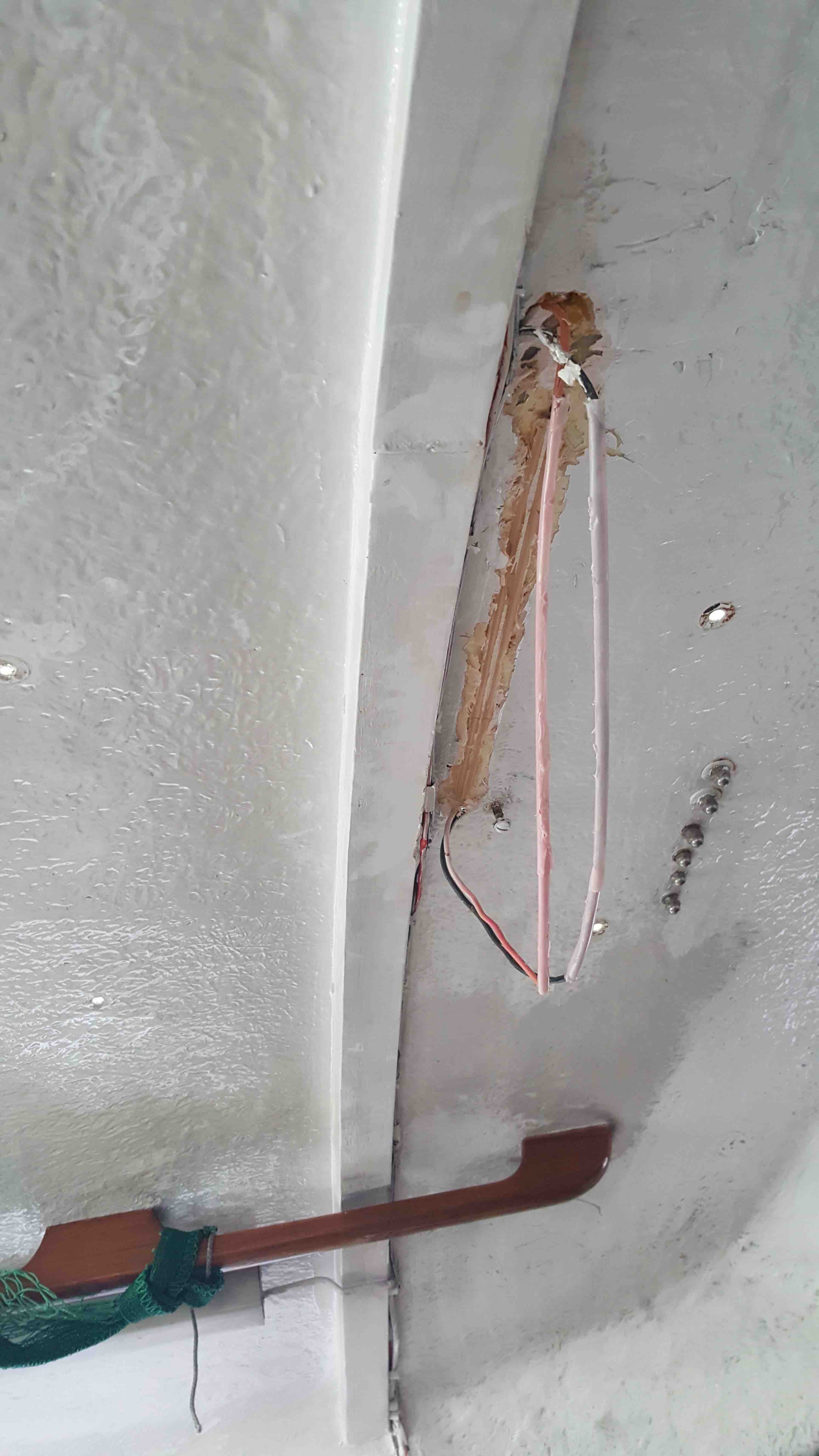

Ancient solar panel on deck that I want to upgrade.
The wires were glassed on the inside of the roof.. I have no idea how old it is but it looks ooold.. also my house battery was flat the other day so i'm planning on upgrading the panel
Wires 2.jpg (374.43 KiB) Viewed 9951 times

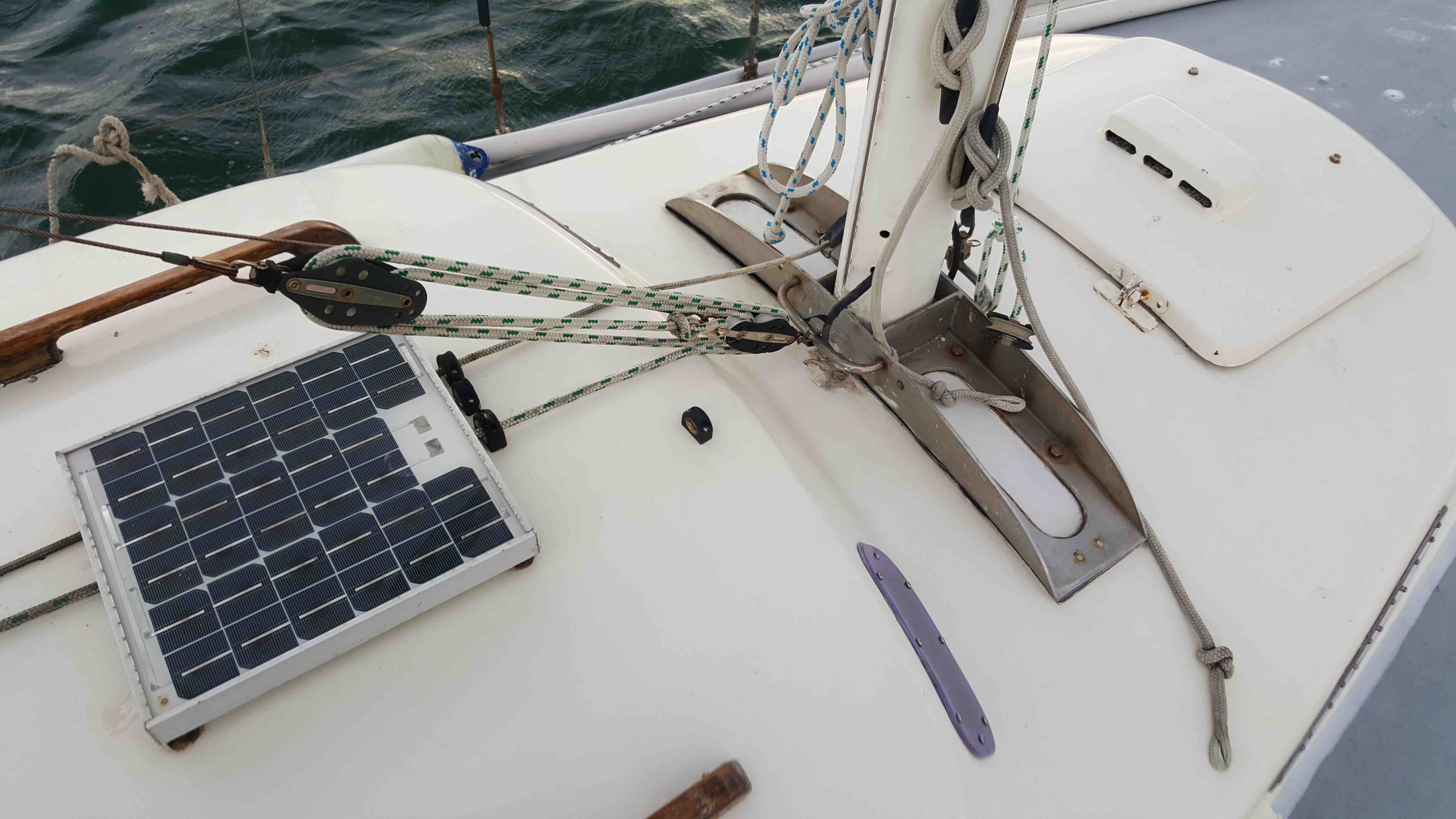

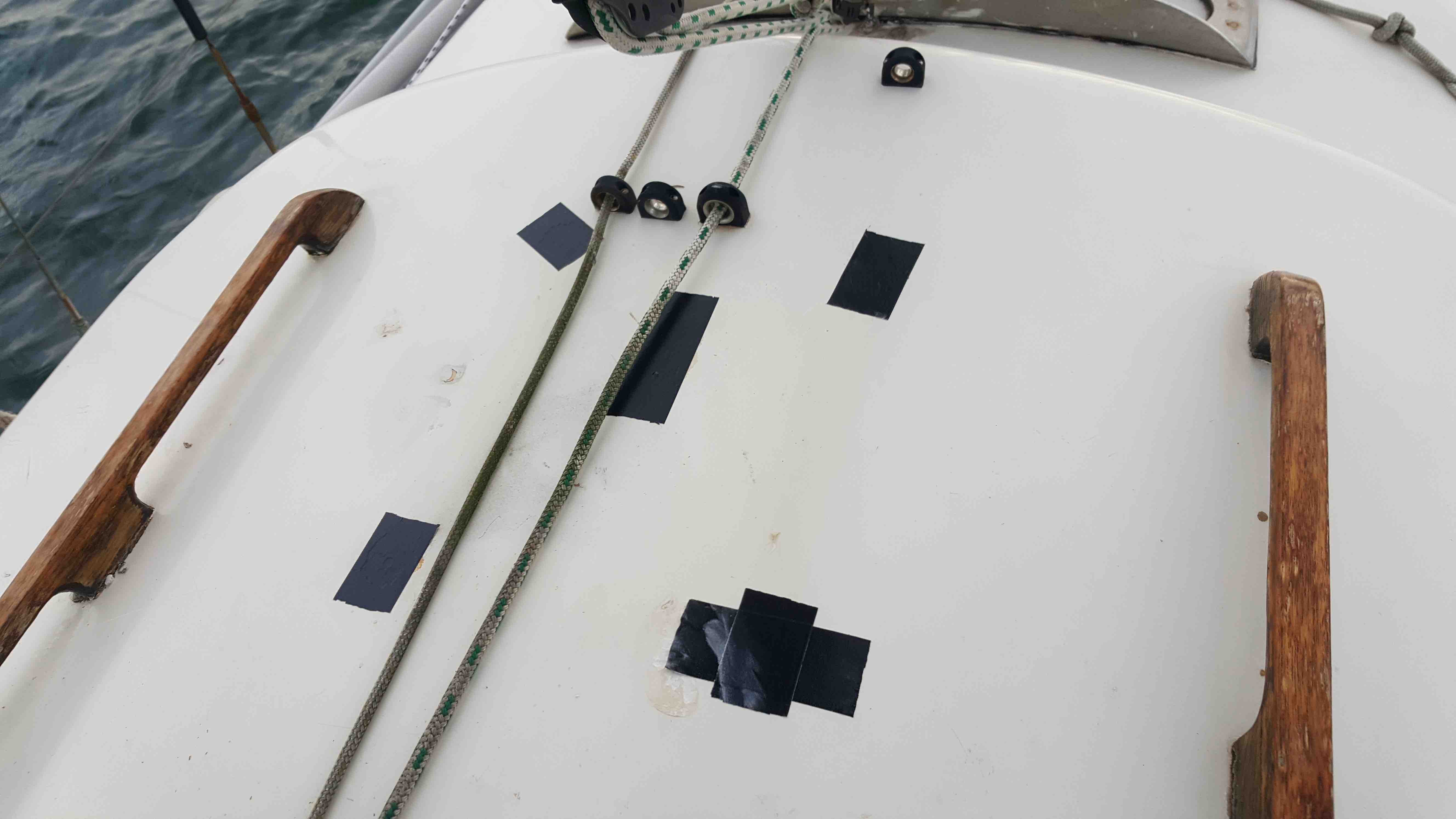

On the cabin roof under the boom not the ideal spot for it anyway
Panel 2.jpg (480.42 KiB) Viewed 9951 times

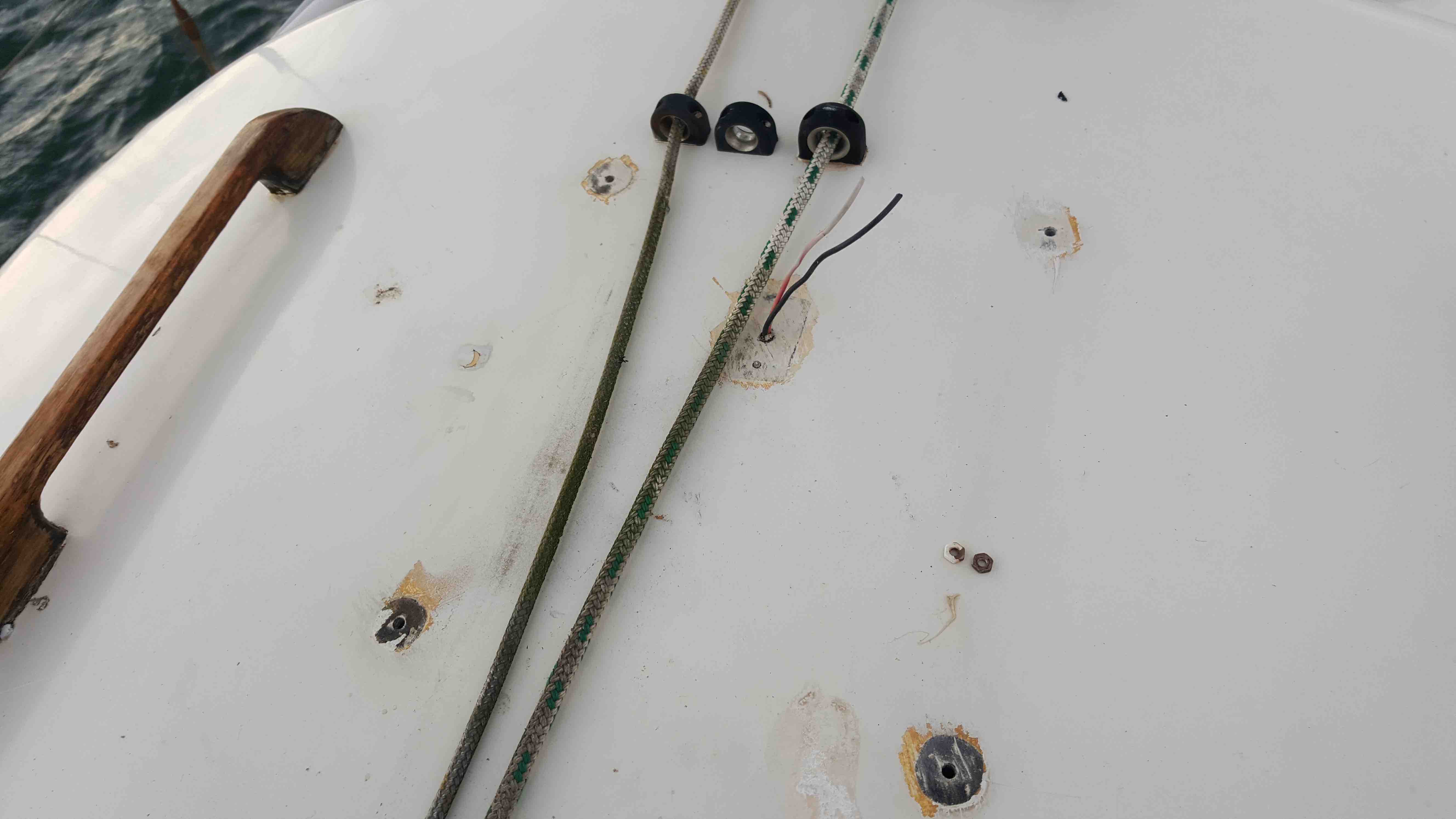

Removed..
Will epoxy up the holes over the weekend.. until then the tape should do the trick
Any thoughts on the best place to mount the new panel? above the aft end of the cockpit looks best but how would i go about getting a stainless frame?
