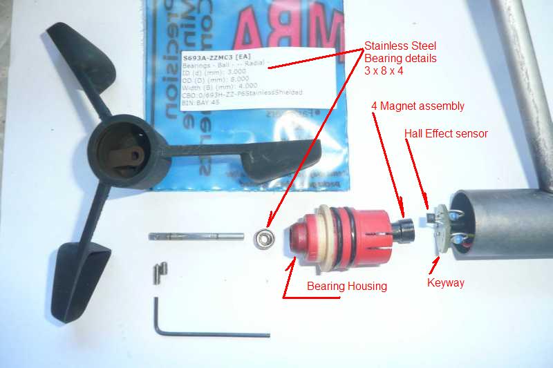

I thought you might be interested in this little job.
I had to replace the bearing in the wind sensor. This is the 2nd bearing I have replaced. THe last one fell apart.
The bearigns are no longer available from Autohelm Aust and the arm is obsolete. A replacement arn is about $500 and reads 25% low. It's a different design.
THe bearings are available through any leadiing bearing supplier like CBC or in my case Bearing Service Corp, BSC Motion Technology. THey are about $12 ea. plus postage.
The bearings push off and there are normally two small circlips but I lightly centre popped the bearing area on the shaft and applied Loctite. All the components are easily hand assembled. THe bearing is a bit tight at the moment, needs a near gale to get it going, but it will free itself up with use.
Exloded view of the wind sensor

Well done! How did you know what the right replacement bearing was?
Louis
Re: Autohelm ST50 Wind Bearing Repair
Postby Dolphin » Sun May 27, 2012 9:59 pm
I just measured the bearing and rang a supplier.
They did the rest.
A bit expensive but it is a small order.
