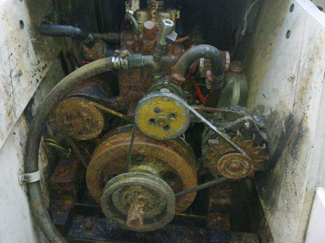

Is your diesel beyond repair Shaun?

storm petrel wrote:Is your diesel beyond repair Shaun?
Not really Mark.
Im pre-empting the inevitable, at the moment its engine mounts, but what next??
The engine itself, starts first time, everytime, even after it hadnt been started for quite some time before I bought her. It has great things like a solid bronze impeller etc, but its the appendages like the mounts, gear linkages, stern gland, all the electricals, seacocks for it etc etc etc.
So at the moment I dont know.

Wow it looks like something from the industrial revolution. You could probably pick up a reasonable second hand diesel for a couple of thousand. Minards are expensive but often have rebuilt yammers for sale. Afloat also have secondhand diesels advertised regularly. Seems a shame to go to an outboard if you have the inboard peripherals but I can understand you wanting to go to something less problematic.
