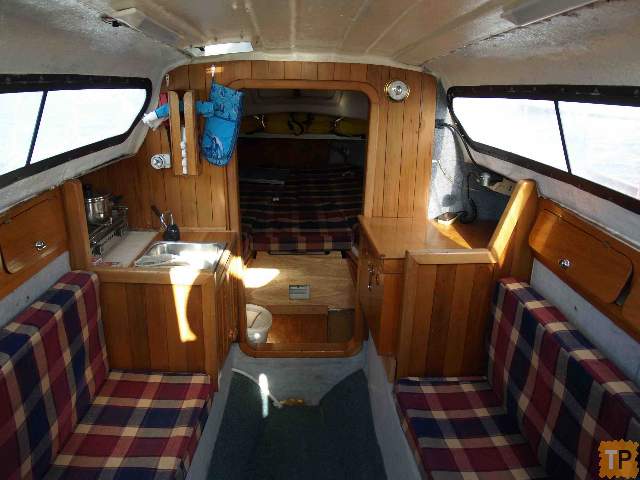

Mine is actually just sitting on a timber platform the previous owner put in to replace the old pump out, it's nice enough. You could perhaps strap it in, but where mine is, it's quite snug and can't really go anywhere. Sorry, this is the only photo I have that shows where it is, but not how it works. If you look into the V berth, you'll see a timber fascia, with a slot cut out. The potti is behind that fascia, and the handle to open the trap is in the slot. You have to lift the cushion to use it.

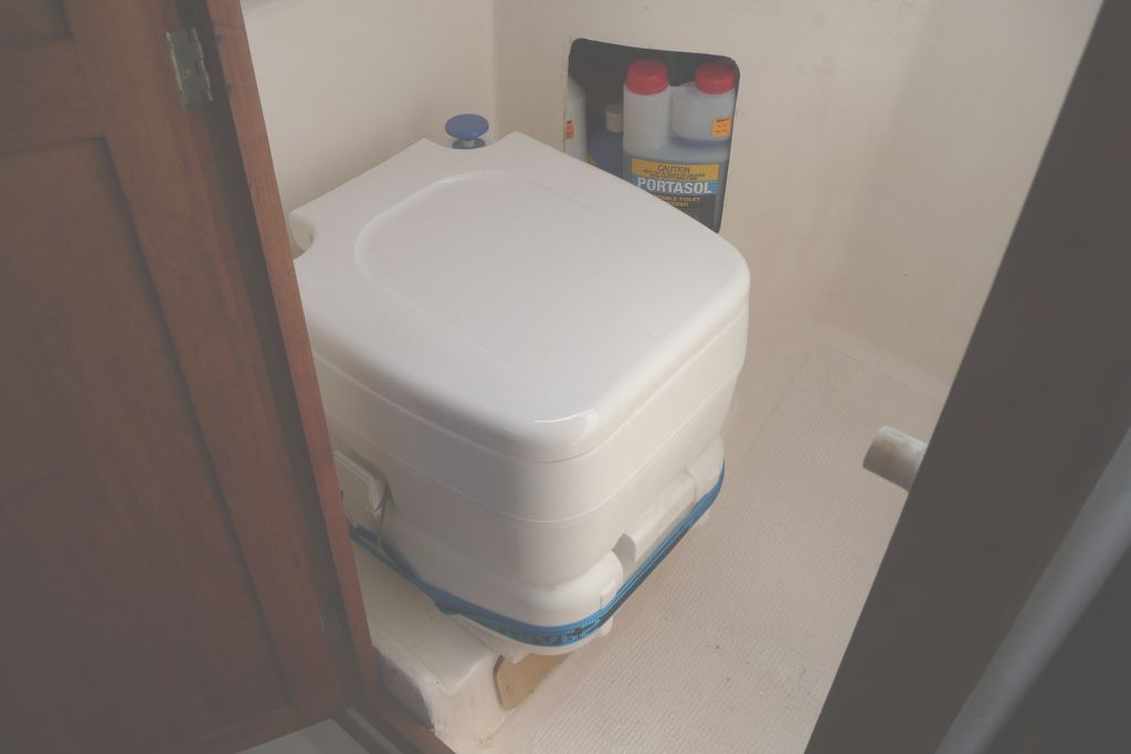

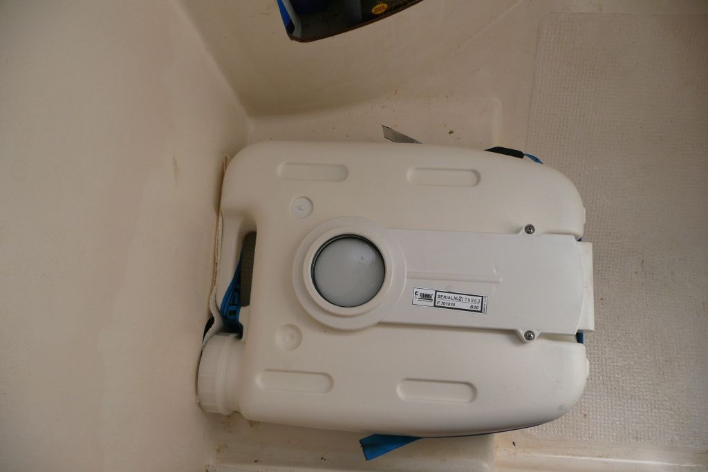

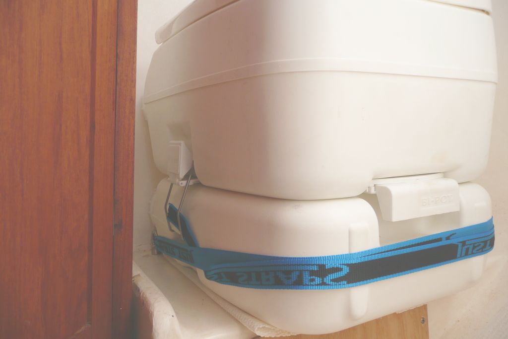

Postby Dolphin » Sun Sep 20, 2009 7:55 pm
G'Day all,
Thank you to everyone who helped with information on Porta Potties especially Mike and Dianna.
I have just installed the Fiamma Bi Pot Cat No 89623 with a 13l holding tank purchased from Whitworths.
I used 2 collared eye bolts M*8 Cat No 35137. Be careful the thread is long but the plinth is very thick under the toilet. You need to cut the bolt to about 50mm plus. There is a lot of room below the plinth.
I used one diecast camlock roof rack tie down Cat No. 90381 Looking at the catalog it may have been better to get the Overlever Buckle Cat no 90451.
Enclosed ar epictures of the installation. It actually gave me more log room. Before my knees used to rub on the bulkhead and now I have about 25mm of room.
I put miracle grip doubled up under the toilet to stop it slipping Cat No 141101
Photos enclosed.
Thanks
Felicite MkIII
