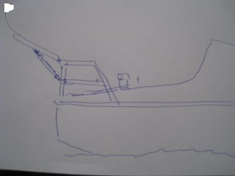

I would of thought that Solar would be the go now, because the price of the panels has at least halved in the last year or two!, ....as an added bonus their quiet, will still work at peak performance in the beautiful calm anchorage, & if you can build or mount them on a SS targa type frame (jessica watson style) their out of the way & offer a little sun protection, you could also hang or attach all the other useful stuff to the frame.
Or it would be easy to fabricate a swivelling/angleing type mount for the panel on the pushpit.

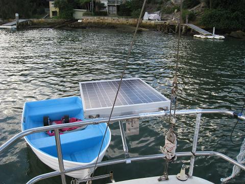

had a battery problem after installed a electric toilet after staying onboard for a weekend.(I had 2x start batteries onboard)
now I've installed a 40w BP solar panel /regulator/85Ah deepcycle battery for house usage.no more problem.
keep the start battery for the inboard motor only.
ps.I was told some other solar lose it's charging ability after a few years.
BP is the best.

Postby Miker » Mon Sep 20, 2010 3:44 pm
That's a nice set up Sylph,
What are the hinges and support brackets? Are they stock from a chandler?
Re: solar v wind (or an S&S34?)
Postby 8philip8 » Mon Sep 20, 2010 8:39 pm
yes Michael
from Whitworths ....3 x deck fitting+ coupling(25mm)
Sylph

Postby Miker » Tue Sep 21, 2010 3:59 pm
8philip8 wrote:yes Michael
Sylph
Excellent Sylph, gotta be better than the 6 foot timber post mine is currently on!
