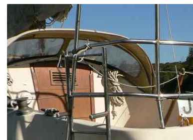

Phillip, Re Dodger... Having cruised with & without, I ike them, but as with everything its a compromise. To my mind, exposure is a big issue when cruising on a 'small' yacht & especially when solo or 2 crew when you don't hve an option to stay below much, and especially when its v hot/sunny/cold/wet. I've used the same adapt-a-cap for > 10 years which stays put in all weather and offers varying protection from cap to full on Lawrence of the Arabian Sea style.
The Dodger on Pelagian does not fold down. Its got a v strong stainless frame (in part cos it's not too large). Cabin top join is by rope sewn into the canvas and held in sections of grooved alloy bracket attached to the cabin. There are three gaps, two for travelller sheets & one for the main - which I don't currently use. Very little water came in through these spaces, but conditions were not at all severe. I had some concerns that the Dodger might restrict leg space when exiting cockpit to go forward. It does slightly but this is more than made up by its use as a hand rail/grip from cockpit to cabin rails. On the recent sail south I could hear when to duck my head - didn't have to be looking at what was coming. I didn't feel it restricted my view forward, and only banged my head once when exiting the cabin, but have had it there since purchase of Pelagian. Retro fit would involve re-learning! The other benefit on a TH is that 90% on the time it keeps rain/dew out of the cabin. Much of the time it provides a bit of shade for crew and instruments. Available photos attached. If you want more details/measurements I can send these in a couple of weeks.
Dodger 1c.jpg (11.65 KiB) Viewed 18286 times
The Dodger material is old and willl soon be replaced - my best learned tip on maintaining new 'clears' - Sunscreen etches plastic, so slip slop slap but not on the Dodger!
