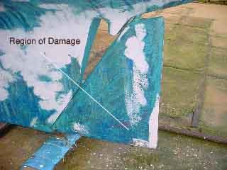

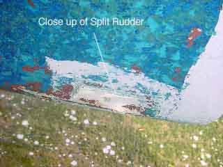

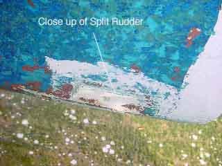

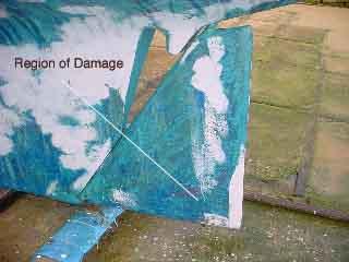

I have just gone through this whole exercise myself. In my case, the cracks in the rudder were of such seriousness that I decided to have a whole new rudder made. What I suggest you do is check the rudder for any serious cracks. If only minor ones are found, that do not require further work, then filling it with sealant could work effectively. Yes, I did have water running out.
I will put up the before picture of my rudder when I get a chance, so you can see the problems I had.
Tom Transfield
Tom's Rudder
The damage.
