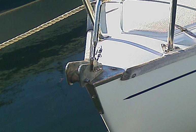

I had to do significant work in this area after a small bump on the bows last year.
Removal of the original fitting revealed poor fibreglass layup and rotting wood within.
I looked around the marina and coppied a bowroller design which gave good sideways security as well as taking headstay loads and fullfilling bowroller duty.
Happy to supply more details if needed.
Planning to round it off a bit inkeeping with the style of the boat.
Bowrepair 027.jpg (64.94 KiB) Viewed 7177 times

I had the bracket made.
I could find nothing off the shelf suitable.
The design I used could be made suitable for 2 mooring lines by adding another cheek plate on the opposite side.
