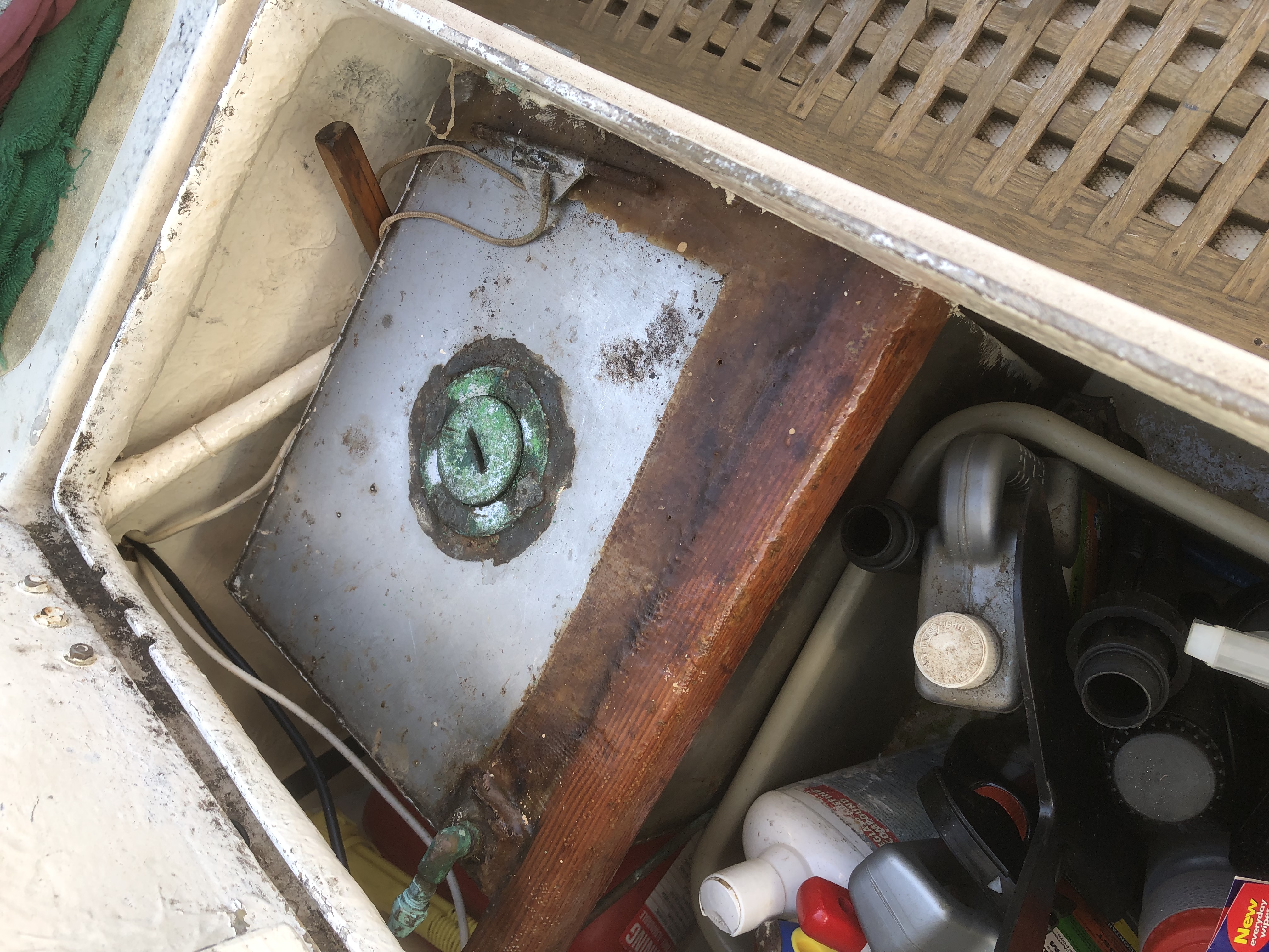

Postby Phillip » Thu Dec 22, 2022 1:23 pm
Seaka’s fuel tank.
Here you go sailtime. It’s a mark 1, port cockpit locker. 30 litres.
