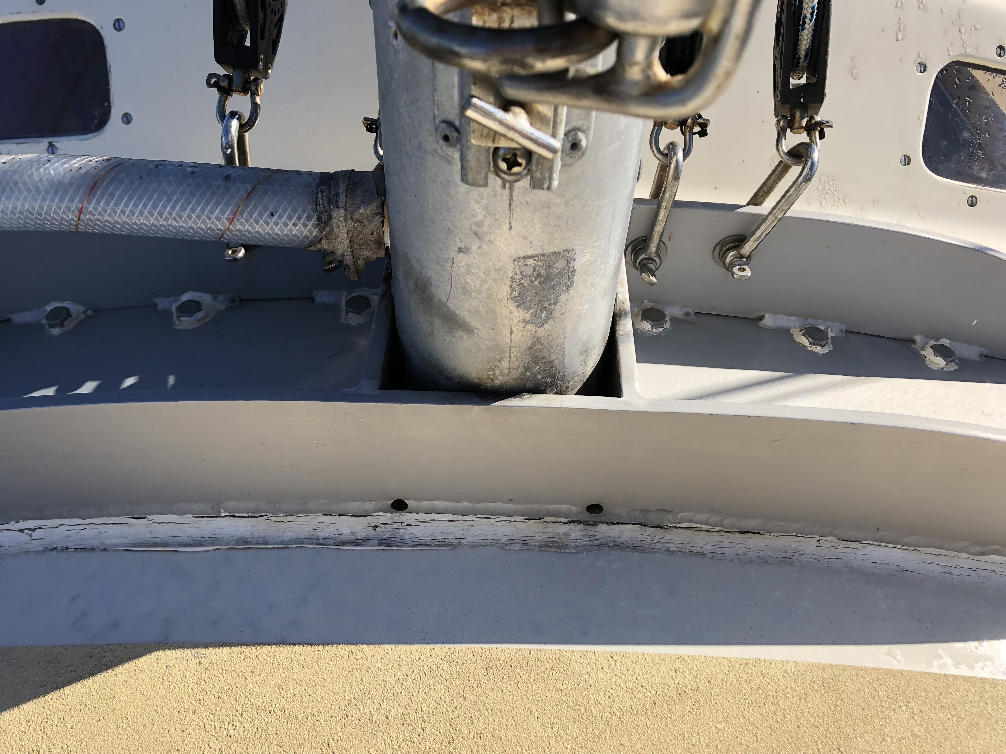

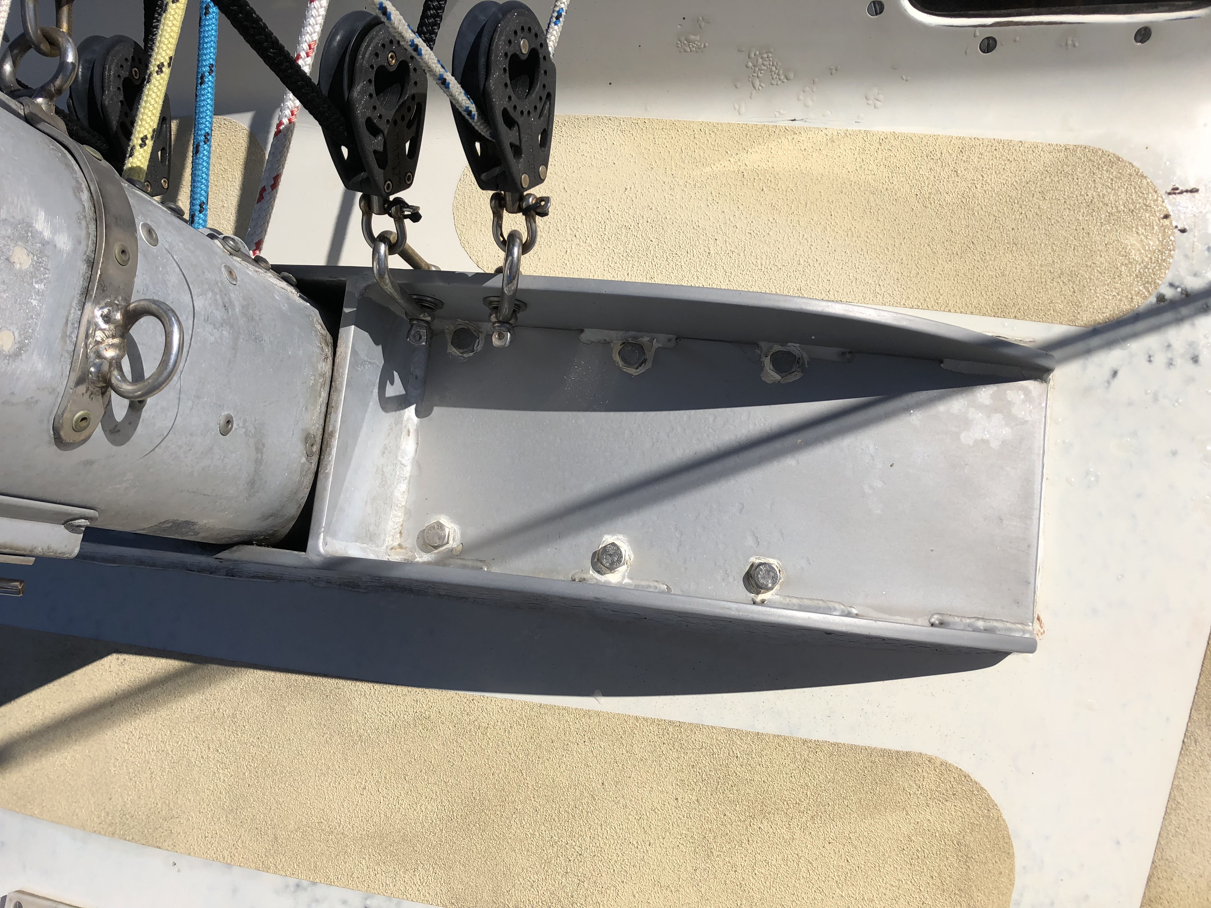

Postby Phillip » Tue Apr 03, 2018 6:08 pm
Murray,
I have an aluminium mast girder and it has no corrosion issues.
It was welded up just like a normal steel girder.
Remember if you get one made it is sitting on a slope forward and aft as well as being slightly rounded port to starboard.
If you can get an al one made it may be best to drop the mast sooner so you can get it made.

Postby Phillip » Wed Apr 04, 2018 11:04 pm
:D photos coming tomorrow Murray.
Re: Mast step
Postby Phillip » Thu Apr 05, 2018 9:04 pm
The Al is 8mm stock.

Postby Murray Raff » Fri Apr 06, 2018 10:54 am
That's excellent, thanks very much Phillip! You seem to have the girder on a sheet of material (rubber?) which was recommended in one of the many blog contributions that I have read - perhaps one of yours. Also, I take it that you have used stainless steel bolts to hold it down - how have you isolated them from the aluminium?

Re: Mast step
Postby Phillip » Fri Apr 06, 2018 10:20 pm
Murray Raff wrote:That's excellent, thanks very much Phillip! You seem to have the girder on a sheet of material (rubber?) which was recommended in one of the many blog contributions that I have read - perhaps one of yours. Also, I take it that you have used stainless steel bolts to hold it down - how have you isolated them from the aluminium?
Many thanks again, and kind regards, Murray
No that's silaflex and thanks to your requests I found I have to replace it, 7 years old now. Its there to keep water out from under girder and the holding bolts
