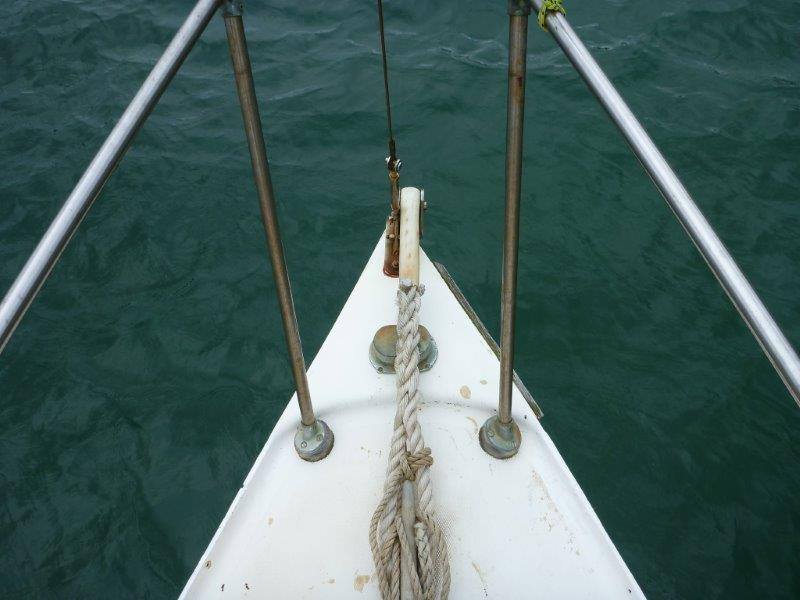

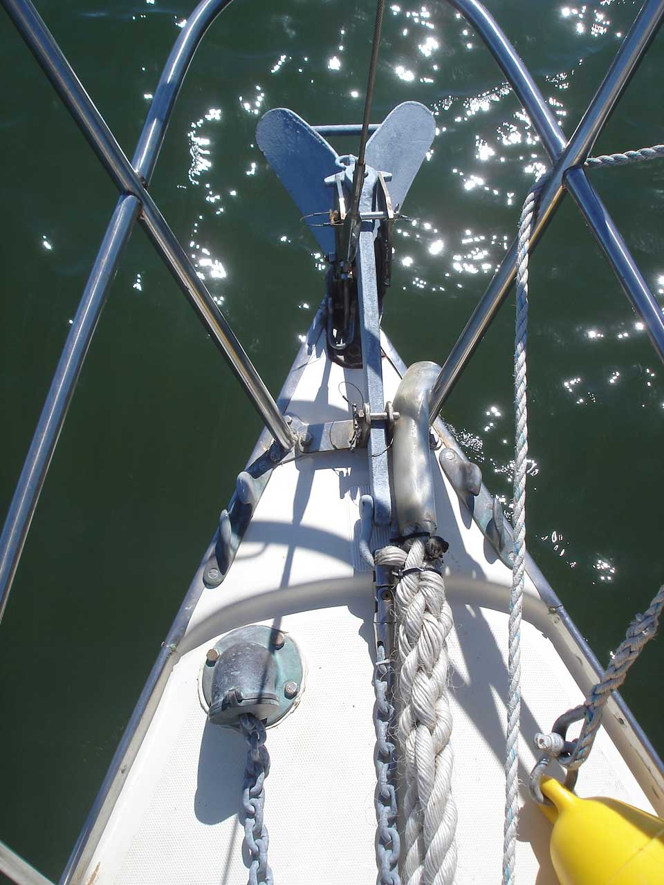

Topi,
Mark 1's usually have the joint covered by a strip of SS which is pinned and the pins roved over, ie permanently!
Look here.....
Seaka's bow.
If there are any gaps you should seal them off with fiberglass resin befor you apply another rubbing strip.

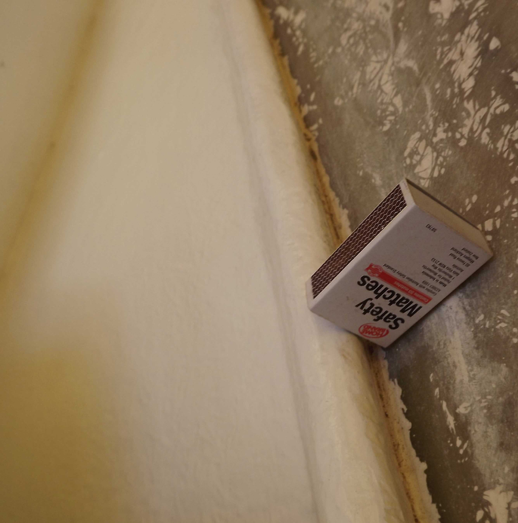

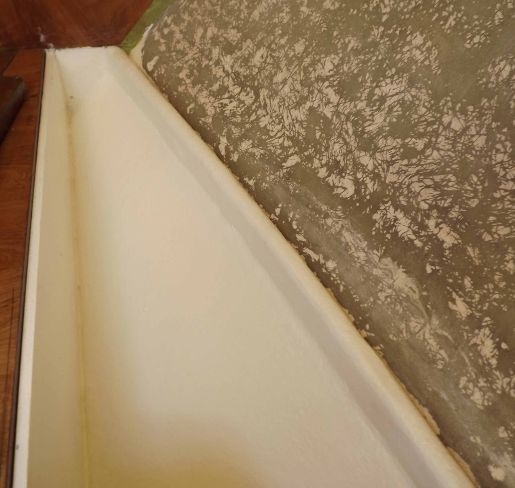

I would be interested in seeing a photo of the rail that supports the forward locker boards.
This is what Seaka's looks like.

Postby Topi » Sat Jan 25, 2014 7:39 pm
The ungelcoated bit in the photo, is that the hull below water level or is that part of the deck to topsides join ?
1972 edition. That is a start. The guy doing the boatcode asked about the maker and I had no idea, nothing written anywhere either.

Postby Phillip » Sat Jan 25, 2014 7:59 pm
Topi,
Its inside the forward cabin.
Forward cabin of Seaka
