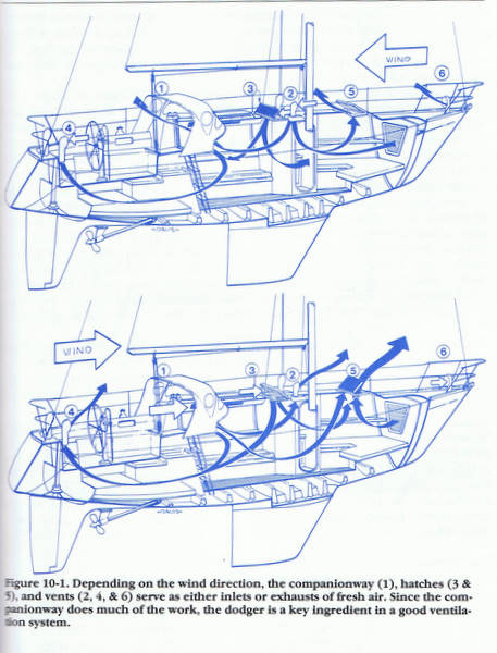

Hi Top Hatters
regarding air flow and vents thought this might help
