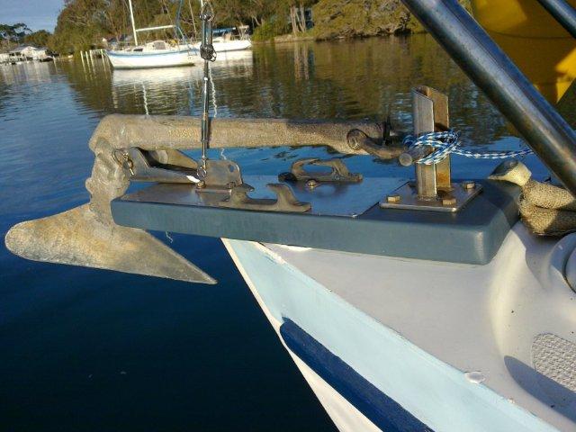

Is this the type of chain stop your referring to?
:arrow: https://www.whitworths.com.au/main_item ... lutePage=1
I haven't used one of the above, so dont know how quickly you can engage it.
I dont think you would use the stopper in the above link to take the full anchor load, although they say its designed to take the tension of the windlass. I would back it up around the main cleat or post, & install with a marine ply backing plate.
My chain stop/chain slot is on my samson post, so very quick to use.
Quiz: There is something wrong with my set-up in the above pic....anyone know what it is? :?:

Shaun,
If you hit a big sea you are going to wear your anchor around your ears! :o
It's just sitting there and not secured in any way :shock:
You have major mods ahead of you!

Nope....
Well your right, but imagine the anchor is not there!, I just had the anchor (35lbManson) sitting there while trying to work out restraints for it (btw couldnt figure out anything bombproof, so keep the anchor below, until I can trade it for a Manson Supreme), there's still something wrong.
I was kicking myself for days once I realised the problem....... :cry:

S.......... No chain! :shock: :shock:

Phil,
When I re-installed the samson post/chain slot/stop, I installed it back to front! :oops: , .......didn't realise until I went to put my mooring line over it, facing the way it does now the edges of the post bite into the line somewhat :cry: , instead of going around the nice smooth section as it should. :cry: .
I have to put a timber block inside the section so it gives a round larger surface area for the mooring/anchor line, could also pad the edge with some plastic hose or something.
