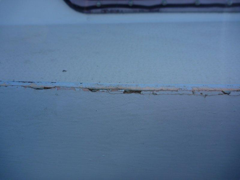

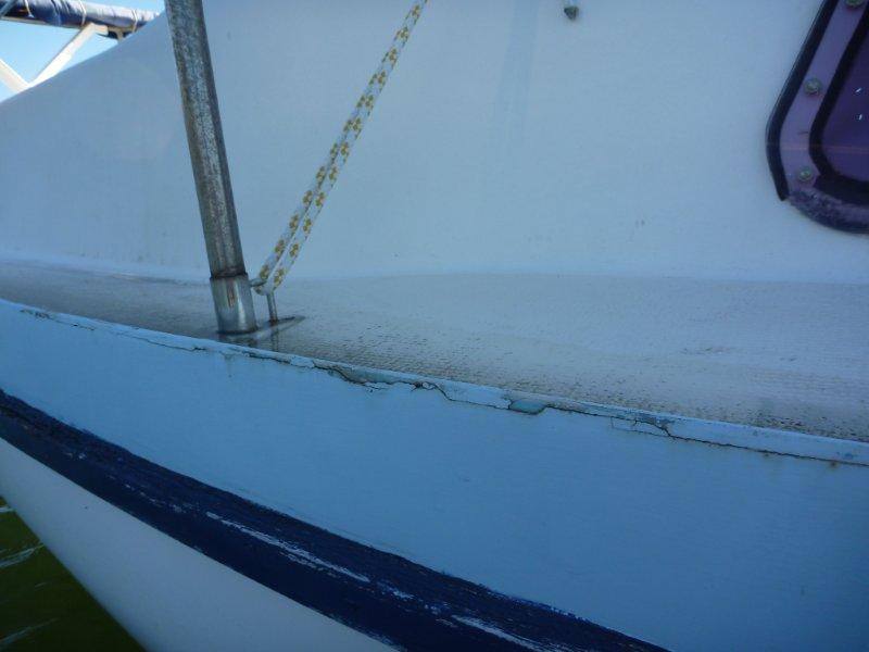

Postby Shaun » Mon Aug 01, 2011 6:15 pm
Gday Bear,
These are the worst couple of areas
I need to get around to making some scuppers while im at it.

Postby bearmcnally » Mon Aug 01, 2011 7:50 pm
Hi Shaun
This is what I had in mind and cheap to do.
Marine grade aluminum angle sikaflex and pop riveted or self tapped to deck
Teak 1800 x 50 x 25 drilled countersunk ,fixed with metal threads through angle and fixed in position through deck and hull flange .Leave say 50mm gap between each gunwale timber .

Postby Shaun » Tue Aug 02, 2011 3:25 pm
G'day Bear,
Thanks for that.
I hadnt considered using ally angle at all & I think that would look very neat if done well. The angle would add strength when standing against it when heeling. I wonder if the angle could be installed without kerfing it, to get the bend required.
But I dont think I would be happy grinding off the complete vertical lip.
I'll have a think about it

Postby bearmcnally » Tue Aug 02, 2011 8:59 pm
Hi Shaun
If you used an angle say 20mm x 12mm ,the 12mm being on top and started from the stern it should bend around with out a problem.
