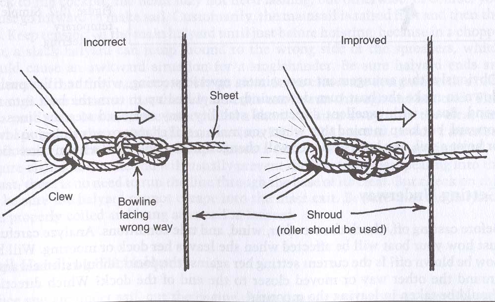

Postby Phillip » Sat Apr 17, 2010 12:07 pm
Shaun,
Your problems with catching sheets can be solved this way :D
Always lead your sheets outside the shrouds.
Correct way to tie a bowline on your foresails.

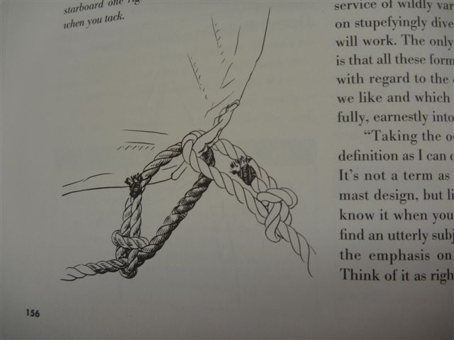

Postby Shaun » Mon Apr 19, 2010 4:28 pm
Thanks Phil & Rob, :D
ok so with the bowline, it should be tied left-handed for the port sheet, & right-handed for the std sheet, as also shown in "The riggers apprentice" by Brion Toss.
L & R handed bowlines to clew
TopHatSailing Mar2010 047.jpg (37.81 KiB) Viewed 8597 times
Rob, the "knot" you describe sounds like a Larks Head aka Cow Hitch :arrow: http://www.animatedknots.com/girth/inde ... dknots.com ,these seem quite popular, but require 1 long jib sheet & centred at the clew, instead of a port & std separate sheet, probably ideal for a furler that wont be changed often if at all, but would maybe be a nuisance on a hanked on sail?? if you are using the same sheets for different headsails.

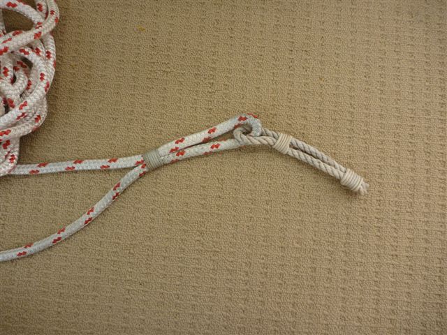

On Blue moon i have this set-up for the jib sheets, but im at a complete loss how it works!! anyone know?
Blue Moon's jib sheet to clew
TopHatSailing Mar2010 045.jpg (78.29 KiB) Viewed 8597 times
Could be some variation of this knot (the first one at top of page) :arrow: http://www.wayfarer-international.org/W ... sheet.html
I suppose im looking for a knot to replace the bowline(because i had one recently fail, that i spent a bit of time on to make sure i tied it correctly), doesnt snag on the shrouds & a knot that is easily removed from the clew to allow headsail changes, using the same sheets....

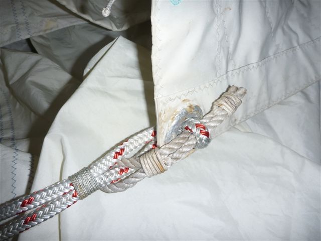

Postby Shaun » Mon Apr 19, 2010 5:40 pm
I guess that sheet connection goes something like this :ugeek:
Blue Moon sheets
TopHatSailing Mar2010 048.jpg (45.01 KiB) Viewed 8591 times
Anyone have this set-up, or used something similar...any pro's/cons?
ps, i always lead my sheets outside shrouds too.
