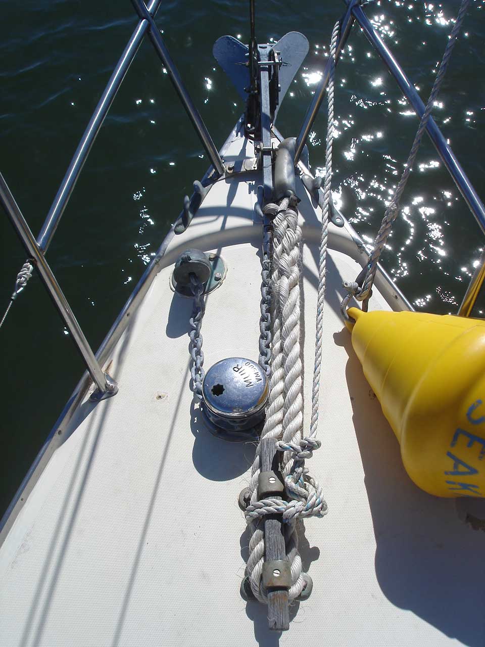

I have a Muir manual winch on the bow of Seaka.
I only used it a few times, during my recent trip north, when I found that I could not get my anchor up easily due to wind or mud. I found it hard to winch in the chain, but it did come in and once free of the bottom I retrieved the anchor in the normal manner. [Hand over hand!] It is slow and some strength is required if using the full sweep of a winch handle.
Seaka's Bow.
