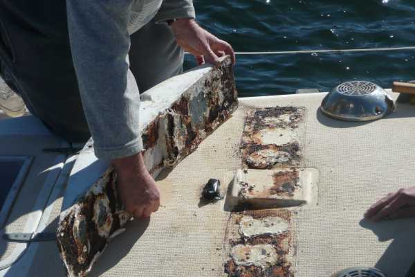

Here are some photos from todays mast removal. I wanted to remove the mast step because there was some signs of rust on the edges of the mast step, (Harbour Bridge). I was right, there was more.
Rust under the mast step.

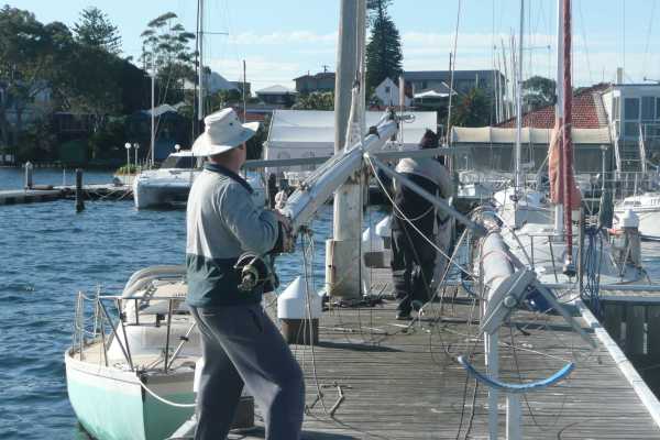

Also, here is the mast being removed with the mast crane. No sweat. I disconnected the wiring, applied penetrationg oil (Inox) and loosened the rigging screws the day before. The mast was out in under half an hour.
Mast removal using a crane.

Greg, interesting photo of underside of mast step. It would appear that the deck/coachhouse roof is solid and only way for water to penetrate would be via the holes (6 each side if I remember correctly)? Did the screws come out easily? Are they self tapping screws and what do they screw into? I imagine there was some sort of sealant between the harbour bridge and GRP? This is exactly the work (take harbour bridge and mast home and have new rigging etc made up) I will be doing next month, after july's antifouling job.

have another good close look at the photos. The rust is outside the screw holes! They have encircled the screw holes with sealant and it has kept the water at bay. The rust is where the water can get under the weldment section and sit. I thought it would have been the other way round. Someone has run a bead of sealant around the mast step, that was what I was going to do. I could only see a very small bit of rust on the edge of the section.
The screws were 1/4" Whit metal thread screws! They've got practically no holding power unless they were tapped in . They did come out very easily.

In the photos there is another mast that was removed at the same time. It was from a Clansman. It hadn;t been removed in 30 years. There is a crack in the base of the mast section caused by salt build up over the years. As the rigger was coiling the old stays the wires were splitting and cracking. If that's not a warning what is?
