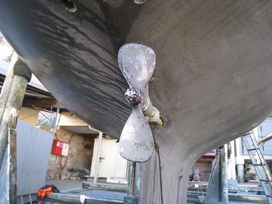

Below are a few photo's of Jilpangers rudder area sorry about the quality
