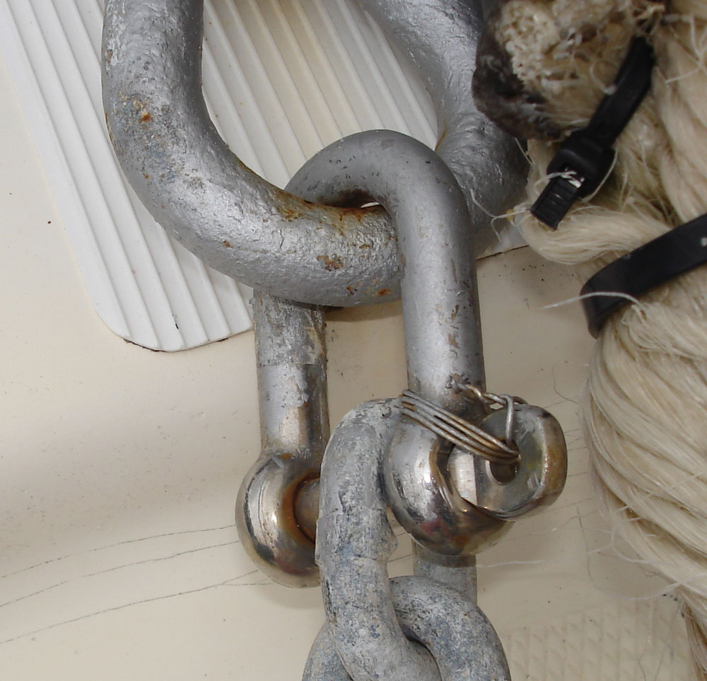

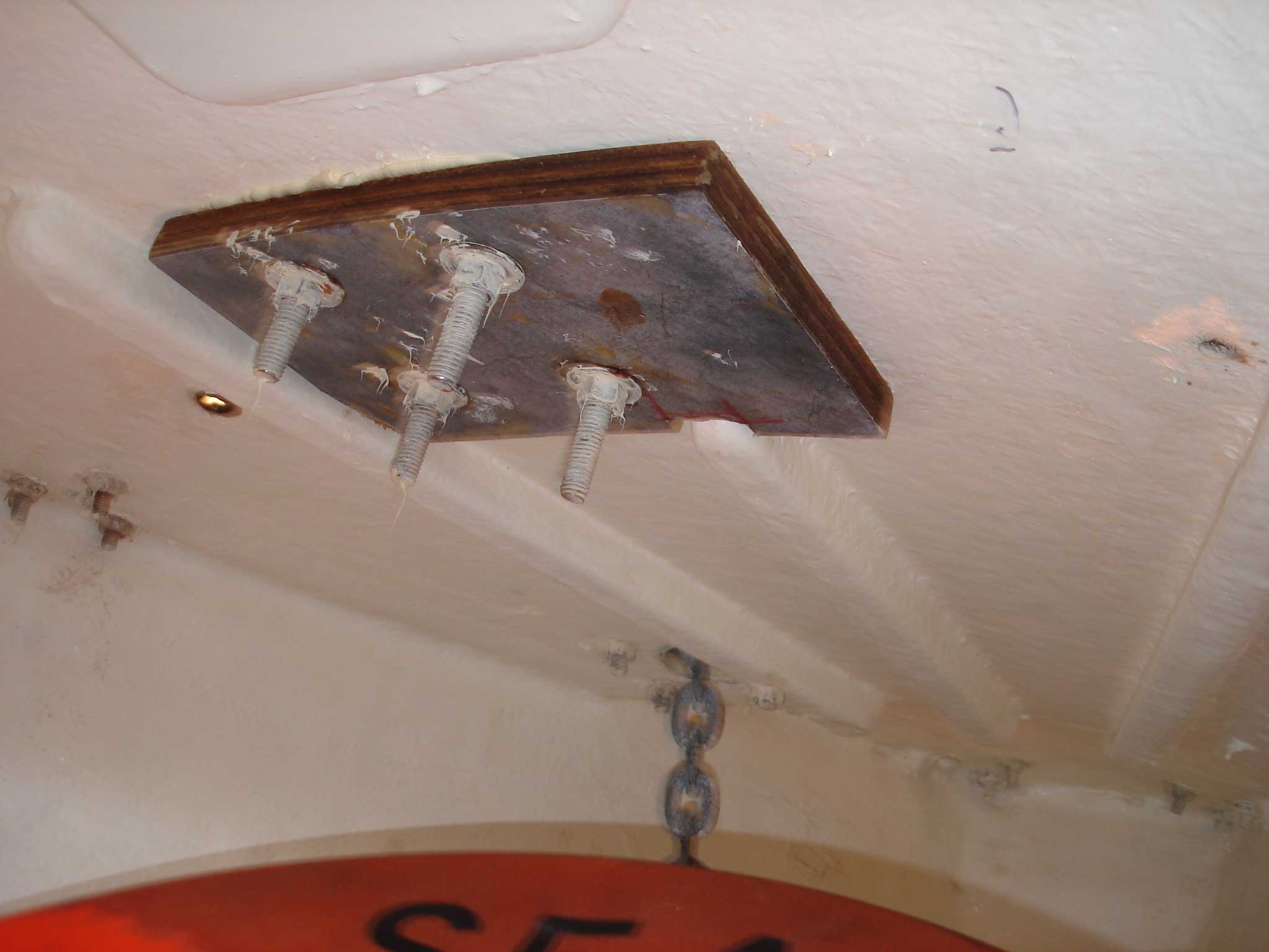

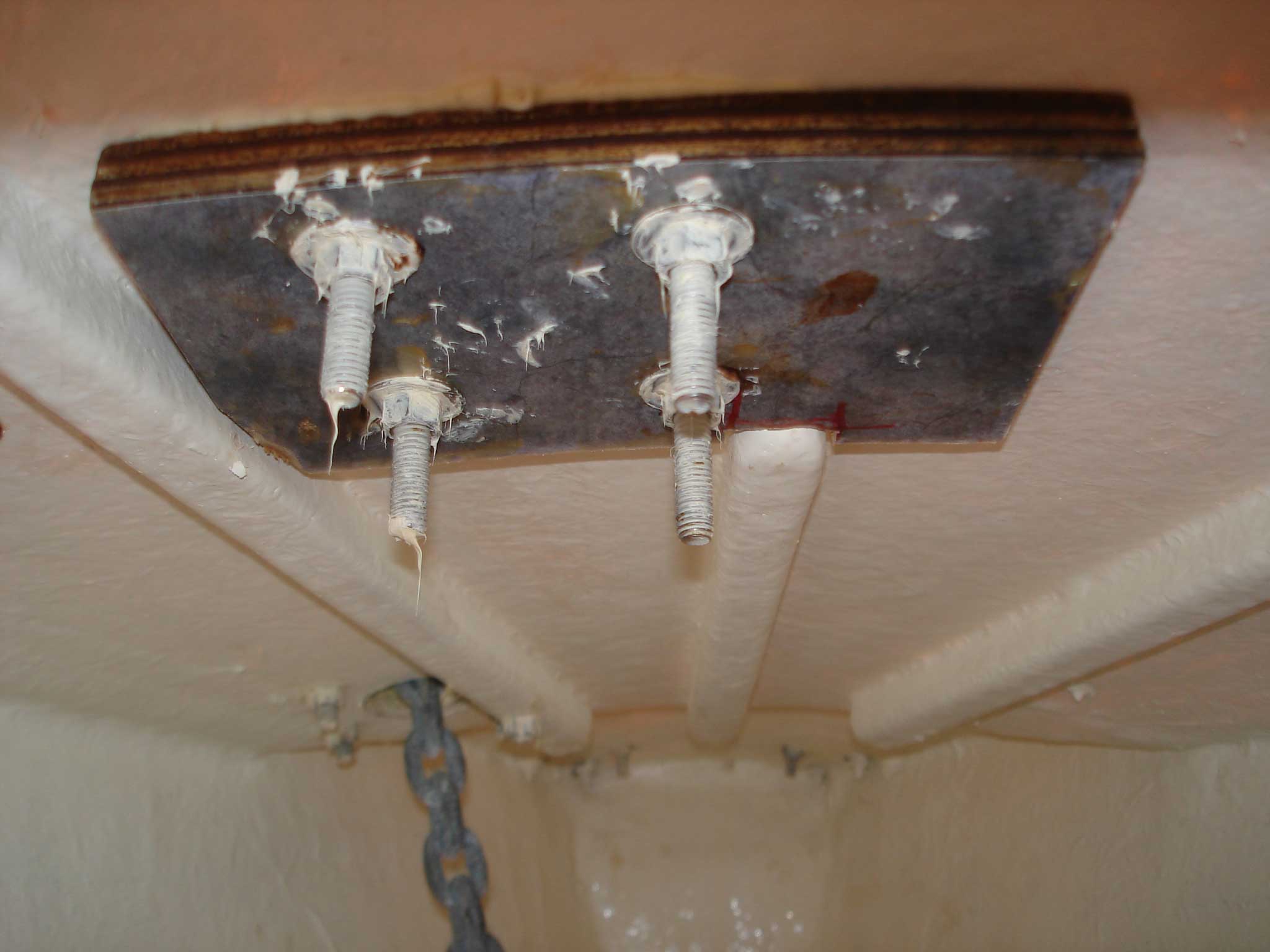

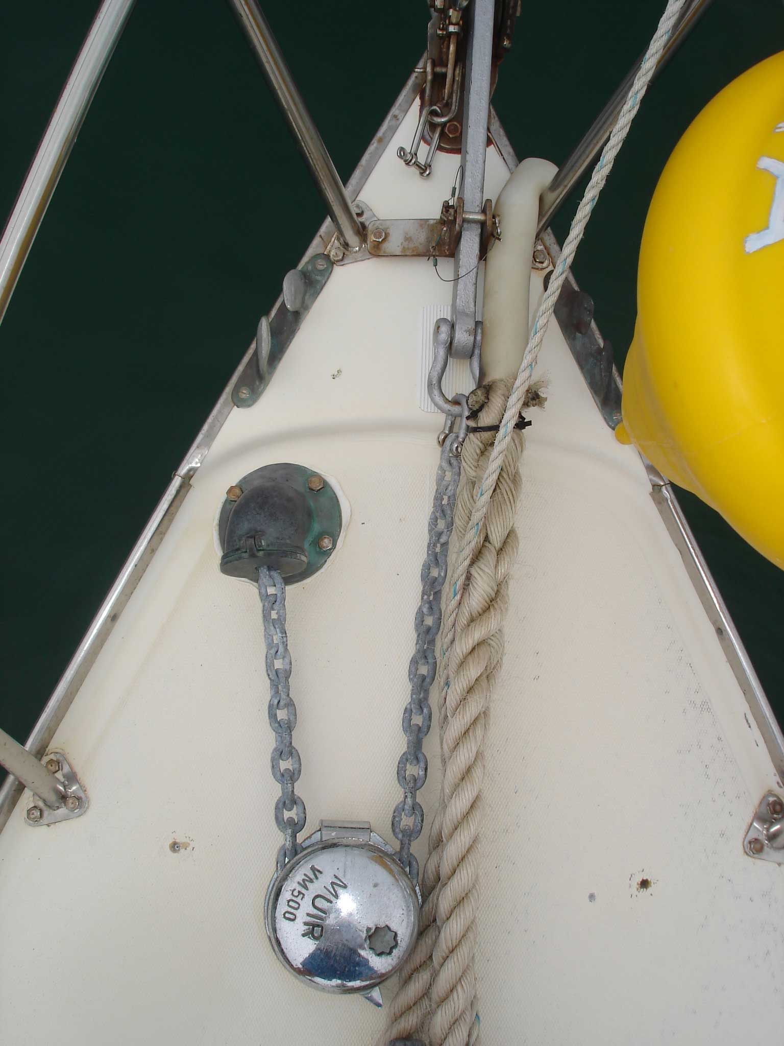

I've attached a photo of that mousing you need to do Diana and the backing pad to my windless. Note the location of the haser pipe in relation to the windless. I only needed to drill 4 bolt holes to mount it.
Windless backing pad
Deck layout
Mousing on anchor shackle

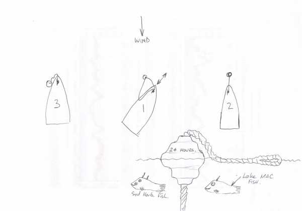

Postby Dolphin » Fri Jan 07, 2011 8:05 pm
Hi All, I hope this mud map helps.
Mooring Top Hats.jpg (9.25 KiB) Viewed 7898 times
The typical buoy is shown for a courtesy mooring. Some of them are just aircraft tyres like in broken Bay but the same problem exists. The boat gets blown back from the buoy and strain is taken on the mooring (2). All ok, then the wind drops the boat gets pulled towards the buoy by the springer chain on the bottom and hits the buoy (3) and it slides down the side of the boat bumping as it goes.
One way I was told to defeat this a bit is to take another line to the side of the boat (1) so there is more force on the mooring, the boat doesn't go straight ahead to hit the mooring and slides past it . As you said Keith it will sometimes still hit it.
Is there a way to beat this (and have a good nights sleep)?
I'm too old for this!
Thanks Philip for including the picture of the mousing.

Postby Phillip » Fri Jan 07, 2011 8:55 pm
Hi All,
Found one way to beat this problem, that is to actually lift the buoy slightly so that it will not drift back towards the hull. :D
Too good to be true I think as Top Hats do not have a bow sprit to enable this to work! :?
Any comments?

Can you please email me the photos of your backing plate to sealady@live.com.au
I can't print them out from here.
Thanks also for the mousing photo.

Postby TimothyH » Sun Jan 09, 2011 4:22 pm
Hello Greg
Re mooring buoys banging on the side of the boat; try carrying a short length (about 1metre) of electrical conduit, thread a second rope through this and tie off from the buoy to a point aft of the bow, this helps keep the buoy away from the side. The conduit also works aft when towing a tender, ie it stops the tender from riding up on the stern. A handy hint that works read some time ago in Cruising Helmsman!

Postby Dolphin » Sun Jan 09, 2011 10:02 pm
Thanks Tim, I'll play around with it and see if it works.
