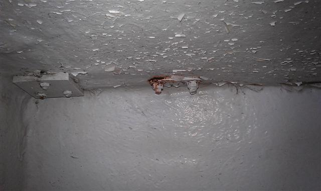

Back to the discussion. No matter what old boat you get, you still have to check the basics. After the standing rigging, the next thing to check is the chain plates. Crevice corrosion occurs when water is trapped in a narrow crevice, and differential oxidation causes corrosion. Loose the seal around your chainplates (U bolts), and the corrosion can cut through stainless steel like a knife. Take a look at this photo:
U bolt mount showing corrosion indication
IMAG0175 (Small).jpg (75.16 KiB) Viewed 10998 times
That rusty mark would make me check the U bolt for sure. The good thing about the Toppy, is that with three shrouds on each side, it is possible to carefully undo one at a time, with the mast up on a quiet mooring.

Not bad considering the K's this Top Hat has would have done over the years , would the manufacturer have created a stronger connection point there , by installing a flat bar to distribute the stresses provided by the rigging , it may have created less wear ??? .

I just re did my chain plates, took the aft lowers off first and then put it back on then the rest..... When you buff up the u-bolts and put new nuts on, reseal the holes its all good.

Chain plate U bolts I did Egret II about 10 years ago and found the U bolt is a high grade stainless and the nut is crap stainless . The stanchion packer I put stainless washers under the nuts also . The flaking paint you will find is what happens when household enamel is used instead of marine grade .
