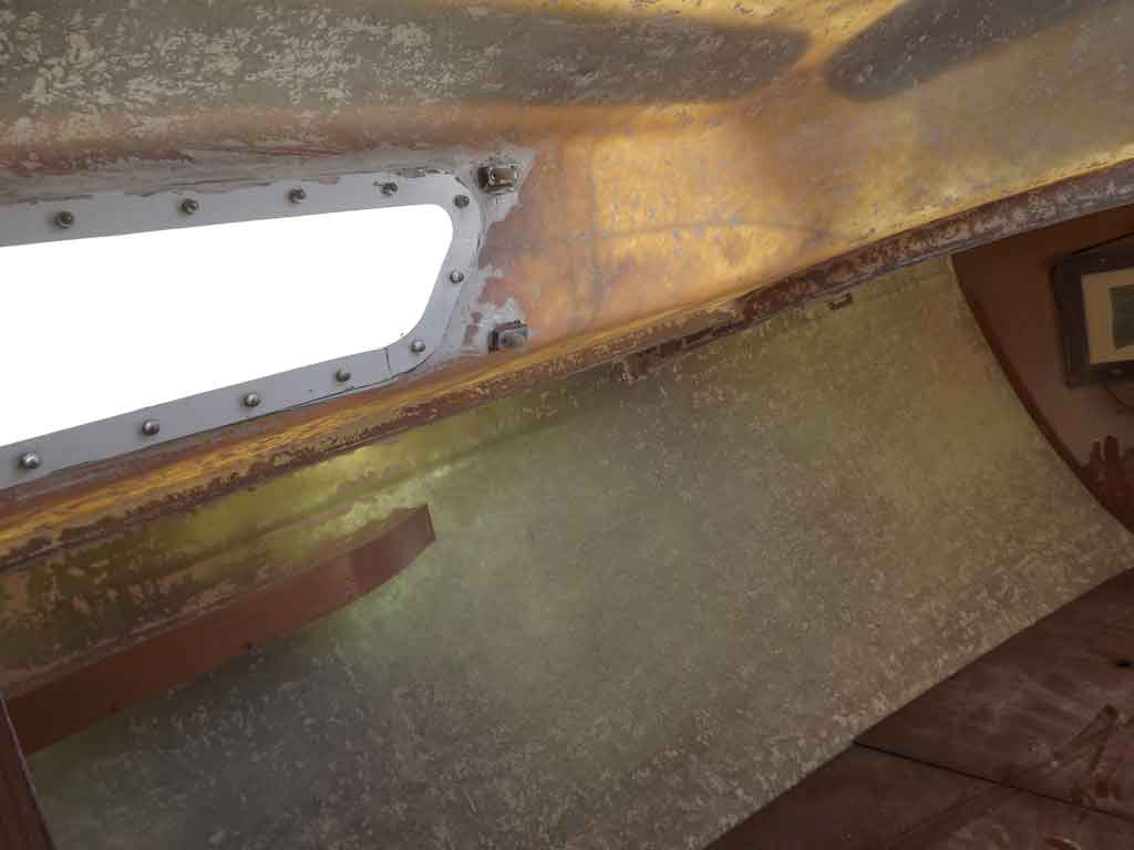

Postby Phillip » Fri Aug 16, 2013 9:29 pm

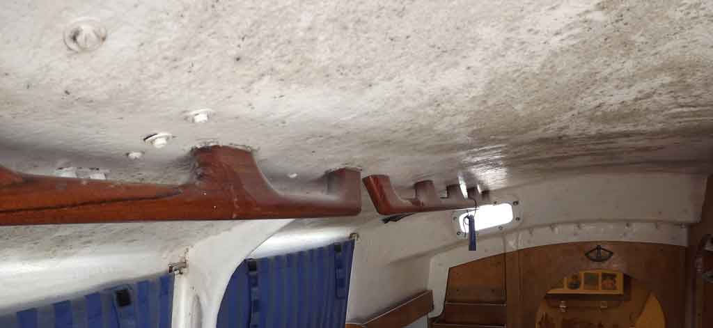

Still removing the old paint. At least two days to go!
Main cabin ceiling before removing old paint.

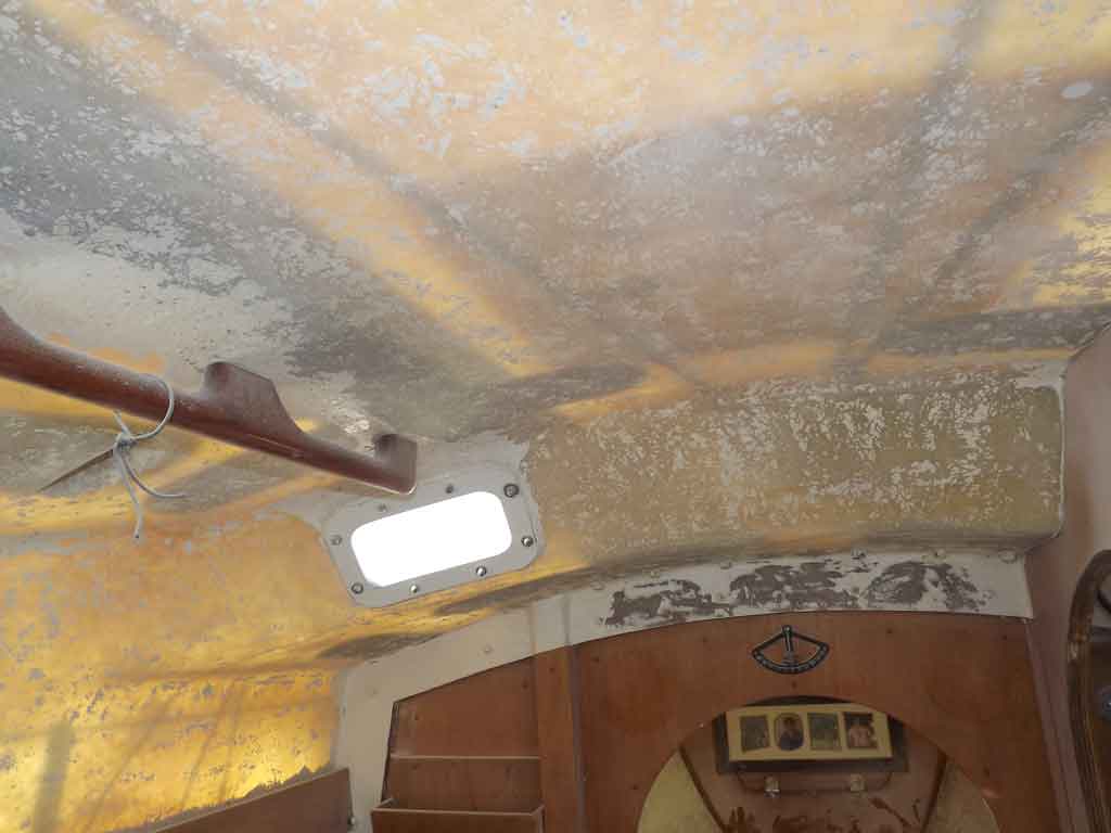

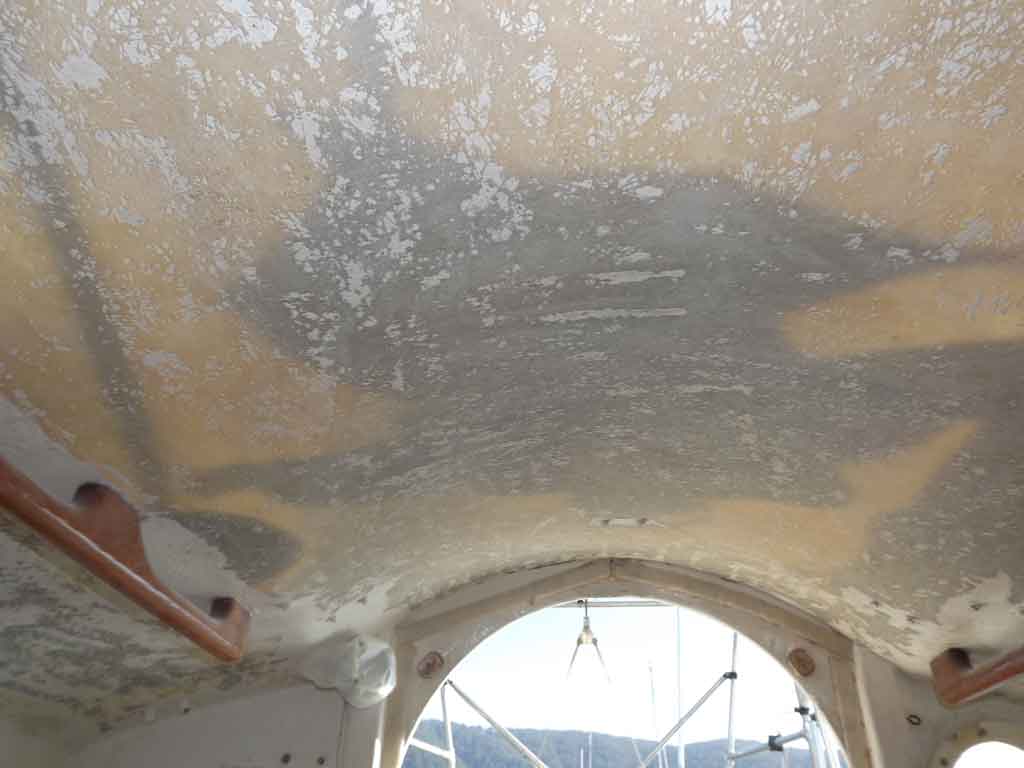

Stage 1 removal of old paint in main cabin looking forward.
Stage 1 removal of old paint in main cabin looking aft.
Stage 1 removal of old paint in forward cabin looking.

Phillip, that is very impressive! What are you sanding with?

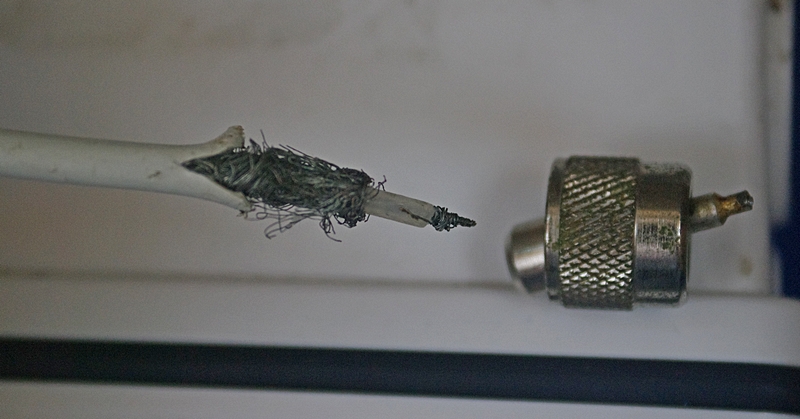

There seems no end to the list of things-to-do to Windchaser. Today I put the new fitting onto the vhf radio. Followed the instructions downloaded from the GME website. For soldering I used a 240v soldering iron via a 300 watt inverter clipped to my battery. Worked well.
When I bought Windchaser, the radio seemed to be working but I found it was only working some of the time and then not when I needed it. Eventually found this:

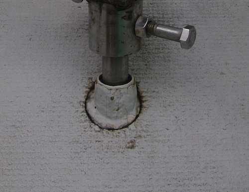

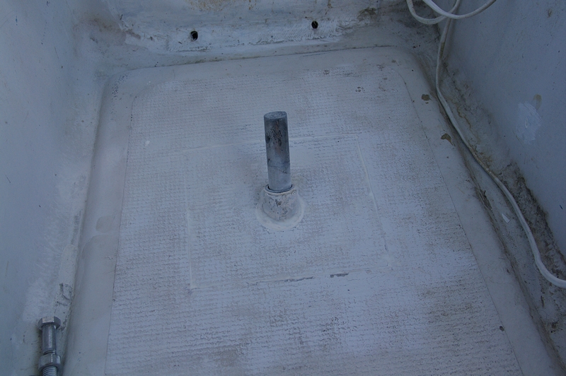

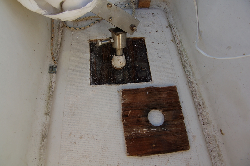

Another job I finished on Windchaser today was the hole I cut in the cockpit. A month or so ago after some rain I noticed when I stood near the rudder shaft in the cockpit, a little water squeezed up. Hmmm, not good. I drilled several holes through the top layer of fibreglass into the wood core to check . . . . The drill brought up wet wood. :(
Using a multitool plugged into my 750 watt generator, I cut out a square of fibreglass and used screwdrivers and a chisel to lever it up. Left it to dry for several weeks. Lucky it was the dry season.
When dry, I poured in epoxy resin with wood rot killer (Botecote + TPRDA), worked it into the cracks and gaps. Probably used two cups so it was going in a long way. Put the fibreglass square back on top and used fairing powder in the epoxy to fill the gap. When set, I used an attachment in my drill, it is a bit like a wheel with red tough string, not wire, and it is hard enough to sand the fairing off but soft enough to not wear much of the fibreglass away. So most of the rippled surface that got fairing mix on it cleaned up nicely.
