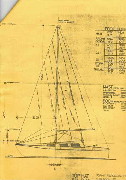

The dimensions of the storm jib are;
Foot, 2438 (8ft)
Luff 5029 (16' 6")
Leech 3505mm (11' 6")
That's from the original TOp Hat plans
Sail Plana.jpg (23.79 KiB) Viewed 7377 times

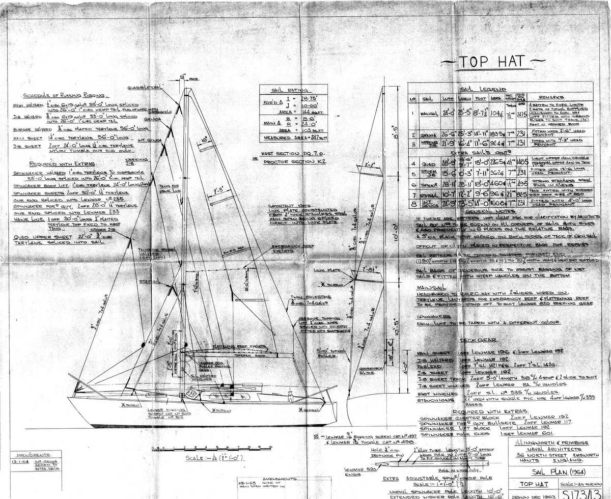

I know you are trying to wind me up ? Have a bow peak at the plan date ! Here is the original Top Hat plan and only in imperial measurements , give me a break !!
Your mate Bear

Bear HELLO welcome to the 21st century.
THey are the specs for the Mk3 !!!
AND while you've been dreaming, we've gone metric !
Also that is for a wire luff not for a furler which may be adjusted.
Mark, putting a deep reef into a sail is not good for the material. The material in a storm main or trisail is much heavier to withstand the load. That is why most sails only have 2 reefs.
Your splitting hairs Bair. (MK3 measurements in Brackets)
Luff 15' 6" (16' 6")
Foot 7' 11" (8")
Leech 10' 3" (11" 6")
That is why Mk 1s look pretty sitting on moorings and Mk3s are the fastest.
