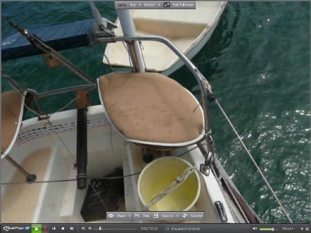

Postby Dolphin » Fri Feb 04, 2011 11:49 am
Here's a pic of the panel and seats taken from a video of a seal swimming under Felicite.
Felicite Seats n Solar panel a.jpg (198.97 KiB) Viewed 9615 times
Hope it helps

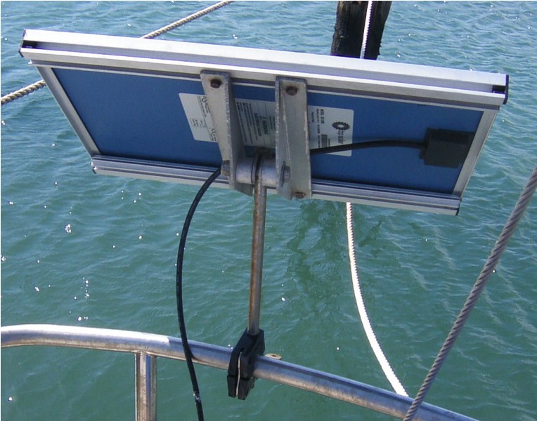

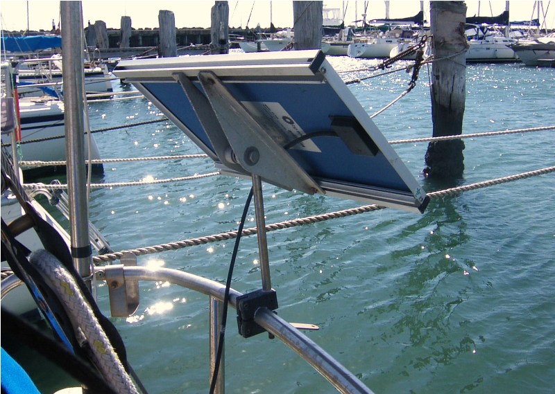

Postby Tales » Fri Feb 04, 2011 1:41 pm
The setup on Tales uses a barby mount bracket from Whitworths and a couple of aluminium angles trimmed to size.
Mounts onto the aft pulpit but is easy to remove and reposition if we want to use the boarding ladder on the transom.
It will also mount onto the stanchions if needed when the normal spot is in shade.
Easy to swivel and keep in the sun when sailing but it's not a very big solar panel.
SolarBarby1 (2).jpg (156.37 KiB) Viewed 9612 times
SolarBarby2 (2).jpg (117.81 KiB) Viewed 9612 times
