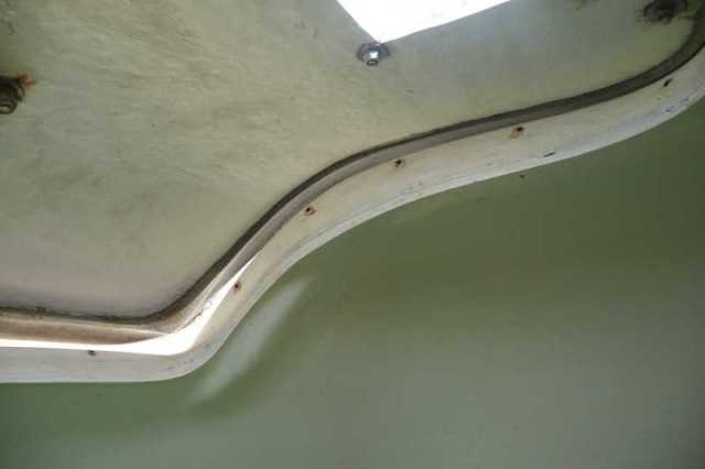

Postby Dolphin » Fri Nov 26, 2010 9:27 pm
G'Day Dennis,
here is a photo of the forward hatch seal on Felicite using the dust sealing tape. AS you can see it conforms to the shape of the hatch pretty well. This was put on in the early nineties and probably needs to be done again as it is prone to creep around corners. It would be better to cut it and butt but that may produce a gap that can leak.
I hope that helps.
