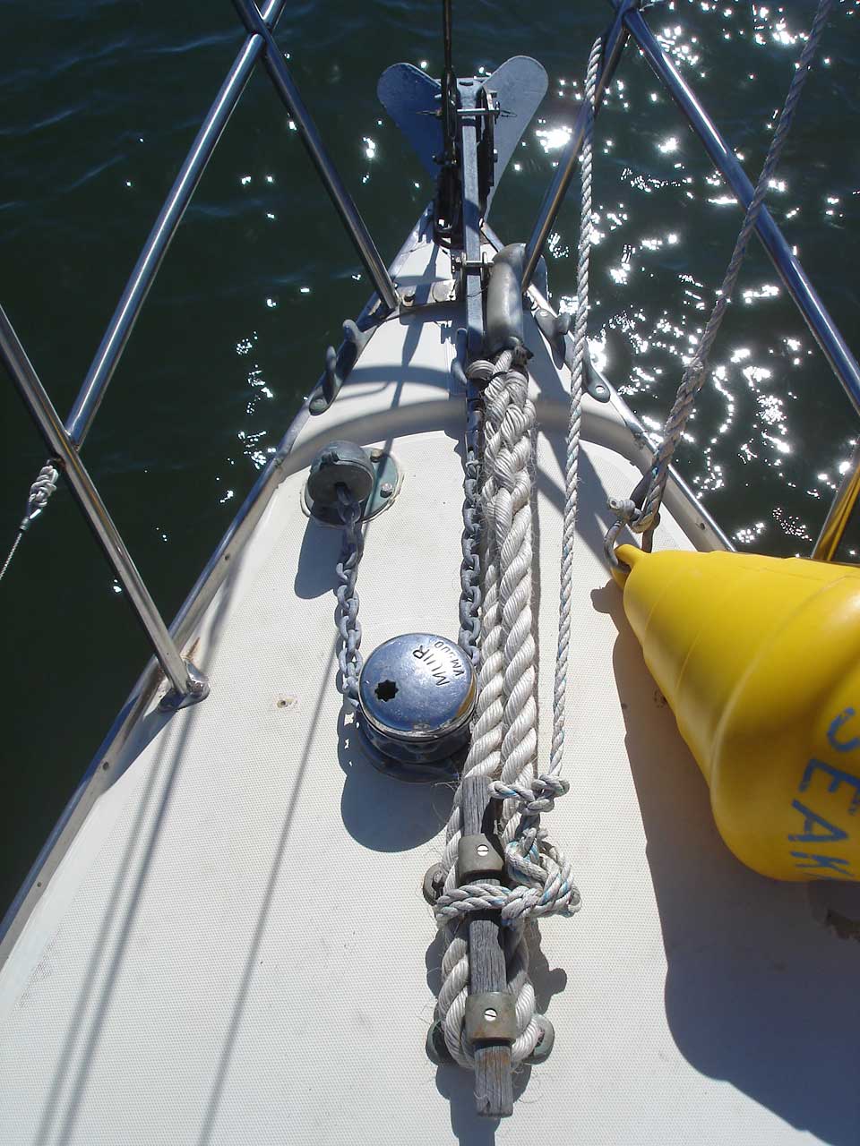

I installed a Muir hand winch (it was a hand me down with a story :cry: ) on my Mk1.
Seems to be OK but have not used it yet in a mooring situation
beause of the currents in our river and being a solo sailer.
I had to move the hawser pipe to allow the chin to enterthe forward locker.
Also placed a angled guide to ensure the chain dropped correctly.
I also extended the roller guides so that the anchor was held tightly but clear of the fibreglass bow.
Photo attached.

HI Karl steriods option thats up to you.I would like to think when that 25knt change hits with 2.5 mtr swell pushing you on shore at 12 midnight happens.I hope to start the diesel and motor in to it and let the winch do its job and git out of there.I installed a new Muir but you must consider battery power without a diesel.and price. next time you are in brisbane call in i am just of the gateway boat still on trailer in shed in back yard. cheers brett
