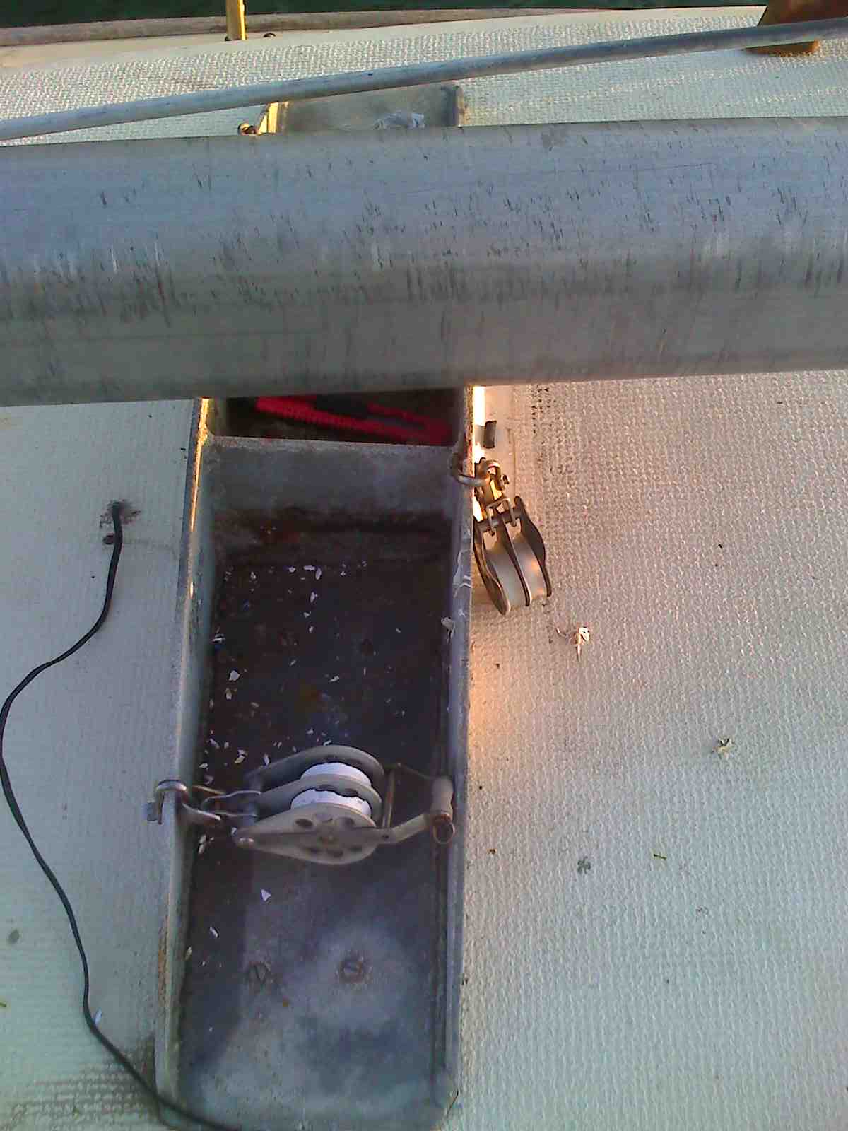

Michael, pic attached shows the vang block and where i attached the reefing block as discussed in our email (taunto not sure if the screws in this pic are what you are referring to ?? )

I got a pic so it may be easier to explain.
The harbour bridge hasn't moved, it's just the mast rotated slightly in the fitting as Dan (auriga) said.
In the pic, see the circled turn block. This is the halyard block and is attached to the mast itself, same as the headsail halyard. All the other blocks are shackled to the bridge, including reefs, vang, spinaker and topping lift. I will move the block from the mast, but as you say, I may have to have a rigger look at it and check out the foot properly.
So, I don't believe it's dangerous, just perhaps not right and will get another opinion from a professional rigger.
