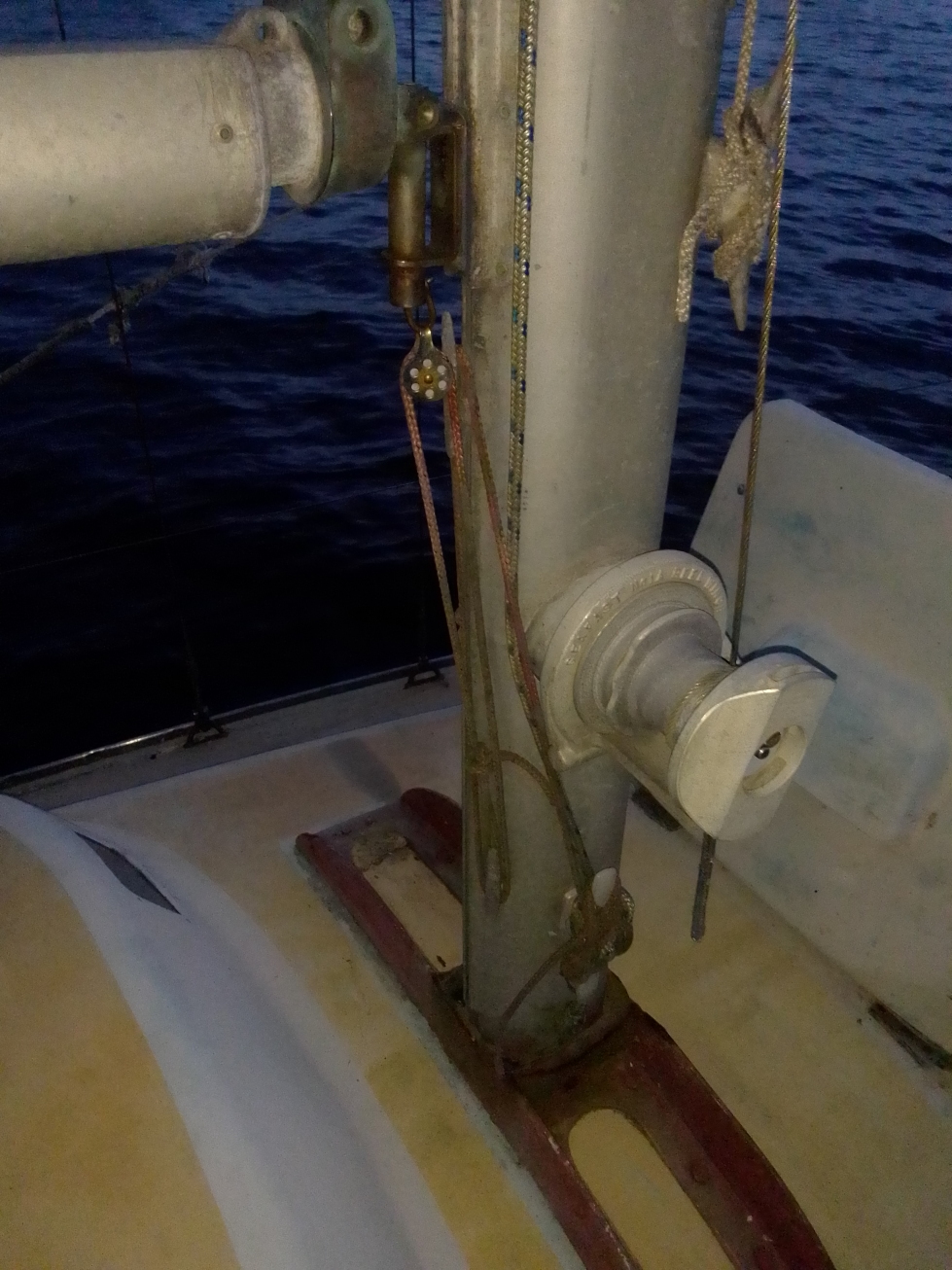

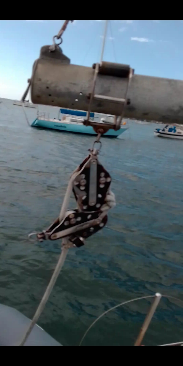

Hello chaps, may I get your advice? My Mk1 has a floating boom (the gooseneck runs in a vertical track a few inches long) and a downhaul instead of a vang. It also has no traveller. I know several Mk1s have no traveller, was this Illingworth's design, or was someone trying to save a few quid when setting up the rigging? All my mainsail controls go to cleats on the mast and boom, there are no lines going back to the cockpit. The only cockpit controls are the two winches on either side and a cleat beside each winch. Can anyone suggest why the vessel was rigged this way? I intend to set up the boat for short handed sailing soon, any suggestions would be welcome. Thank you chaps, cheerio!

Small block under gooseneck just looks like a downhaul, a Cunningham if you like for the unreefed mainsail.
I'd suggest ou definitely need a vang, particularly if you don't have a traveller.

Thank you Captain, shall add a vang and a traveller asap, I'm just kinda baffled that this boat's gone fifty years without a vang. There are definitely no holes on the underside of the boom, no evidence it's ever had a vang. Oh well, life is full of mysteries. Best wishes chief, Cheerio!

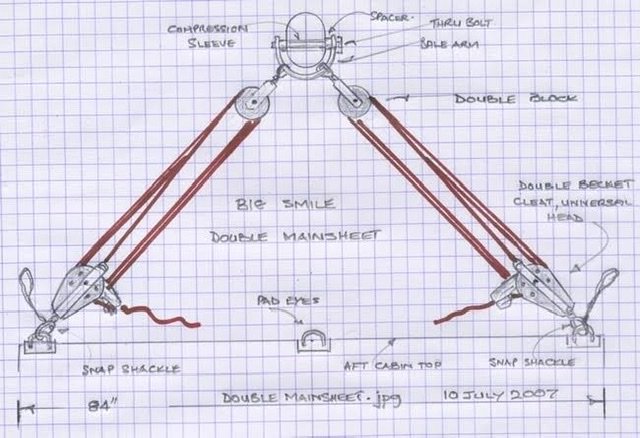

Some yachts use a double mainsheet. One going to either side of the cockpit to alleviate the need and intrusion of the traveller.
Maybe worth looking into.
The guy from the YouTube channel, “Learning by Doing” makes the change and gives an explanation.
https://youtu.be/LvMVMoS4btY (3:26 min)

Postby Wild Rose » Sun Dec 13, 2020 12:40 pm
Looks like your boom was set up for "Roller Reefing" the main. I say "was" as it looks like it cant now.

Postby Phillip » Sun Dec 13, 2020 2:44 pm
Wild Rose wrote:Looks like your boom was set up for "Roller Reefing" the main. I say "was" as it looks like it cant now.
Spot on Dave, now you mention it. it's obvious :D :D

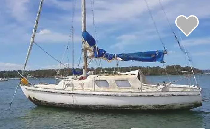

Thank you so much chaps, that's a tremendous help. My boat is nearly a thousand miles away, so I can't get to it for a few weeks. It looked like this when I bought it:
Top Hat 11 Dec 2020 original condition.jpg (60.91 KiB) Viewed 19160 times

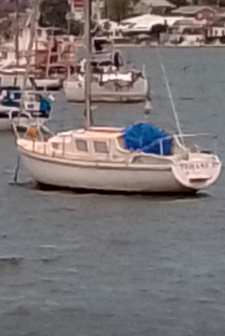

I took down the flag when it was dark so I didn't get to examine anything, but by the next day the vessel had slightly improved to this:
Top Hat improved Dec 2020.jpg (94.52 KiB) Viewed 19160 times
The original owner passed away, and his son sold her to me, he knew very little about her. Shall have the little blighter sailing the moment I have two cents to rub together.
