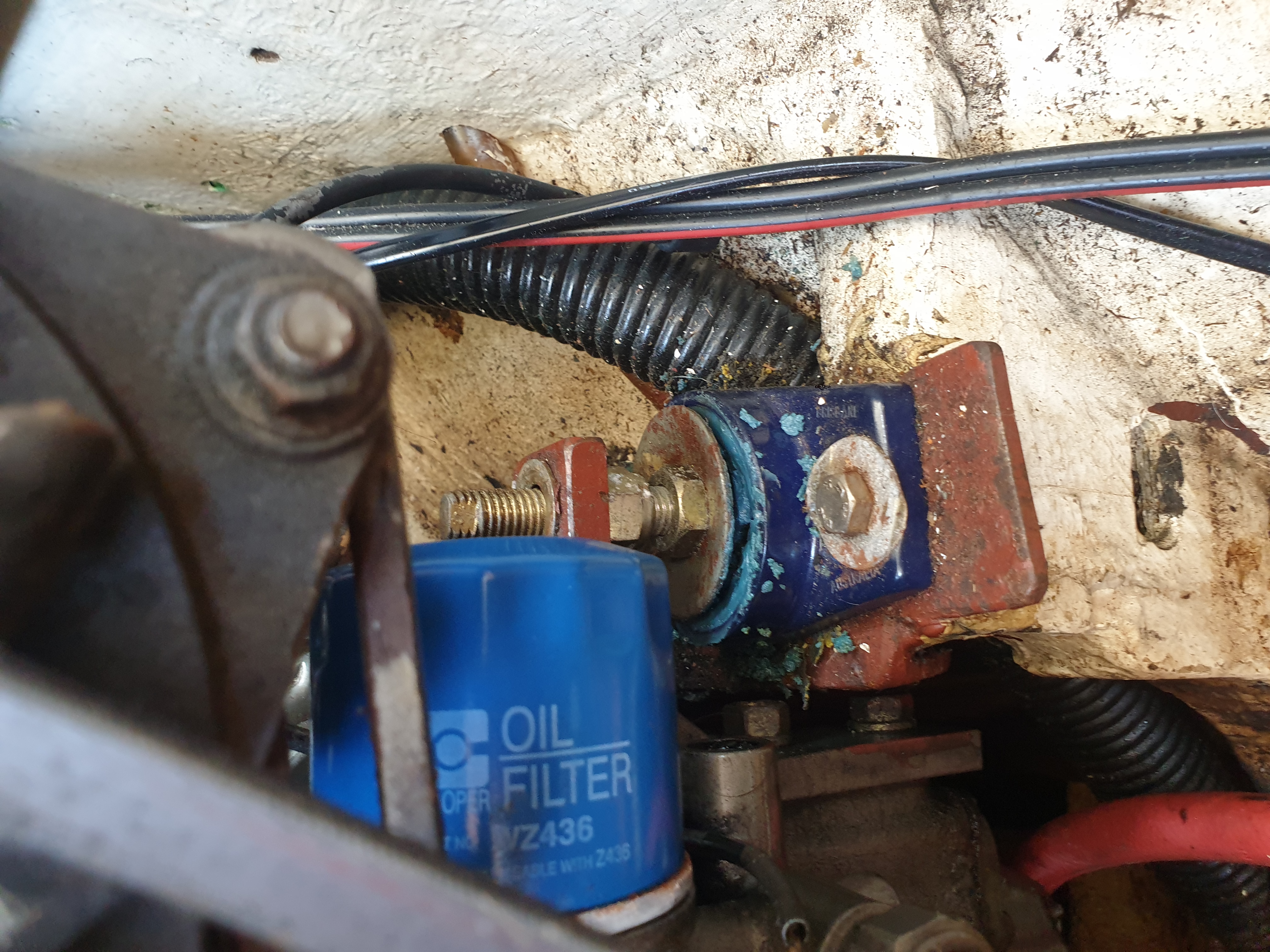

I have an inboard yanmar 2gm 15hp and the rubber inserts in the engine mounts are gone. I'm wanting to replace them and just wondering if anyone has had any experience with doing this.
I have cracked all the nuts and am wonder if I will need to disconnect the shaft from the back to be able to lift the engine over the mount bolts.

I have managed to free the shaft from the engine. This is not a fun job at all... got three of the 4 mounts off the last one is being a prick of course :lol:

Yes the gutless bearing does need replacing but as you can see from the photos the rubber inserts seem to have almost melted. I'm not sure when they were put in last but it could easily be between 5-10 years. It didn't have a polyflex connector. I did notice that there was only 3 bolts on the shaft to gear box connection that should have 4 and they were pretty much finger tight which is a worry! Do you think this may have a effect on the general wear of the rubber?
