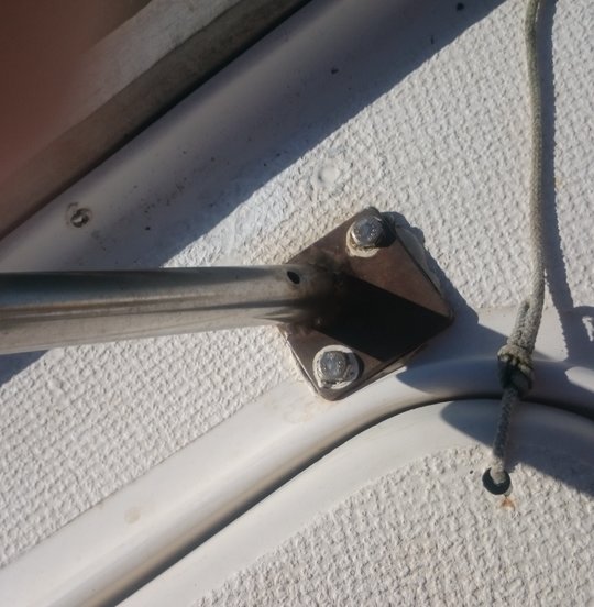

You are right to weld new, larger, feet onto your pulpit.
The pulpits of the style you have are made from tubes with thin walls. Their geometry allows them to be made for thin wall tube and still accept the tension of the lifelines but they are quite flexible and the flexing makes it difficult to prevent leaks where the fixings penetrate the deck.
Rather than welding the new feet to the old feet, it would be better to cut off the old ones. Some pulpits (mine included) have failed where the foot is attached to the tube, presumably due to corrosion within the tube. The same failure has occurred at some pushpits, but so far mine has been all right.
Whether you need fiberglass platforms will depend on how closely the new feet align with the curvature of the deck. I suggest that you get the feet welded on first, then make platforms from epoxy filler and sit the pulpit on them before the filler sets (with polythene sheet between the filler and the feet so they don't stick together). When the epoxy is set, remove the pulpit and then refit it with butyl tape or other sealant.
For the two forward feet, rather than have a separate foot on each, I had a strap (about 40 x 6 mm) welded between them, with fixing bolts through the strap. The strap needs to be bent before welding so that it follows the curvature of the deck. This brings the fixing bolts further inboard than the original, and maybe easier to fit the nuts and backing plates below the deck.
For the aft feet, I suggest that the feet should not extend outboard beyond the original, to avoid having to position the legs further inboard than originally. If using three fixings for each, you should consider where the nuts and backing plates will be installed in case they clash with anything below the deck. Three fixings for each sounds excellent, but I only used one and have had no leaks during the fifteen years since I did it.

PostPosted: Wed Jul 10, 2019 9:38 pm
by steve
Hi Dan,
I was on my boat today so I took a couple of photos of the feet. The aft feet have two bolts each, not just one as I previously said. The strap which forms the feet on the forward legs is held in place by the two bolts you can see. The shackle is there just because I find it useful to have an extra point to attach lines to.
Steve
