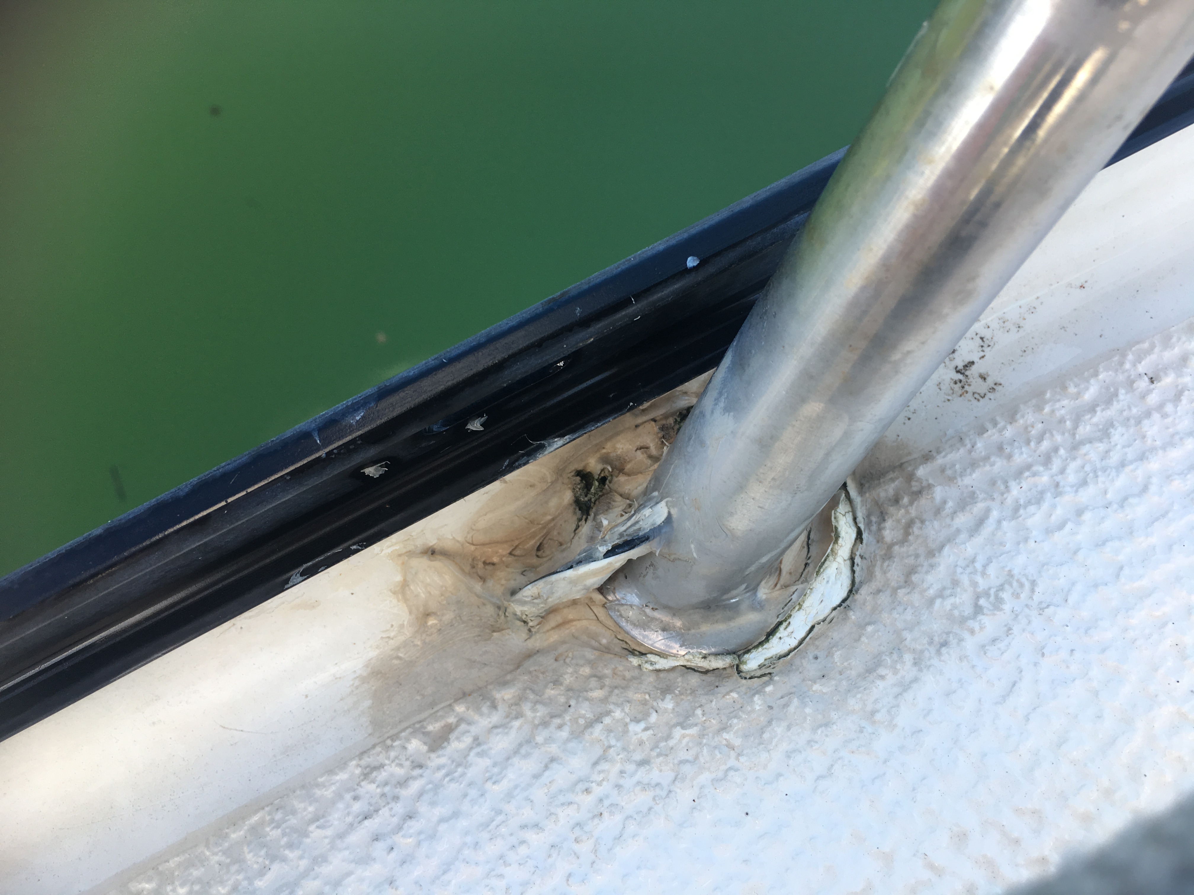

I went out to my boat today for a couple of hours looking for leaks.... (it's so good to have the boat just 10min down the road)
To start the process I've decided to do it in sections and start with everything in and around the v-berth as I've got most problems in that area and literally everything is wet.
There are 2 stanchions and 4 fittings for the standing rigging. Surprisingly they are all good an nothing is leaking there.

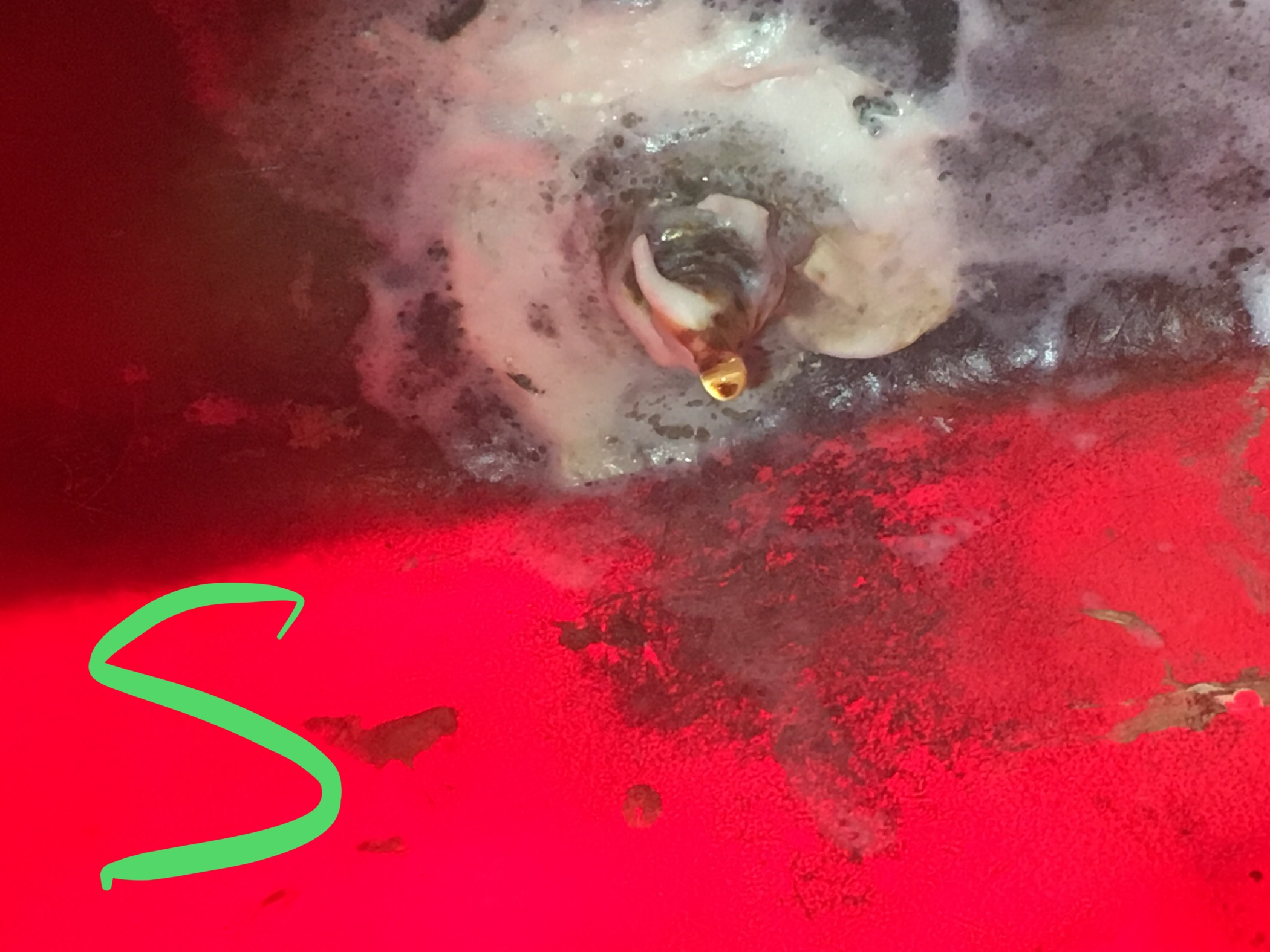

But the four screws that hold the bow pulpit are all leaking like no tomorrow. I even noticed an arrow and "leak" written with a sharpy on the inside of the hull by one of the previous owners. Well, they didn't fix it - its still leaking.
Now I want to tackle that with a matter of high priority. How should I go about it.
I am considering to take the pulpit off, fill and glass over all wholes and glass some 'platforms'. Then I would make some triangular shaped stainless plates with three holes each and weld them on the pulpit feet. Then drilling new holes though the deck where the plates fit the platforms and fitting them with butyl tape.
Does that sound like a good idea? Or is it overkill to glass platforms and weld plates on the feet?
In the same run I'd like to deal with the cracks in the gelcoat and the hinges of the anchor locker and some other issues in the gel-coat.
Do you have any suggestions?

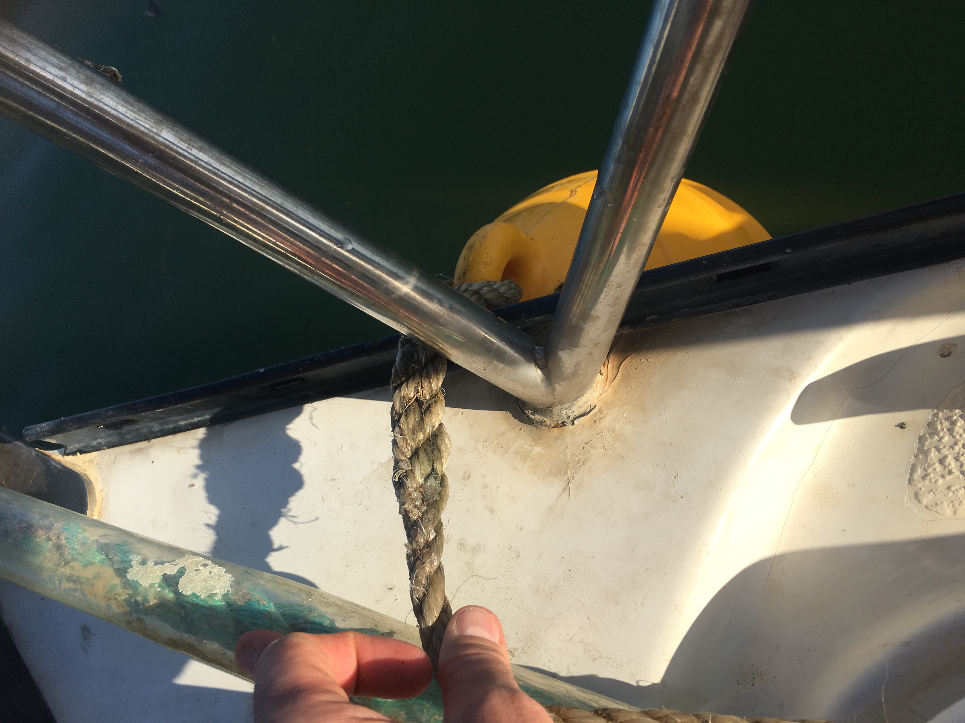

Re: Getting „Stellar“ dry....

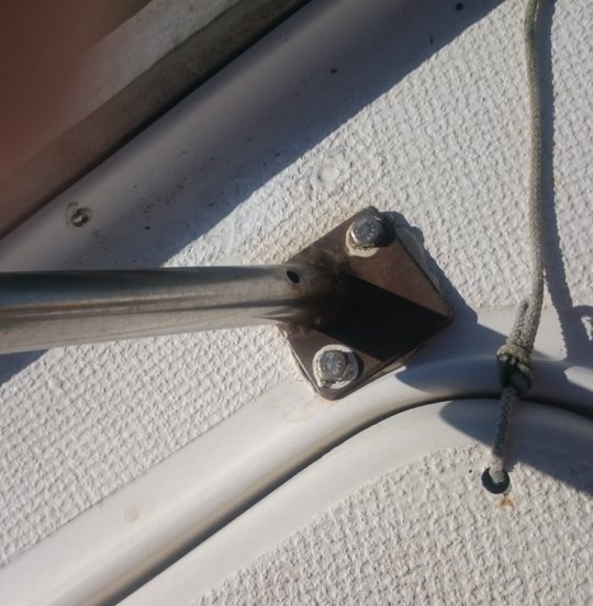

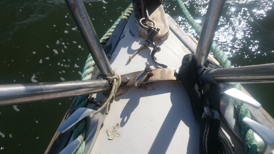

Postby steve » Wed Jul 10, 2019 9:38 pm
Hi Dan,
I was on my boat today so I took a couple of photos of the feet. The aft feet have two bolts each, not just one as I previously said. The strap which forms the feet on the forward legs is held in place by the two bolts you can see. The shackle is there just because I find it useful to have an extra point to attach lines to.
Steve
