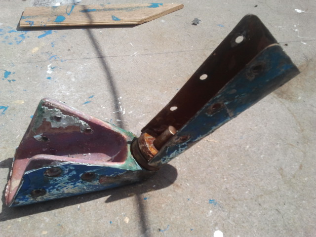

I am currently getting my shoe and keel bearing rebuilt.Does anyone have and suggested sealer that i shoukd use when i refit the shoe and bearing?
I also have a million questions about the bearings in the top end of the rudder tube and the removal of said bearings.
Any help and advice greatly received.
Cheers.Dave

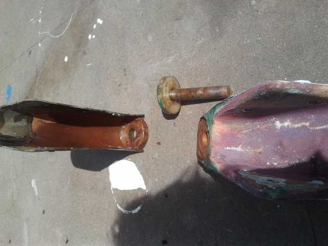

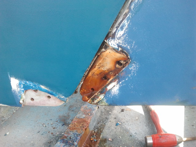

Hi Phillip.The stainless pin in the shoe had become loose over time and had flogged out the tolerance fit hole in the shoe and also the stainless bearing on the rudder.Im not sure what to use when i refit the the shoe to seal it back up.

Do you mean to seal the rudder shoe and bearing to the fibreglass? The Mark III shoe drawing in the gallery shows that the shoe was set in polyester putty. That is probably the best material to use again. Epoxy would probably adhere too well and you would never be able to get the shoe off again.
I was not able to remove the shoe when I tried many years ago. How did you get the polyester putty to release its grip?
For sealing around the bolts, Sikaflex might be best. My bolts (stainless) were corroded to half their original thickness.
Thanks for posting those photos - I had wondered what was attached to the bottom of the rudder. Is the metal disc simply welded to the bent sheet metal? Any sign of corrosion or weakening of the weld?

About 2 years ago I replaced the threaded rod that holds the shoe in place. I used 8mm stainless steel rod and nyloc nuts. The old rod was corroded and reduced in diameter. I used rod and not bolts, because rod had previously been used. I could just as easily have used bolts. There was no evidence of any kind of sealant and I got the impression the holes in the keel and rudder were drilled out of solid material and did not need sealant. Maybe I should have used sealant.
The part that bolts onto the rudder is stainless steel, whereas the part that bolts onto the hull is bronze, so I used Duralac here. Both these parts looked good. The thrust washer (probably Vesconite) that slips over the SS rod looked good.

Everybody is on the right track. I removed the bottom shoe etc some years ago and found that the bronze pins were Ok but as I had damaged them while removing them I replaced with SS threaded rod. All were reset in silaflex to protect the SS. From what I've seen I'd replace the SS every 5 years or so, do one at a time, no need to remove the shoes.

Steve my shoe came off relatively easy and I have since re-read the notes on the drawings and as you suggest they were originaly set in Polyester putty.
The female rudder bearing housing is made of stainless with the stainless bearing section welded in.

You say SS bearing. I believe there should be a engineering plastic bush (Vesconite/PTFE/engineering plastic incorporating graphite/Nylon/whatever) on top of the 'bearing'.

Correct Killick.My explanation wasnt the clearest.There is the thick nylon type washer between the 2sections.
