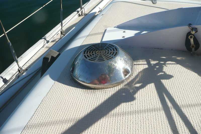

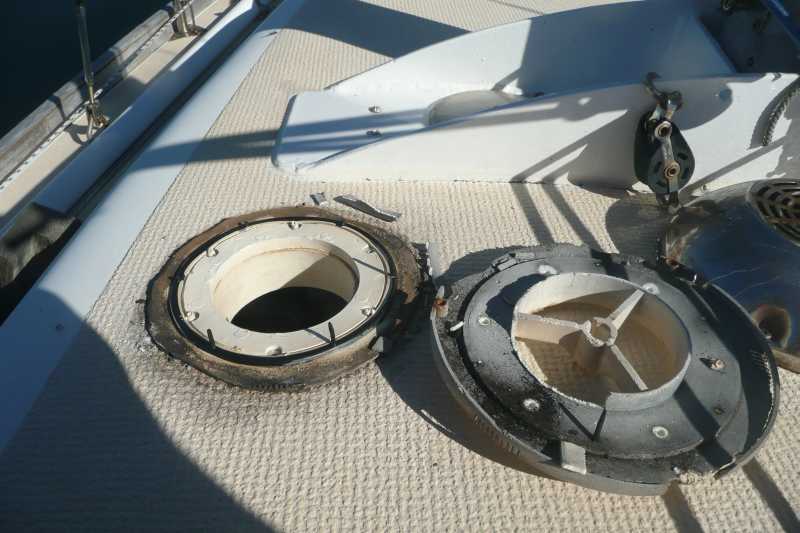

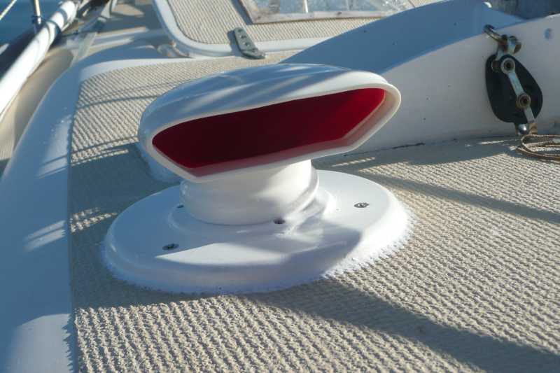

Postby Dolphin » Wed May 09, 2012 8:38 pm
G'Day all,'well I eventually got around to replacing the standard stainless dome vent with the model shown in the photos. Seems to work well. The advantage is that you can swing the galley vent forward and the dunny vent backward to get cross ventilation.
I hope I didn;t replace the vents too soon. I think they were past their "use by date".
Existing vent
The finished job.
It just fell apart!
