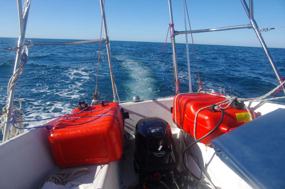

I tie down my fuel tank to the side. Even if the water seems calm when I am about to set out, I still throw some loops of rope about the tank (or both if using both) to make sure they can't go anywhere.
fuel tank 2.jpg (537.47 KiB) Viewed 8046 times
