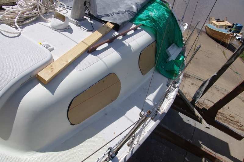

Before coming up on the slip, I removed the windows on one side and took them to the plastic place to inquire about replacements. There was only clear or smokey to choose from in acrylic (perspex) so went for smokey. Was quite cheap, $160 and only took a couple of days. I had covered the windows openings on Windchaser using duct tape and plastic sheet. Had a shower of rain so I was pleased I had done so. Then I realised I had water in the bilge and it could only have come via those windows, so I don't think the duct tape was much good. Plus, it left sticky stuff on the boat which happily came off easily with metho.

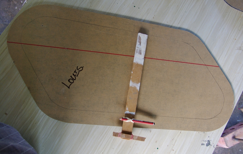

Set a pencil on a piece of wood the exact distance the windows overlapped the boat. Ran a line around the window.
window 01.jpg (326.46 KiB) Viewed 9762 times

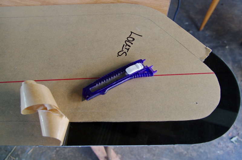

With very little pressure, marked the paper along the line and pulled it off.
window 02.jpg (342.82 KiB) Viewed 9762 times
Sanded the exposed section using 180 grit until it was evenly abraded. Wiped with metho and a clean cloth. Surface was now a uniform dull black. I added masking tape around the edges and cut to shape.

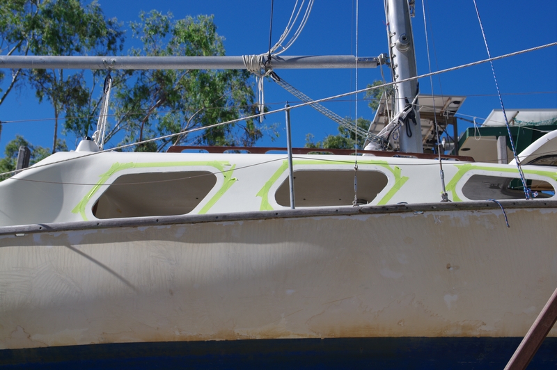

On the boat, using my pencil-on-stick, I made some guide marks on the window surrounds, taped it up, used the pencil to mark the lines and then trimmed the tape. Sanded the exposed section to make for strong holding by the sealant.
window 04.jpg (366.73 KiB) Viewed 9762 times
I made a mistake as it would have been better to have added maybe 5 mm to the measure so there was space between where the window touched the boat and the tape. As it was, the window sat against the boat inside the space marked by the masking tape but it was snug. This meant when I was actually placing the window on the boat, it was not perfect to the mm which meant some of the masking tape was under the window a little bit.

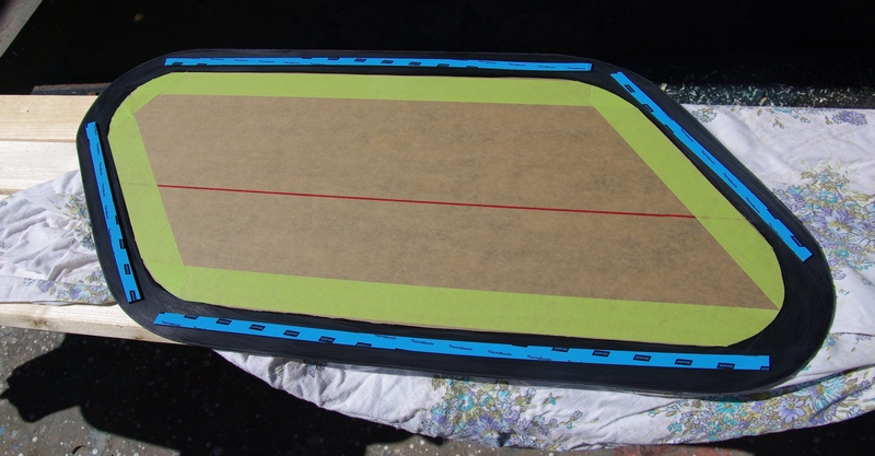

Using Fixtech Fixsil FS 200 http://www.nauticexpo.com/prod/fixtech-marine-solutions/silicone-adhesive-uv-resistant-37358-284106.html I followed the directions. Squeezed a bead around the window and NOT over the double-sided tape. Using a paint scraper, spread the sealant in a thin layer over the acrylic sheet. Then put higher beads all the way around. Carefully took the paper off the double-sided tape and even more carefully placed the window in position. In fact, before putting any sealant on the window or activating the double-sided tape, I practiced placing the window where it should go.
The window immediately and solidly stuck in place. I then squeezed sealant around the window to fill up the remaining gap. I had disposable gloves on, used my finger to smooth the sealant. Immediately pulled off the masking tape leaving a nice edge.
