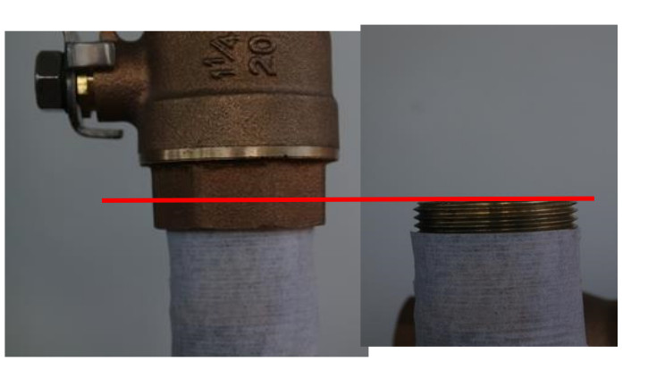

When I purchased the bronze fittings, via mail as nothing like that in town, I had a fiddle with it and found a problem. When I screwed the thru-hull section into the valve, it only went on about four turns. That is not enough to be strong or provide a proper seal. I was shocked!
On the left in the pic is the valve screwed onto the fitting with masking tape on the fitting up to the valve. On the right is with the valve off and just how little thread went into the valve.
I did some more reading. I found that industrial type ball valves typically have NPT (USA) pipe threaded openings which are tapered. I found that the thru-fittings are typically NOT tapered but have parallel thread. They should not be used together as it is not safe.

"Here is a through-hull fitting attached to an inline ball valve—two components that were never designed to be attached to each other. They do not constitute a proper seacock, and are not compliant with ABYC standards. Because the ball valve’s threads are tapered, and the through-hull’s are straight, they do not properly interface, and make a weak joint at best. Moreover, seacocks are typically flanged to provide adequate load distribution, and on FRP vessels, they often rest on encapsulated marine plywood, GPO 3, or some other suitable composite material backing block."
I contacted the chandlery I had purchased the fittings from, they seemed to think there was a problem with the threads but the threads did not look damaged. Maybe some tapered thread valves had got into the batch of what should be parallel thread valves?
For more on the issue of thread differences, see: http://www.pbase.com/mainecruising/seacock_primer&page=2
So, I returned the valves, got my money back except for my postage, and ordered a Marelon valve from somewhere else.
