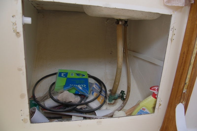

The third valve was under the sink. With its handle I could not tell by just looking if it was open or closed. The wood bases of the valves were rotting away which didn't give me confidence. And the sink valve was in a place that kept getting in the way of nearly everything I was trying to store under the sink.
Suspect valve with rotting timber base

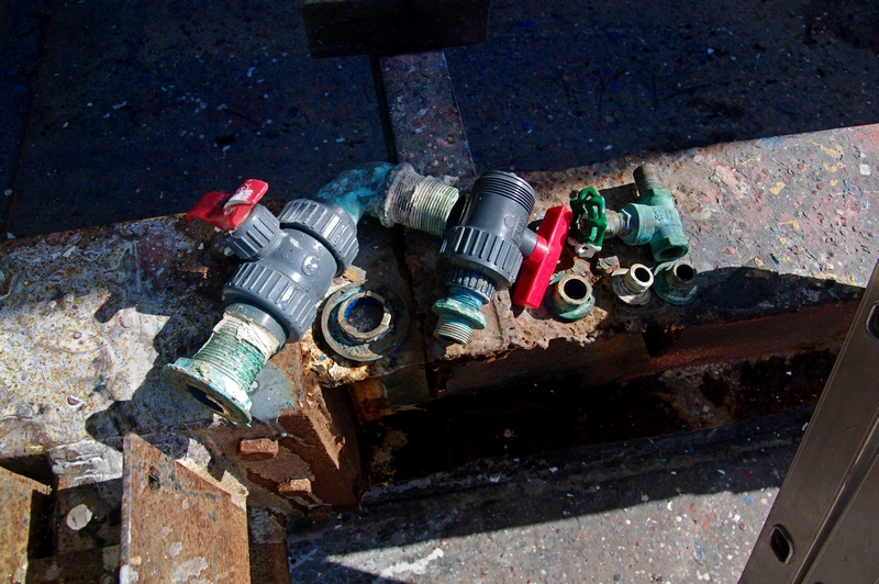

Taking the valves out was easy enough. Couldn't unscrew them so used a multitool to cut through the wood base and through the pipe.
3 valves cut off using multitool

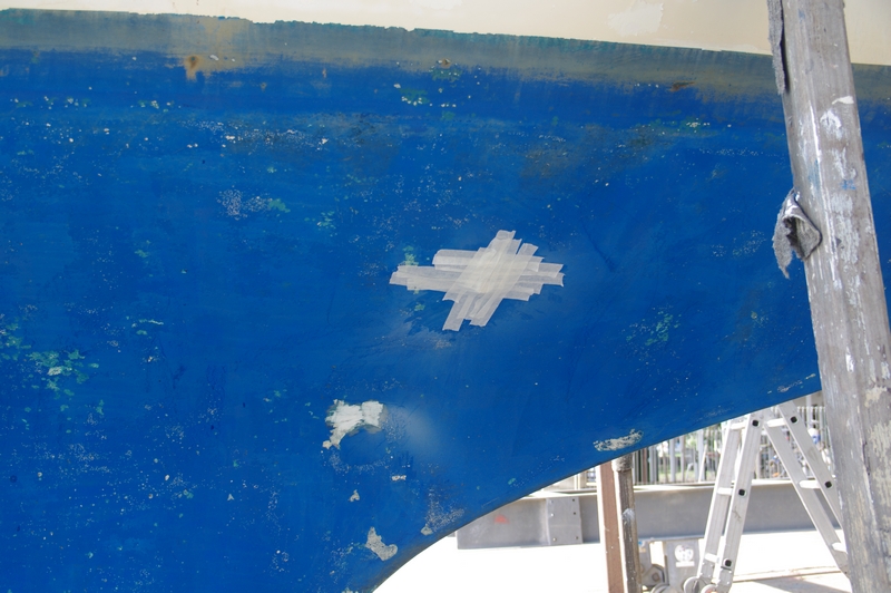

Used a grinder on the inside to make the large recessed area, cut a heap of different sized fibreglass circles (okay, most of them were more square than round), stuck plastic on the outside and put the wetted cloth on the inside. To wet the cloth I put about half the thickness of circles in an icecream container and poured the epoxy onto it. That was easier for me to make sure it was thoroughly wetted than other times when I lay the cloth down dry then wet it.
Tape over plastic over hole
thru hull repair.jpg (367.51 KiB) Viewed 7479 times

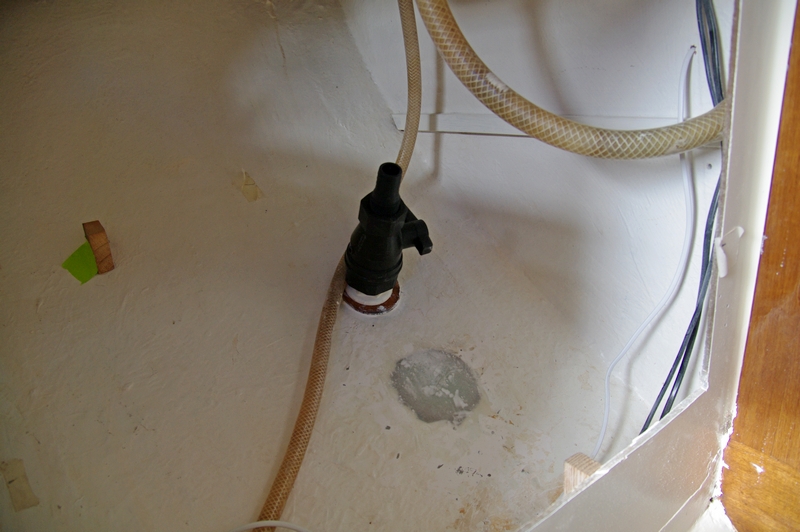

After it was dry I sanded flat. Under the sink I cut a new hole and installed the new valve.
New valve under sink, old hole repaired

Why didnt you use old holes?

bornfreee wrote:Why didnt you use old holes?
Too small for fishing through.
The old under-the-sink hole was close to the front of the cupboard meaning I had trouble trying to use the space in the cup effectively. By moving it back 30 cm it makes it way more usable and for me it was worth the extra work.
