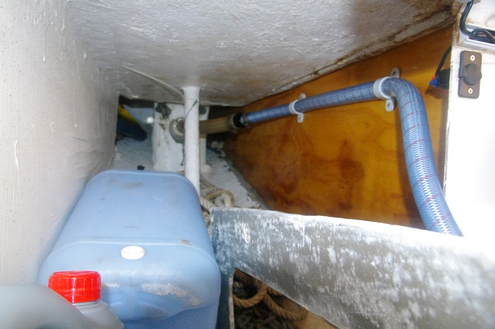

Here's a pic under my cockpit. Never had an inboard motor, so I believe.
s boat trip 420.jpg (273.33 KiB) Viewed 3207 times
Ya can't see the floor with the water container and spare anchor but it is flat all the way down from stern.
All this space is one reason I have decided I like the outboard : ).
Oh, the vertical board on the left side of the pic has been glassed in but is very thin and flexible, probably only to stop stuff (or a person sleeping) from falling off the quarter berth tunnel. It would not be structural.
