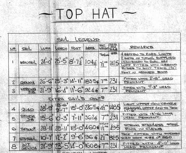

I think this has been discussed before, but could not locate any info. What is the best size for a storm jib? Either lufff, leech, foot dimensions or area. If I am going to buy new, I may as well get the optimum size. Local lofts give varying sizes.
Cheers, John

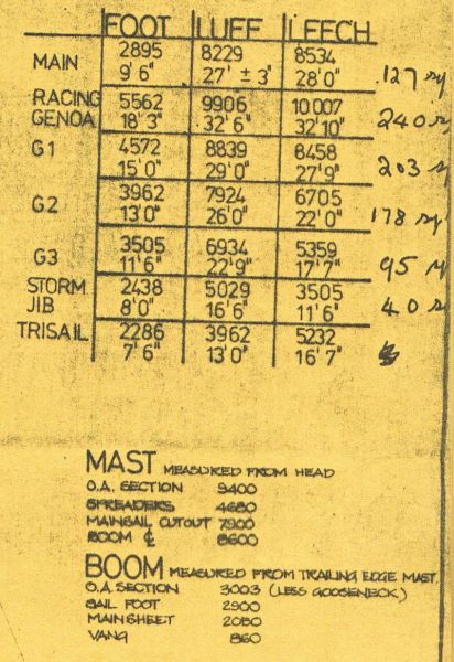

The Storm Jib for a Top Hat is;
Foot 2348mm (8ft)
Luff 5029 (16'6")
Leech 3505 (11' 6")
Area is 4.0 sqm.

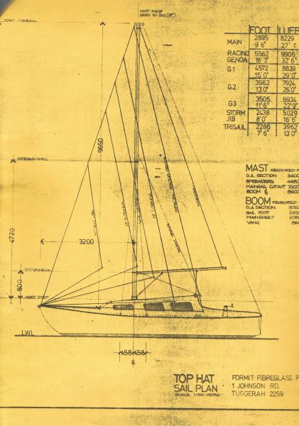

Re: storm jib
Postby Dolphin » Sat Feb 02, 2013 10:21 am
That's why Mk 3s are the fastest !!!
Sail Plan MK3 a.jpg (49.5 KiB) Viewed 9596 times
Dimensions
Sail dimensions a.jpg (65.51 KiB) Viewed 9596 times

The Mk3 version works very well as drawn I find.

There seem to be 2 size storm jibs that will be suitable for a TH. one is about 48 sq ft (4.5m2) and the smaller one is about 32 sq feet (3m2). I think I will get the larger size. Tried Asian and Aussie and USA sail makers, prices are a bit step, some as high as $500. Thought I had hit the jackpot with one American company, but as I was about to place order, discovered they are shonks (never despatch sail).
So still looking for new or used. Any comments about 4.5 vs 3 metre square.

Re: storm jib
Postby Tales » Fri Feb 08, 2013 9:51 pm
The smaller storm jib is for the original Top Hat (wooden boat) which has a shorter mast and less ballast.
The larger one is for the Mk 11 and Mk111 boats with taller rig and more ballast.
