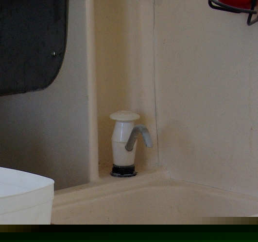

Wanting to replace the old Trojan handpump and thinking about options.
A Fynspray Rocker Pump WS63 seems robust but I don't know if it will work properly in the space. The original space has the tap recessed in its own little alcove.
The Rocker Pump body should fit but I'm unsure if operating the lever is awkward. Anyone installed one?

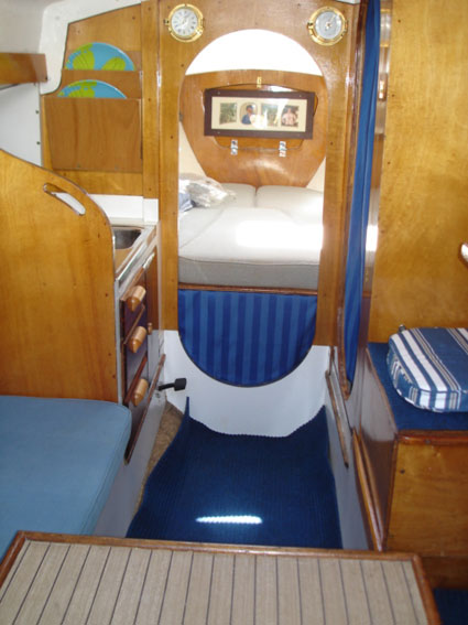

I got a "Galley Foot Pump" [whitworths page 55 item 68155] which I have found to be excellant.

Ahhh the advantages of a Mk 1.
You have a Mk 3 which means the floor is a lot lower than the Mk 1,
that is to accommodate the lower cabin roof, yet maintain the cabin headroom.
[See my earlier post on the floor measurements for each Mark.]
You will have to mount the pump inside your galley locker as low as the curve of the hull will allow.
You will need at least 100mm [4"] of horizontal distance behind your locker wall to fit the pump in at the lowest point.
Seaka's cabin with water foot pump, port side.

On Night Cap we have the foot pump on the left hand side as one faces the sink (that is to the left of the doors of the undersink cabinet, located in the locker under the port berth). It was like this when we got the boat and thought the 'pedal' would be in way, but have never found it to be a problem. Works a treat and is easy to use. Someone who is short might find it difficult in a mark3, because the 'pedal' is high off the floor (gotto lift your foot a ways). It does give spurts of water, rather than continuous flow. In some ways pressurised system with a tap that can be opened as much or as little as one desires might be an advantage. Suggest you check out Bunnings for hose, if you need any (there is special hose to use). Whitworths/Bias when I last looked sold only rolls and Bunnings sold rolls and by the meter. I will replace the hose on our boat when time allows.
