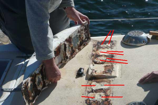

I'll pick "D" Eddie, 12.
I don't know if they are all the same. I have 6 either side.
Hope you can see the holes in the photo.
They were tapped 1/4 whitworth.

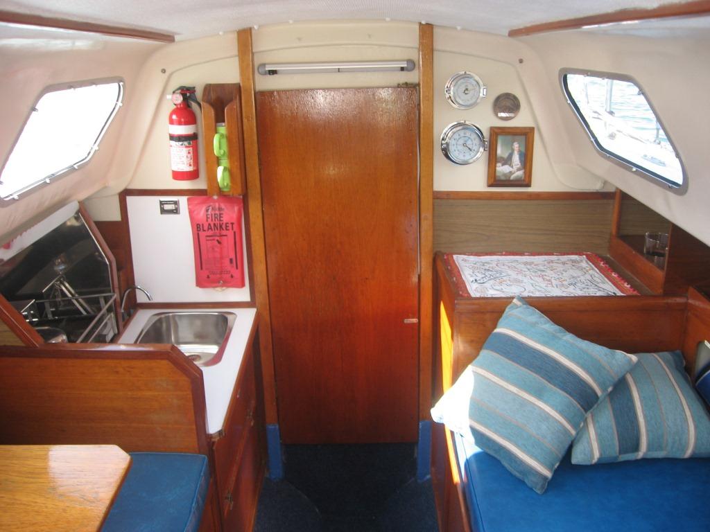

Postby storm petrel » Mon Sep 10, 2012 6:25 pm
Yes all the nuts and bolts are visible inside the cabin of Storm Petrel. You can see them near the main bulkhead in the attached photograph. The others are on the other (V-birth) side of the bulkhead.

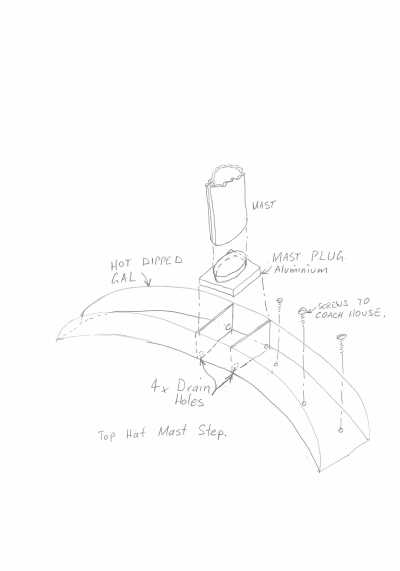

I did a drawing a long time ago in another post and I can't find the post now but here is the drawing.
Under the mast plug there is usually a piece of 3mm rubber.
The mast step on Felicite had been filled with araldite by a previous owner, not a good idea. There are only 2 drain holes not 4. I drew it from memory and before I last removed the mast.
I hope it helps.
