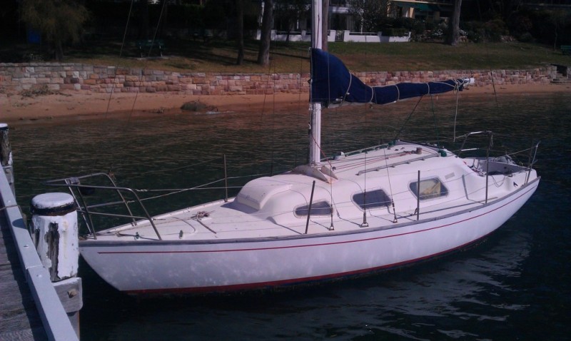

Postby Jeremy » Thu Sep 06, 2012 2:00 pm
Photos work!
Ian, I'm sure all will be fine, what I was trying to say is that only plate sized osmosis worries me.
2012-08-27 12.58.04.jpg (139.48 KiB) Viewed 7576 times
2012-08-27 12.15.20.jpg (29.21 KiB) Viewed 7576 times
Jeremy

Postby storm petrel » Fri Sep 07, 2012 4:06 pm
She looks beaut! ( Mind you, I am a little biased about the clean lines of the Mk11). Great to see her in loving hands again.
Hope to catch up on the water some time.
Storm Petrel (Mk11)
