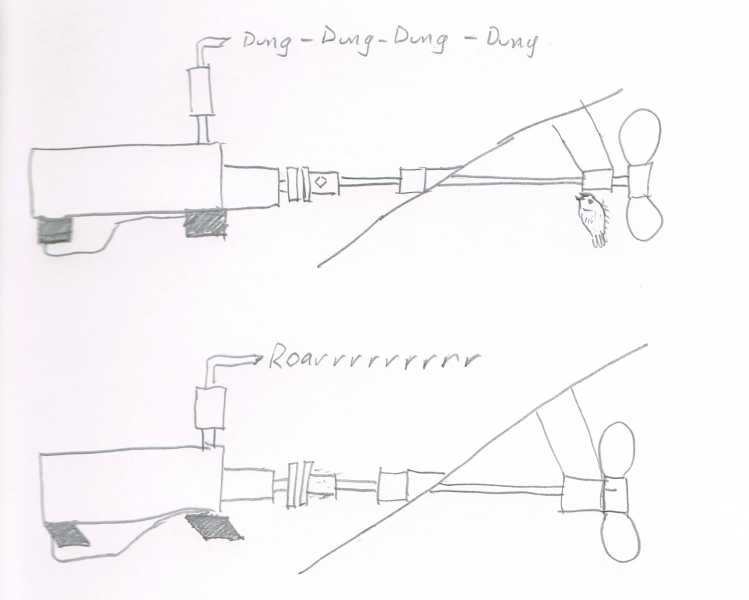

I would make an uneducated guess that the prop is hitting on the rear of the cutlass bearing housing.
All the thrust that the prop gives you is taken on the shaft, through the gearbox to a thrust bearing, into the engine block and through the engine mounts. If you remove the engine mounts and reved the engine the boat would stand still and the engine would proceed through the cabin. The engine mounts being rubber will flex enough for the prop to hit the cutlass bearing.
How much clearance have you got between the prop and the cutlass bearing? Is that what you are asking? You may be able to pinch a bit if you release the shaft coupling inside the boat and slide the propshaft backwards a few millimeters and see if it still does it at 2200 rpm. Check the movement in the engine mounts.

Tom this might help.

Greg, that diagram is a beauty! Very interesting.

Postby Dolphin » Sun Aug 26, 2012 6:03 pm

Did that help? You should see the area where the cutlass bearing has been hit by the prop. But I guess the water is a bit cold to just drop over the side! You could try and measure the deflection in the mounts under load and no load and measure the clearance from the prop to the bearing to confirm the interference.

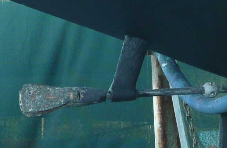

Postby Dolphin » Sun Aug 26, 2012 8:26 pm
Here is Felicite's prop before antifouling showing the clearance which is less than an inch.
